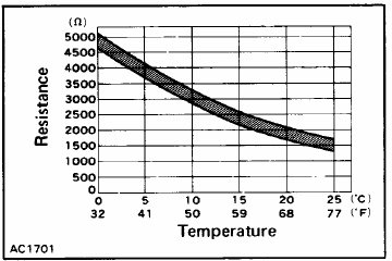

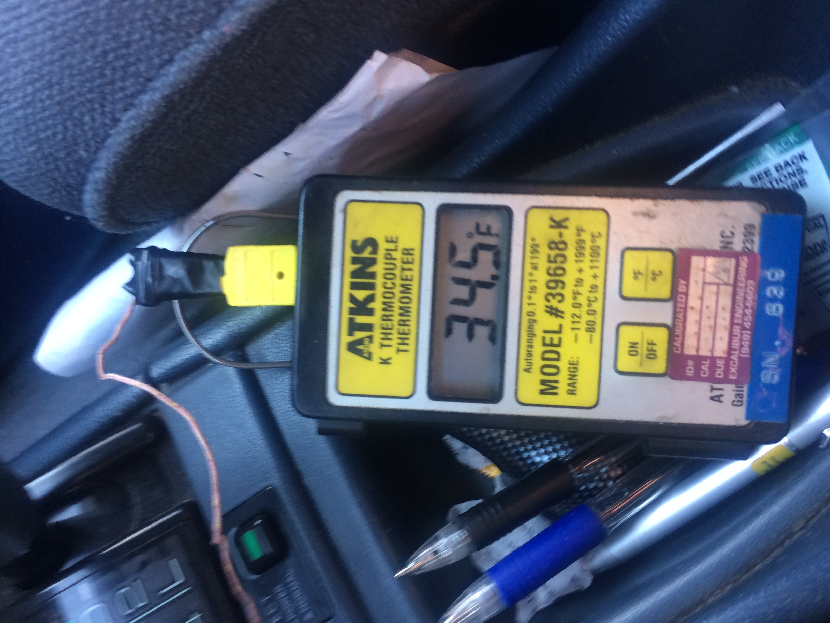

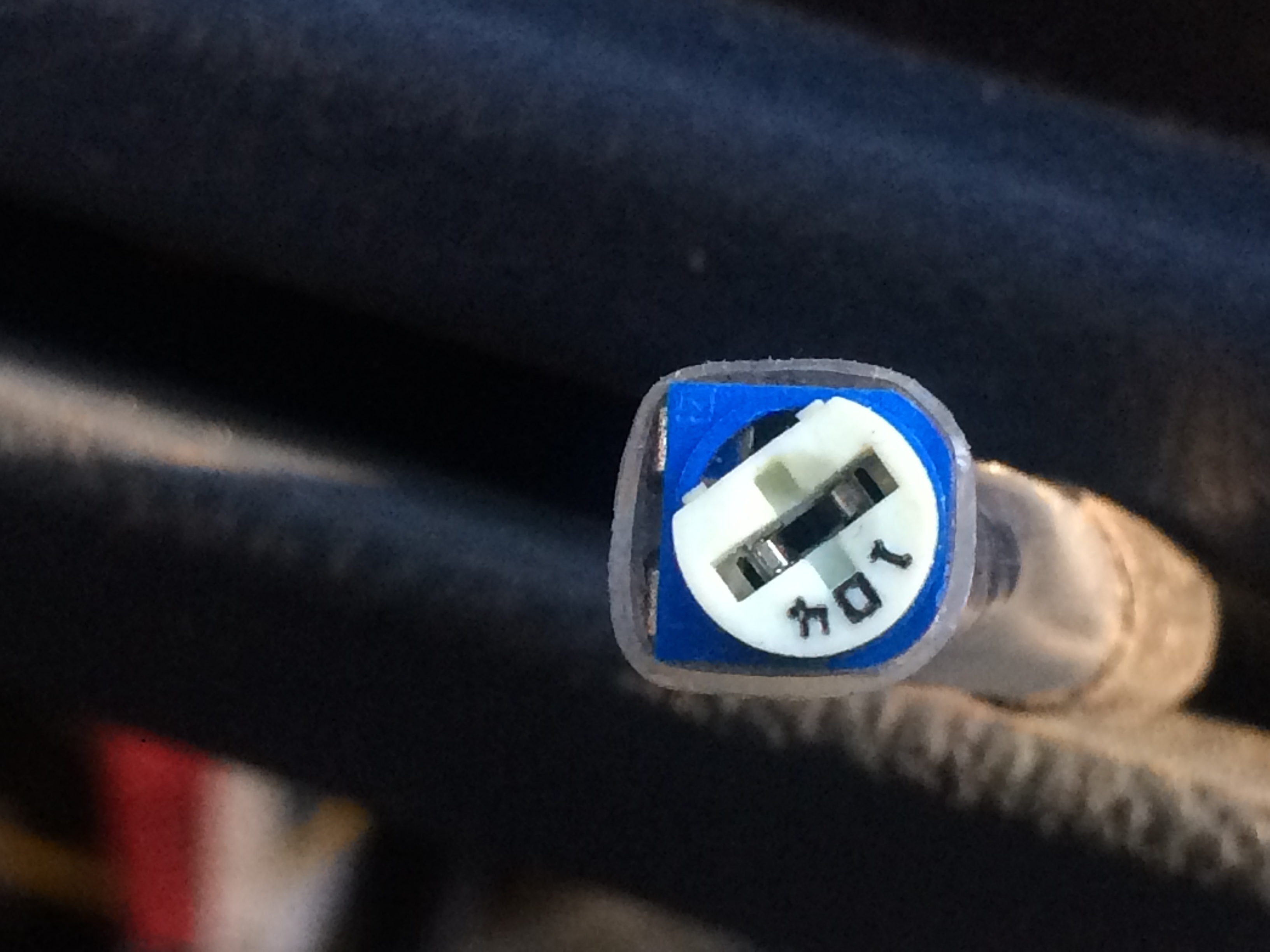

And as an addendum to my earlier posting in this thread, I was not happy with the temperatures I was seeing out of the center vent. Never got colder than 50 degrees. That just aint gonna cut it. Because I implemented the use of the later model 4Runner A/C amplifier board it as designed, IMHO, to err on the high side temperature-wise. This, I am sure, was built in to the calculation to cycle the compressor more often and, at a higher temperature away from 32 degrees, to keep the evaporator from freezing up. also, thermistors do drift a bit especially after they age a while so it only made sense that this one was not where it should be. Toyota used a pretty basic NTC thermistor with a fairly close asymptotic curve that would range between 1.5K and 5K Ohms. 5K being ~32f and 1.5K ~77f. So, in order to close it in a bit tighter to the freezing point I decided to "fool" the amplifier by giving it a different reading than that which was being sent from the thermistor. Basic electronics states that in order to DECREASE resistance to a given number you need to apply another resistance in PARALLEL within that juncture. So, I grabbed a single turn, 100K pot from my junk drawer and just piggybacked the thermistor. I started driving down the highway after the system was stabilized and started tweaking the pot by increasing the resistance thusly noticing the vent temps coming down immediately.
Taking in consideration the thermal loss between the cooling unit and the center vent it should have been in the neighborhood of 3-4 degrees. I stopped when I got the vent cycling between 34.5 to 41 degrees. Since I live in a very dry climate I am not too concerned with evaporator icing so this is a good reading to maintain. The system will not cycle nearly as much as it did prior so that is a benefit.And if I am traveling somewhere more humid, and it starts to exhibit freeze over than I can dial it back a tad as I have the pot poking through a hole inside my glovebox.
Summer is almost here and now I can enjoy it better.
Hope this helps others..

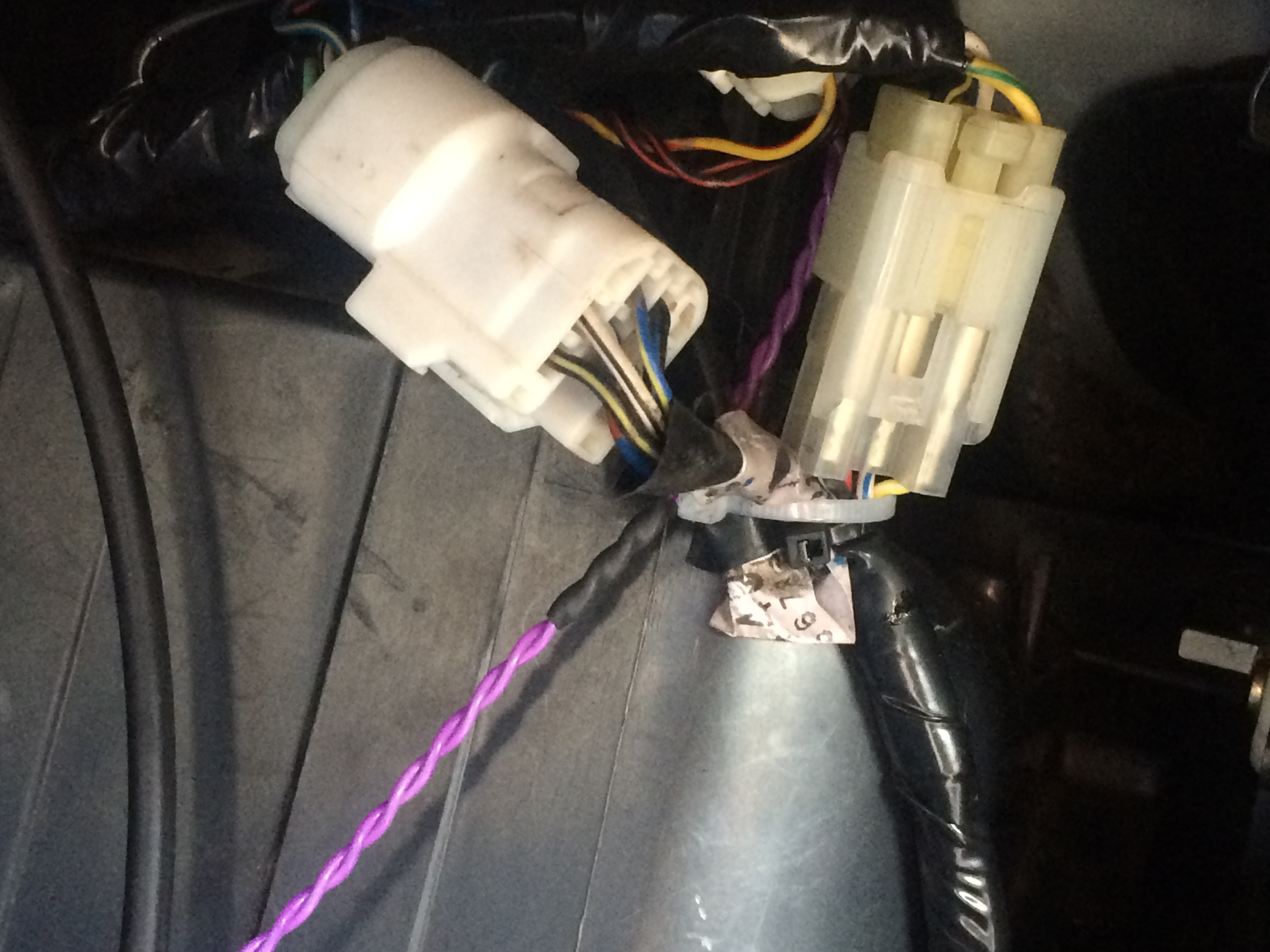

I'm helping a friend swap a 3.4 from a 1995-96 T-100 SR5 4x4 5 speed to his 1993 T-100 DX 4x4 5 speed. The newer powertrain and wiring harness had already been swapped in another 1993 T-100 SR5 5 speed which my friend bought complete for the swap. That one lacked a/c but the DX that's getting the new motor does have it. It's an early 1993 but but it came with R-134 from the factory unlike my 1993 pickup that's a few months newer but still had R-12. I've read that there were some wiring differences between R-12 and R-134 systems in compact pickups but I guess it's not the case for this one since it never had R-12 in!
We swapped the whole wiring harness which came from the 1995-96 with the OBD2 connector.
We managed to replace the compressor and I did replace the dryer, vacuumed and recharged the system but the compressor still won't get power when I turn on the switch on. The black and white wire that energizes the a/c clutch has continuity from the 10 wire connector of the new harness that connects to the evaporator box to the compressor plug but I noticed that the newer harness has less wires than the original. I did check the continuity for the low/high pressure cutoff switch on the evaporator box and it does have enough charge to start the system so I think there must be something that changed and that the A/C amplifier must need to be wired differently or replaced.
I'd like some advice on that.
here are a few pictures of the old connector on the 1993 wiring harness and the new one with less wires on the 1995-96 (I don't know which year but the computer's number seems to match the 1995-96 models). If I understood correctly, there might have been a new A/C amplifier used in 1996.
Here's the plug from the 1993 T-100 harness I removed. Just the two pins on the right have no wires in.
this is the newer plug 1995 or 1996 T-100 that was unused in the previous installation on a non-a/c 1993 T-100. Wires are on different locations and just 6 wires instead of 8.
Of course there was no a/c amplifier to match with this connector in the no a/c T-100 and I can't find the wiring information for the 1995 version.
Any help would be appreciated, I've read a lot of stuff but I'm getting confused now! And not a lot of information on the T-100 vs 4Runners or compact trucks from the same period.
