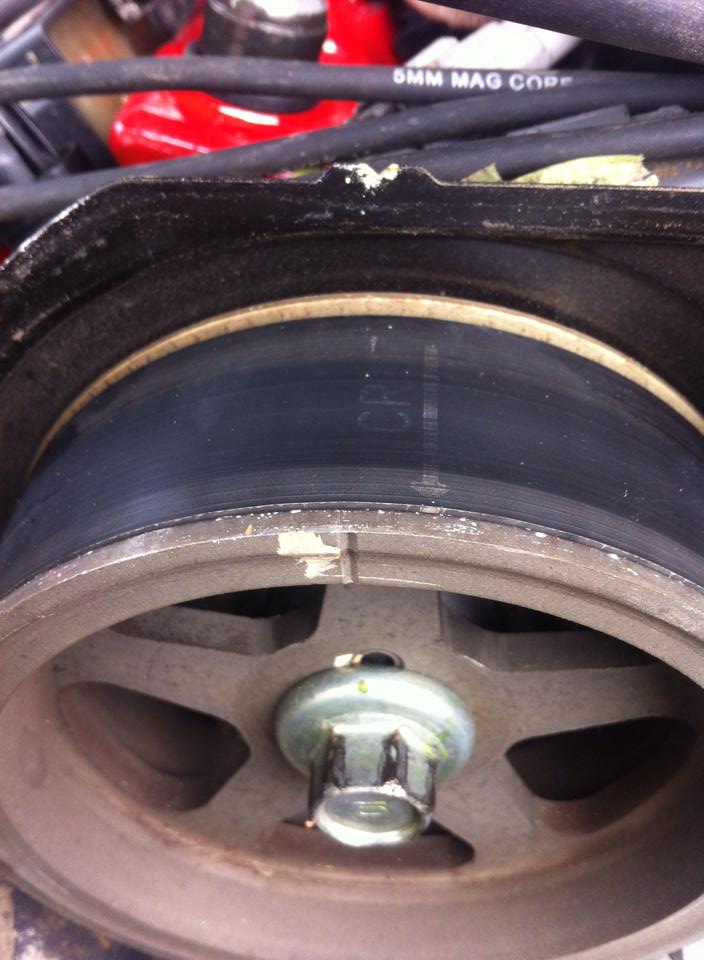

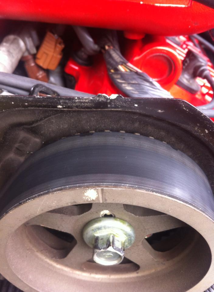

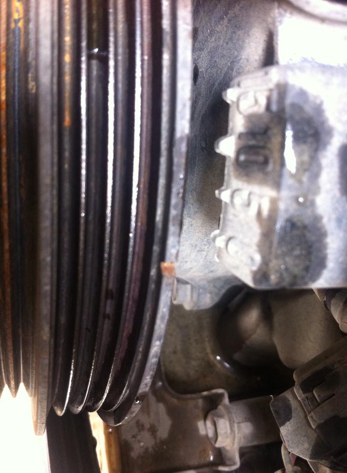

jumped timing belt?
Originally Posted by vital22re
the p0130 and p0133 go hand in hand. You need to verify the wiring to the primary 02 isn't damaged. And you need to make sure you have no exhuast leaks above that o2.
Already checked the wiring several times, is there a way to check the voltage coming from the ecu?
Just checked timing belt and the bearing has been making some grinding noise never knew where it came from.
Cams line up pretty close but the crank pulley is off almost 5 degrees took some pics.
Also if you look down inside the lower cover there was rubber marks on the pulley like skid marks? no pics of that dunno why lol
would this cause it to run lean?
Coolant MAY have gotten on the belt at one point or another.....

pics!

looks like your crank timing/phasing could be slightly off, maybe a tooth or two

Yep this was the last straw for me, already ordered a timing belt kit OEM no aftermarket cr@p for this 4runner!

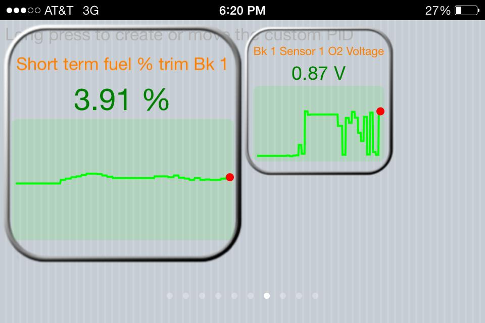

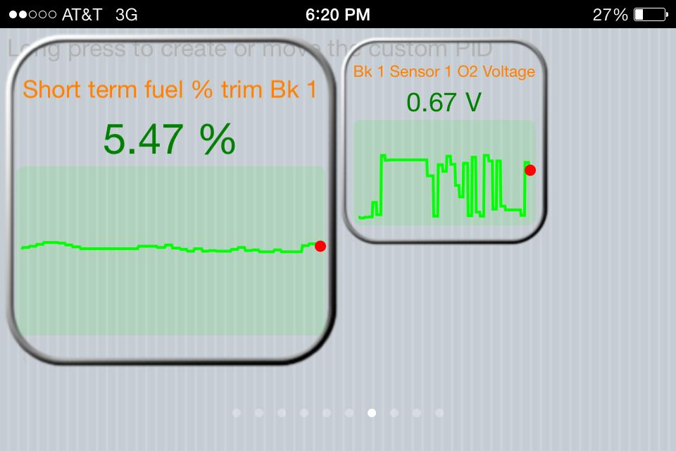

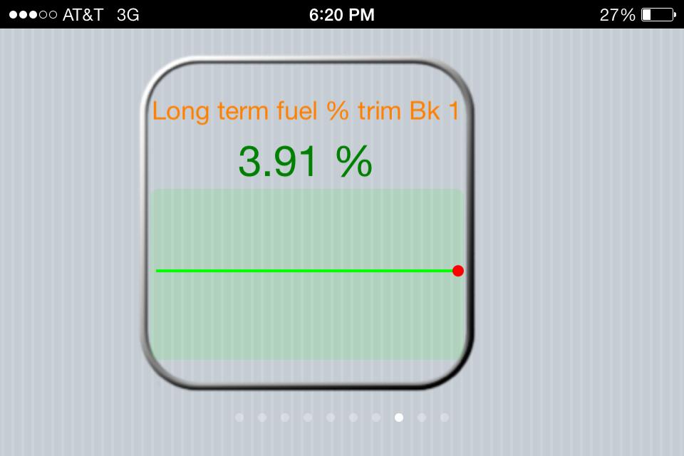

Just replaced the intake mani gaskets the top 2 only never needed the lower injector mani gasket.
Still the same fuel trims, i created a vac leak at the brake booster and my fuel trims came way down and the voltage started moving around it was a little off but long term came down to 3.3 also reset the ecu this time also runs much better besides a slight lope no more pops out the intake when given gas.
i'm guessing this is a fuel problem? thought the fuel pressure regulators rarely go bad... new fuel pump also idk also a vac leak anywhere else on the top plenum would kill it.
Anything other then the regulator that would control the fuel pressure?
almost seem like its the injectors...
When took them out and the driver side far back injector looked a little melted but when i hooked it up to a battery and injector cleaner it didn't leak and did really well, it was under pressure also.

Ended up running the fpr vacuum line to the vac port for the starting solenoid (by the TPS) upped the idle to 1000 with an idle screw and fuel trims are looking normal.
Short term is still +3 - +7 i know thats not where they belong so ill be reading the spark plugs to see if one of the injectors are leaking mpg are a little better i think not positive.
