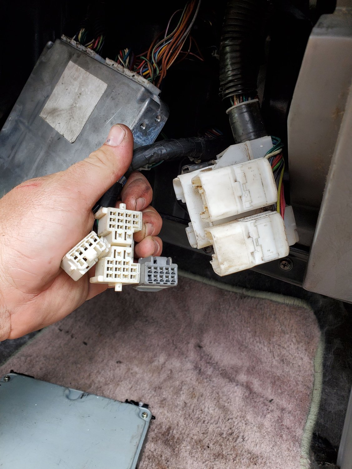

So i have a 03 tacoma auto 4wd 5vz
have had nothing but problems with the throttle body and harness breaks.. SOO scored a harness, ecu, lower and upper intake with throttle body from a 2000 auto 4wd 5vz tacoma so we can go back in time a bit where things actually worked.. but i have come to a cross road.. i have 3 plugs that dont plug in and i believe this is were my problem is being i do not have spark.. im guessing i need to repin these? some direction on this would be great for all you guys that do swaps.. Thank you
Ive done my fair share of searching prettty much all the forums for pin outs but im not having the best luck.. everything is from going 3.0-3.4 not just a harness swap for 3.4 to 3.4

What you're holding here is the body or.engine harnessb(yep to lazy to look since its past bed time), pay for the daily pass for the alldata access, download all the diagrams for your body and engine model year and start matching up signals to pins or pay for a conversion harness from someplacelike ORs (off road solutions)..

i would think its still part of the engine harness. being it came from the engine harness lol but does ORs make conversion harness that they dont sell? if i email or call them with the pin outs will they make it?
