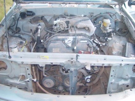

Today's fun included removing the bumper, grille and lights to gain better access, and avoid banging them up during the project.
Then I turned my attention to the great fun of removing the plenum, so that I could get at the rest of the wiring harness. I thought I had all the connections removed to pull it off - riiiiight! I missed the back passenger side vacuum hose that goes up under the plenum. I just had the best time trying to get a pair of pliers onto the hose clamp for that turkey! (s)
After I got the plenum off, I pulled the rest of the wiring harness connectors, and then pulled the harness clear to the firewall, except for the stuff going down to the starter.

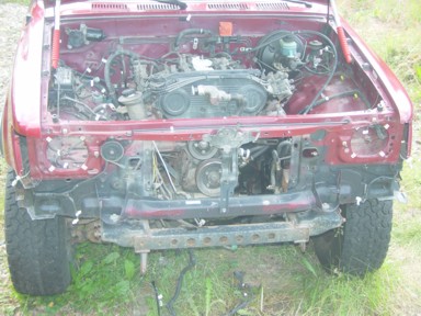

I've had a heck of a time since my last report. I got held up by not having enough stuff to crack the driveshaft bolts loose, and then the rain moved in for a few days. The break did give me the chace to visit my Dad, do a few chores for him, and raid the tools for more stuff to do this job with (icluding the air tools!)
I also had the great fun of a Murphy's Law transfer of money, so I had to delay going to ORS to pay for my conversion kit and crossover pipe.
I finally got that squared away, and got Mike the money, and gave him the info about the two trucks, so that he can start to work on the harness.
After my discussions with Mike, I have shifted to working on the Taco, because he will need the flanges from the crossover, and the body harness plugs for the ECU. So I worked in between the rain showers today to start removing the engine from the Taco. Im planning to pull it out with the engine harness still attached to it (and disconected everywhere else). I got most of the stuff off of the fender wells, and disconnected the fuel lines, vacuum hoses, throttle cable, ect.
I also drained the engine oil, and will drain the coolant as soon as I get another bucket for it. I transferred the front engine hook from the '90 to the Taco, since it did not have one. I'm wondering if the previous owner took it off when he put in the K&N (or if it even had one at all).
I'm hoping to get underneath tomorrow, to remove the rest of the stuff (weather permitting - and it's not looking good!).

Mt. Goat - Too late on the snow, had some this morning. I'm hoping that I can beat the stuff sticking, though (praying for a good Indian Summer!!)
Mike told me that they are having trouble sourcing the body harness plugs for the '02s, so he'll need mine.
I just have the front hook on the back bolt of the power steering bracket. I think I may end up adding it permanently, so I'll probably re-drill it to fit. The one bolt should do, to get the engine to the stand.
I should be back at it on Monday!

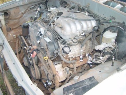

Since my Taco came with the K&N kit, I don't have to worry about the silencer. One small inconvenience avoided.

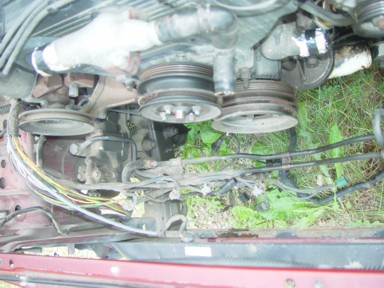

I drained the coolant, and removed the radiator hoses. Removed the fan shroud, and thought I was going to have to take the fan and clutch out at the same time, then I saw the clips to the bottom filler piece on the shroud. Took the shroud out, then ditched the fan and fan clutch. As much as I'd like to do the Volvo fan mod, I think I'll be re-using the Taco fan clutch, at least until next summer.
I removed the A/C condensor, evac can and front tubing. I had a mobile service come by to evacuate the system the other day, BTW.

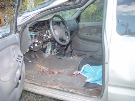

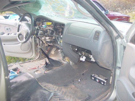

Then I decided to start going after the ECU. Little did I know about its location! I thought I was going to find it in the passenger side kick panel. At least I know where the cruise control computer is, now! I should have figured that the location of the ECU had changed, when I saw where the wires were coming out of the firewall.
So, I ended up taking most of the dash apart - 1, to get to the ECU, and 2, because there's a lot of stuff on the dash that I plan to use on my '90. I got the call that my '02 FSMs have come in (down in Denver). I wish I had them, right now, because the passenger side airbag has me mystified as to how it comes apart. I'd also like to see the write up on how the dash pad comes off, too.
They sure stuffed the wiring to the ECU in tight. I'll try to get the plugs out, and the ECU out tomorrow. Does anyone know if there are any other bolts to contend with on the ECU, besides the two brackets that I can see from the glove box hole?
Hopefully, I'll be getting the ECU out, drain and disconnect the power steering, and getting the rest of the engine harness wiring out from underneath the Taco tomorrow. I'm hoping that I can pull the engine tomorrow, or Wednesday, so that I can get the parts that Mike needs down to him ASAP.

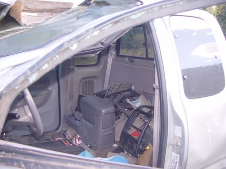

Got a lot done yesterday, but not a lot on the Taco. I did manage to get some more stuff removed, like the heater hoses, power steering hoses, and the cab section of the engine wiring harness. I did get the ECU out, as well. One hassle was discovering another case of a plug or wiring hold down mounted to the top of the transmission. I think it may be the forward O2 sensor plug, but I can't see it, and can barely reach it. I'm still trying to figure out how to get it out (without destroying it), so that I can finish getting the engine harness stuff back to the engine bay.

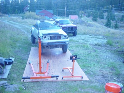

After aggravating myself with that for a while, I decide it was time to do something else. I finally got my plywood delivered, and started working on my work platform. I got 5 sheets of 3/4" CDX, and cut one to make the joining pieces for the other four, to make an 8x16' platform that would allow me to roll the engine hoist an stand around.
With the pieces cut, I used a Flood CWP wood sealer on all of the wood, since I will probably be in need of this thing again, come next spring. I moved the trucks (towed them back a few feet with the Volvo), and assembled the platform with a box full of drywall screws (shortest deck screws were too long).
I finished the day by assembling my hoist and stand.
