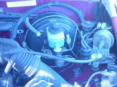

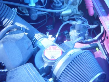

Well, I finally found a donor truck ('02 Taco TRD, 67K miles), and it will be here on Thursday or Friday. So I started dismantling the engine bay of my '90 SR5.
I'm taking the 3.0 apart as though I were going to rebuild it (which I probably will, later), so I'm labeling hoses and connections for future reference, in conjunction with taking lots of pics for my personal documentation. Thank God for digital cameras for things like this!
I spent this afternoon stripping out most of the stuff along both sides of the engine.
Before:
Attached Thumbnails Finally venturing into my 3.4 swap (dial up warning)-worf-3-0-sm1a.jpg   Finally venturing into my 3.4 swap (dial up warning)-worf-3-0-sm2a.jpg   Finally venturing into my 3.4 swap (dial up warning)-worf-3-0-sm5a.jpg

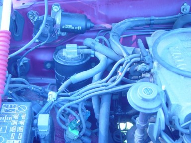

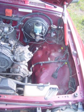

Continued:
Attached Thumbnails Finally venturing into my 3.4 swap (dial up warning)-worf-3-0-sm3a.jpg   Finally venturing into my 3.4 swap (dial up warning)-worf-3-0-sm4a.jpg

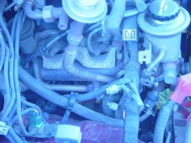

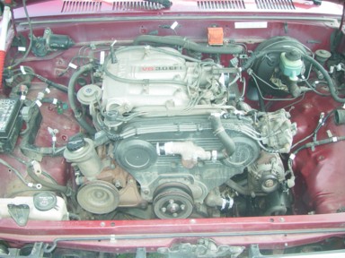

And what I accomplished today:
Attached Thumbnails Finally venturing into my 3.4 swap (dial up warning)-worf-3-0-sm6a.jpg   Finally venturing into my 3.4 swap (dial up warning)-worf-3-0-sm7a.jpg

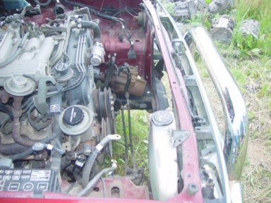

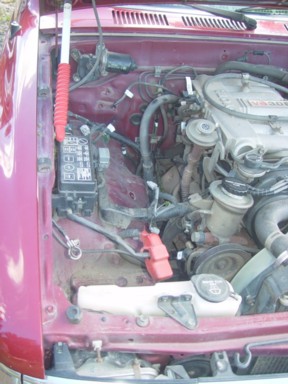

I had business matters to tend to today, so I only got a little bit done. Drained the oil and coolant, removed the fan and radiator, and labeled more of the engine harness. If I end up selling it, I figure that the labels might help someone else out.
As long as I can make some progress when I have the opportunity, I feel pretty good about it!
Attached Thumbnails Finally venturing into my 3.4 swap (dial up warning)-worf-3-0-sm8a.jpg   Finally venturing into my 3.4 swap (dial up warning)-worf-3-0-sm9a.jpg   Finally venturing into my 3.4 swap (dial up warning)-worf-3-0-sm10.jpg

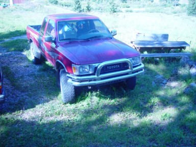

I got nothing done on the truck, today....

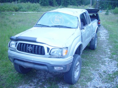

Because the donor truck got delivered!!
I did a walk around, and things looked pretty good. I can definately use the wheels. Just a little cleaning and they be fine, although I'll have to find some center caps and 4 more lug nuts for them. The tires are just about done, though.
I couldn't get under the hood, as the roll over has folded the top edge of the driver's side fender over the top of the hood.
Attached Thumbnails Finally venturing into my 3.4 swap (dial up warning)-taco-3-4-sm1.jpg

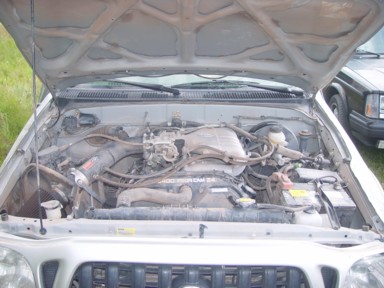

So out came the BFH, a couple of big screwdrivers and a chisel, so that I could bend the fender and hood such that I could open them. There were no undamaged body panels (altough the tailgate is still in good shape, with just a couple of tiny dings), so it wasn't like I had to be careful about getting the hood open!
Bent the edge back - it reminded me of opening a can of spam with a key! Got the hood open, and found a VERY dusty engine. It had obviously been sitting at the salvage lot for quite some time. I hosed the worst of the dirt off the engine, and let it dry. I checked the fluids, and they all looked good.
After it dried, I removed the spark plugs (Lord, was that a lot easier than the 3.0!) Then I jumped it, since the battery was flatlined, and spun the engine on the starter. Everything sounded smooth, so I put the plus back in, double checked the fluids, and tried to start the beast. She fired on the second try, and sounded EXCELLENT!
I checked out everything I could, while I was letting the Taco get up to operating temps for the first time in who knows how long. Lights work, power steering is fine, although the pump seems slightly noisy, to me. Heat could bake you out, and the A/C blows very cold. The only thing that doesn't work is the Pioneer head unit, but it's obvious that a lot of gear was removed (looks like there was an amp under the driver's seat, and a sub in the back.)
I hadn't planned to, but I finally said to hell with it, and took it out for a short spin to the end of my road, and back. It was an interesting contortion to do it, since the driver's roof took the biggest hit in the rollover. All of the gears sounded good, both ranges of 4WD worked fine, and the E-locker seems to function properly.
Anyway, it seems that I have an ideal donor with which to bring my truck back to life!
Attached Thumbnails Finally venturing into my 3.4 swap (dial up warning)-taco-3-4-sm2.jpg
