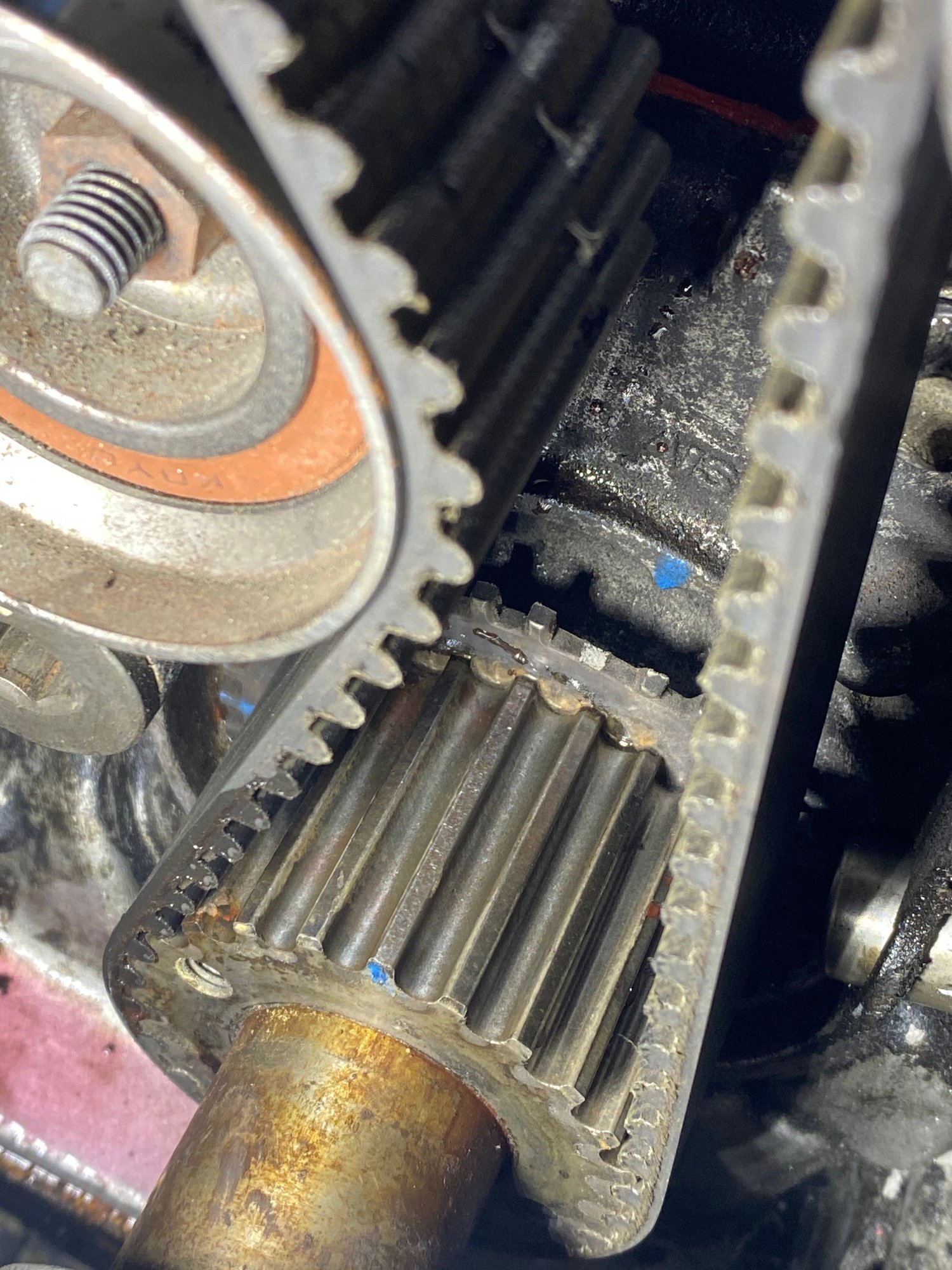

My issue was a broken tooth on the crankshaft timing sprocket.
