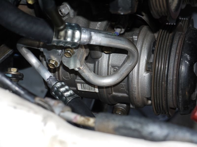

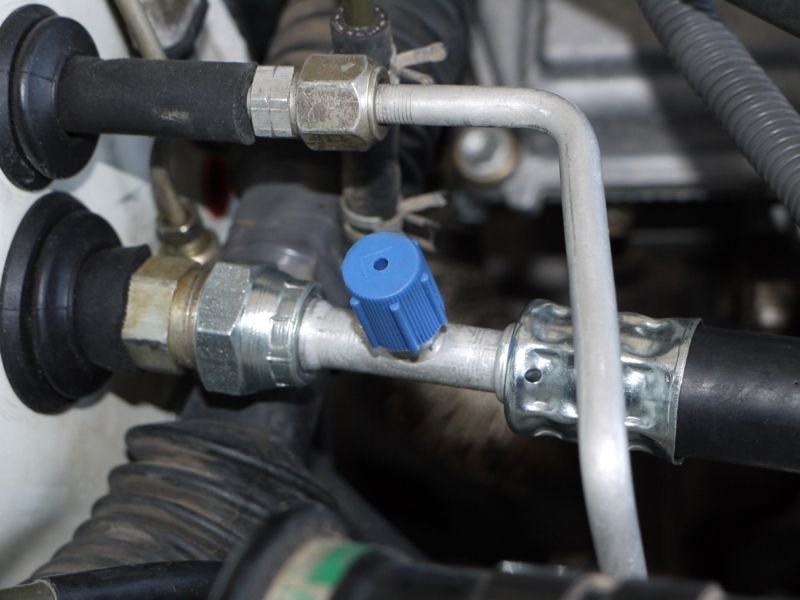

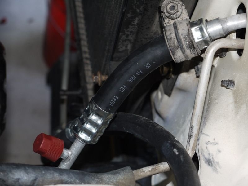

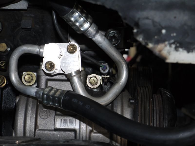

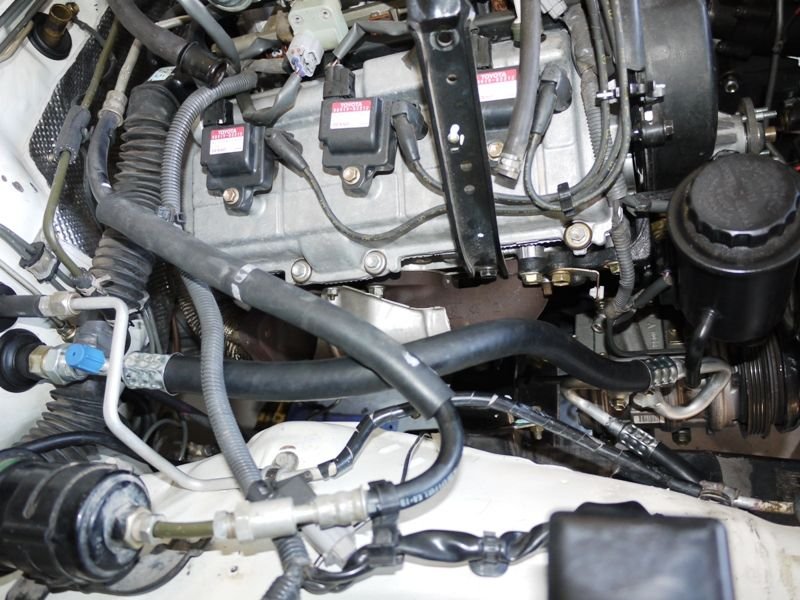

The pics are gone from my old 3.4 swap posts but I found some pics on my computer. I bought some fittings and the hose from a local automotive A/C shop. I cut and fit them to my truck and marked them for any rotational orientation and brought them back to the same shop so they could crimp them. You can see where I had charge ports added to the hoses since the 3.4 compressor didn't have them like the original did.
I bought reusable fittings for my 52 Ford project and just built my own hoses and what I prefer to do now. Avoids paying a shop to make my hoses. You can also buy your own hose crimper on Amazon. Another option.
