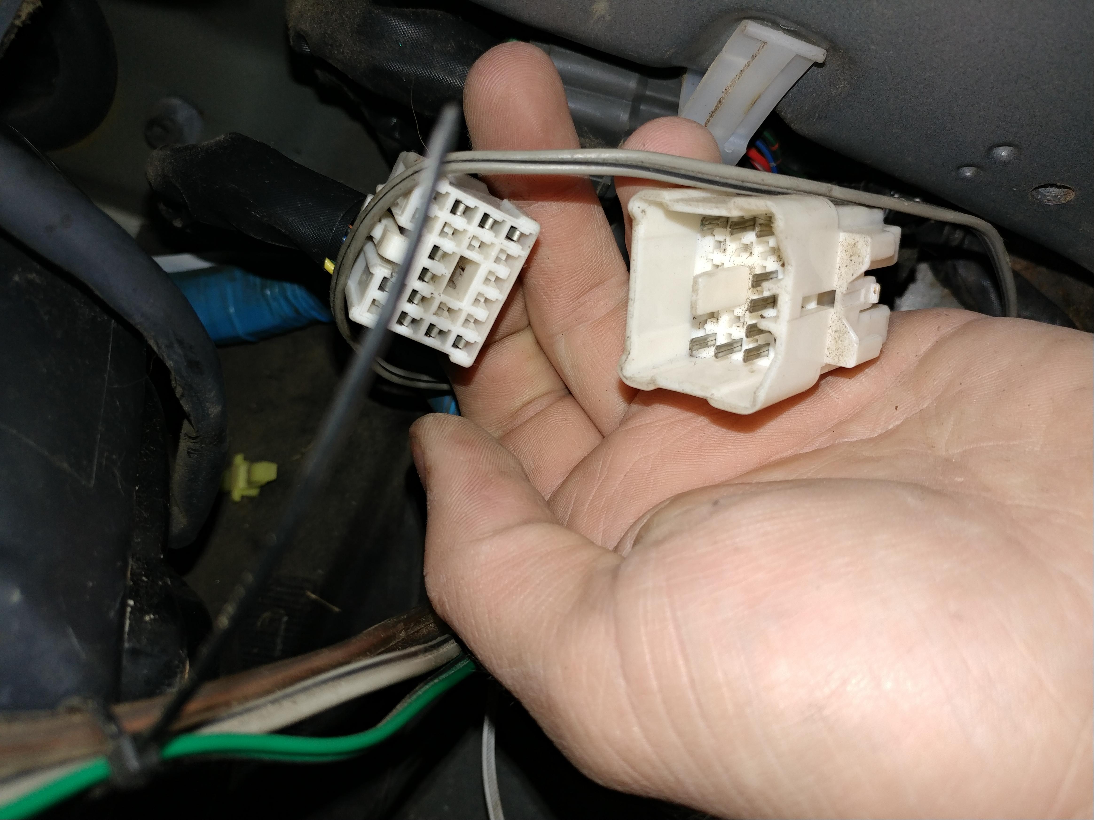

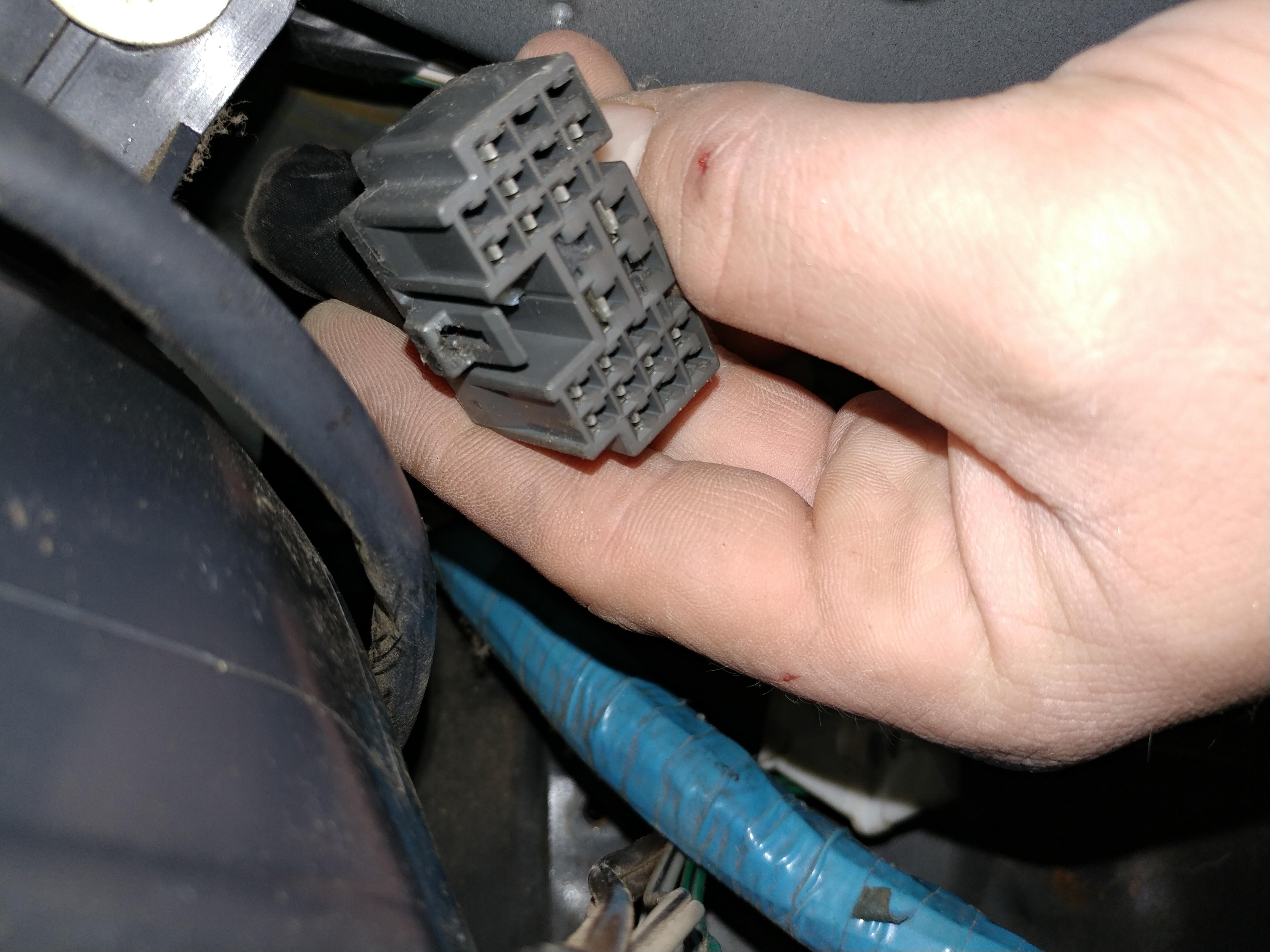

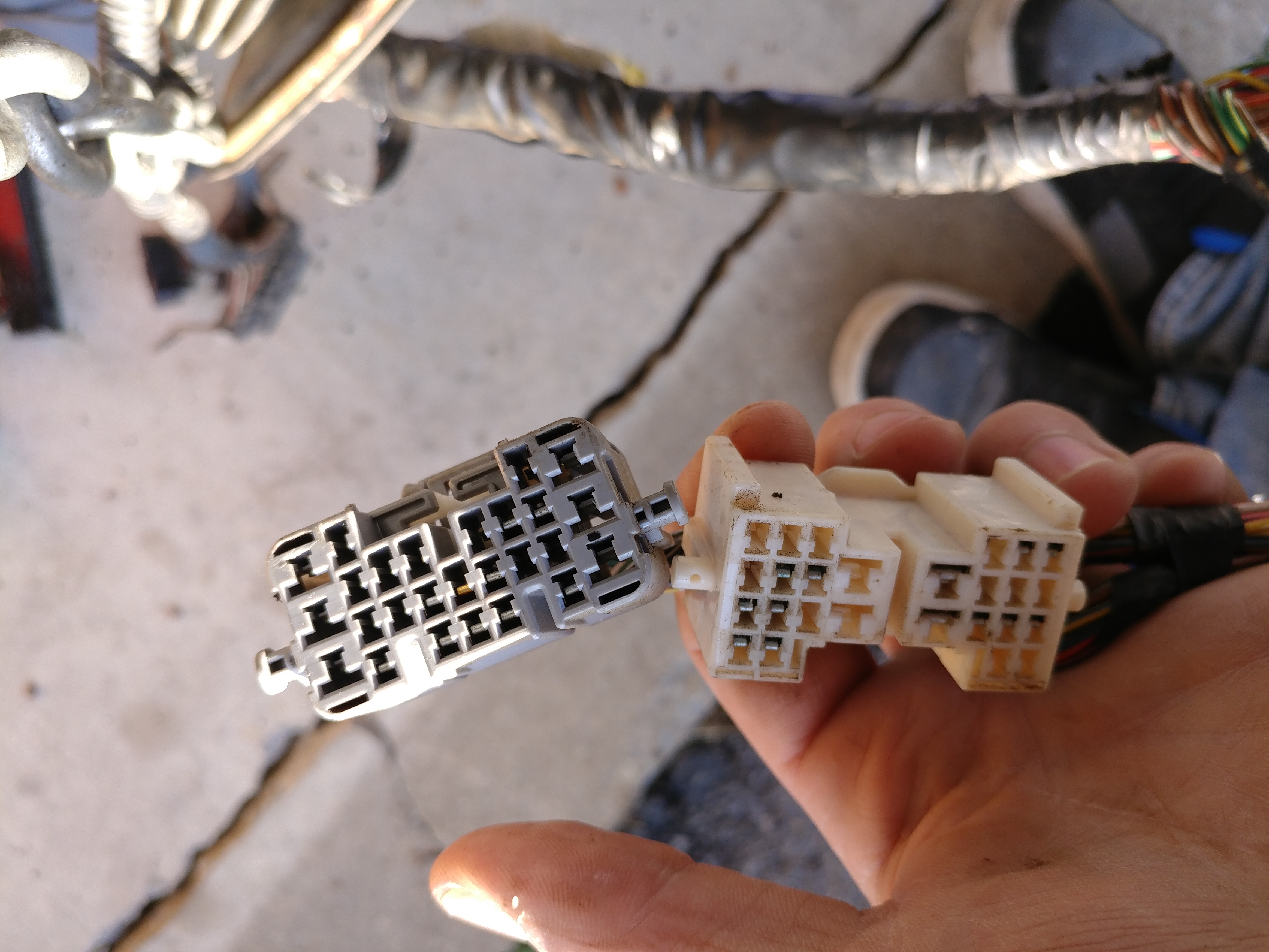

I just wanna say thanks for reading my thread. I have been reading on wiring for the body harness and the problem I'm seeming to have is that others dont seem to have the same 3.4 body harness. I have a 91 toyota 3.0 4x4 manual and i know the motor came out of a 95 3.4 4x4 manual. The guy i got the truck from cant remember if it came out of a t100 or tacoma. I'm thinking tacoma because of the oil pan, dipstick, oil pick up etc. The first two pics are from the 91 and the second is from the 3.4. I cant seem to find the wiring from the 3.4 plugs

Those look to be the "II" plugs. The 3.4 plug on the right (the white one) looks like my II3 plug. The gray one I have no idea because mine is smaller on the 4runner application. Have you been on TIS and pulled multiple years of Tacoma and T100 engine EWDs? Any page with the ECU will have those plugs.

The gray one on the new motor is what i cant seem to fins. I have the wiring diagrams from my truck and a t100 from TIS but i forgot to get it crom the tacoma

Look at the two connectors from the 3.4 engine harness that connect to the body harness, study them, memorize them, get to the point where you can draw the shape of the connector by hand. Now, open your EWD (for both the possible T100 and Tacoma) and navigate to "Power Source" -> "Electrical_Wiring_Routing" -> connecto.pdf and scroll through that document until you find the image of BOTH of those connectors (the white and gray ones), write down the name of the connector (for my 97 4Runner donor, the white one is "II3" [ii3]).
From there, create a spreadsheet with a tab for each of those two connectors, label the first column "Pin Number" and enter 1 - N (how ever many pins there are), next column should be wire color, then the 3rd column "description." Now this is the painful part, open the Overall EWD for the T100, and do a search for that connector number, and for each and every pin that's found, verify that it's appropriate for your application (5VZ and whatever options your donor came equipped with), and write down the wire color specified in the EWD as well as a description of the function of that wire. Now repeat that for the other connector. Now, look at your actual connectors and visually look to see if the wire colors match the spreadsheet you just created. If they match, its a pretty safe bet to say that's a T100, if they don't all match (1 or 2 may not match and it still could be a T100), then you probably have a Tacoma donor. If you think you have a Tacoma donor, start that whole process over with the Tacoma EWD that you will need to download.
