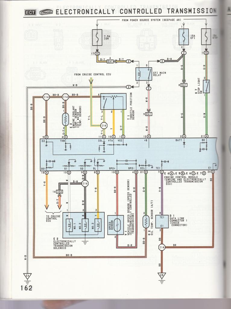

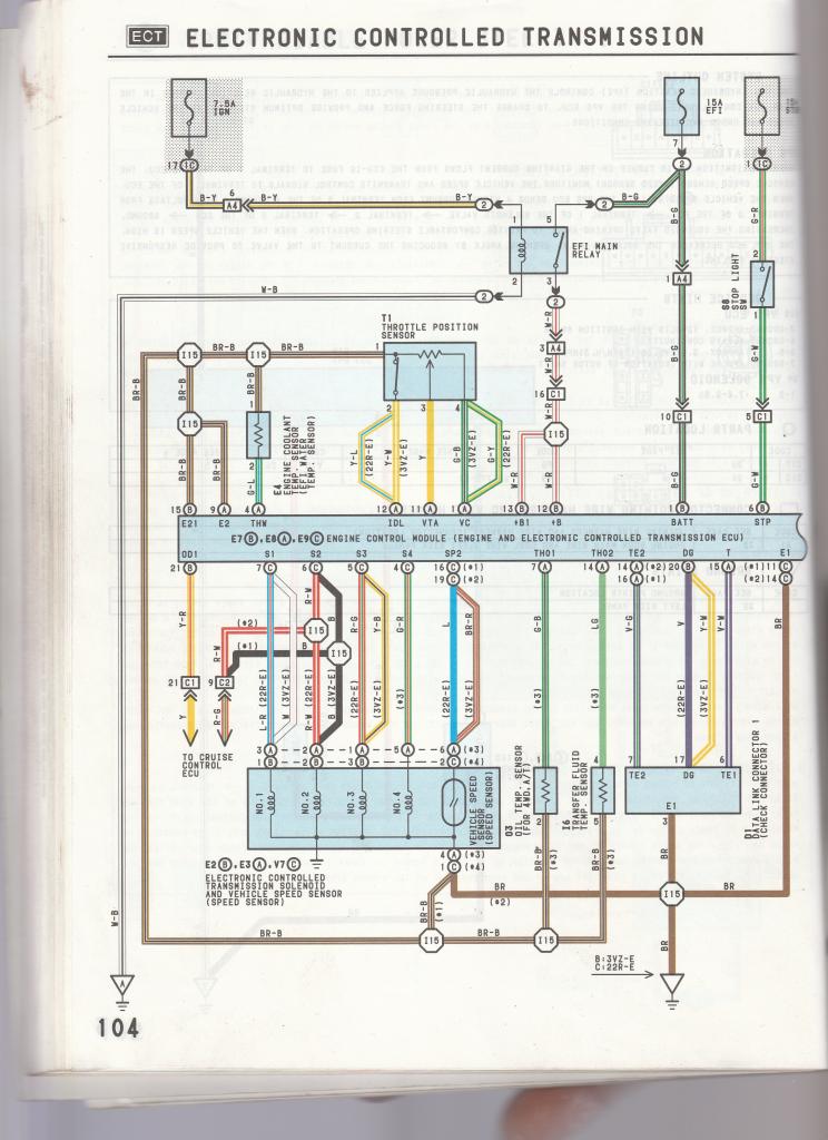

installing a 1995 T100 3.4L auto , into a /94 3.0L auto . truck .
have a question .
the /94 has 4 shift solenoids and theT100 only has 3 . not quite sure how to wire this ? anyone have any ideas ?
/94 EWD ATM tranny
95 T100 EWD tranny

L4. Since the 3.0 auto has the transfer case built into it, there is a seperate solenoid for the Low 4 function. I join the 3.0 autoharness right before the rubber ribbed section at the engine side of the harness.

so this is what # 4 is for ?

Yes, if you go to the system outline for the ECT EWD it offers an explanation. I rig up a relay to send power to the solenoid when L4 is selected. Keep in mind to explain to customer that he needs to follow the L4 shifting instructions as you bypass the ecu deciding when its safe to shift into L4.
