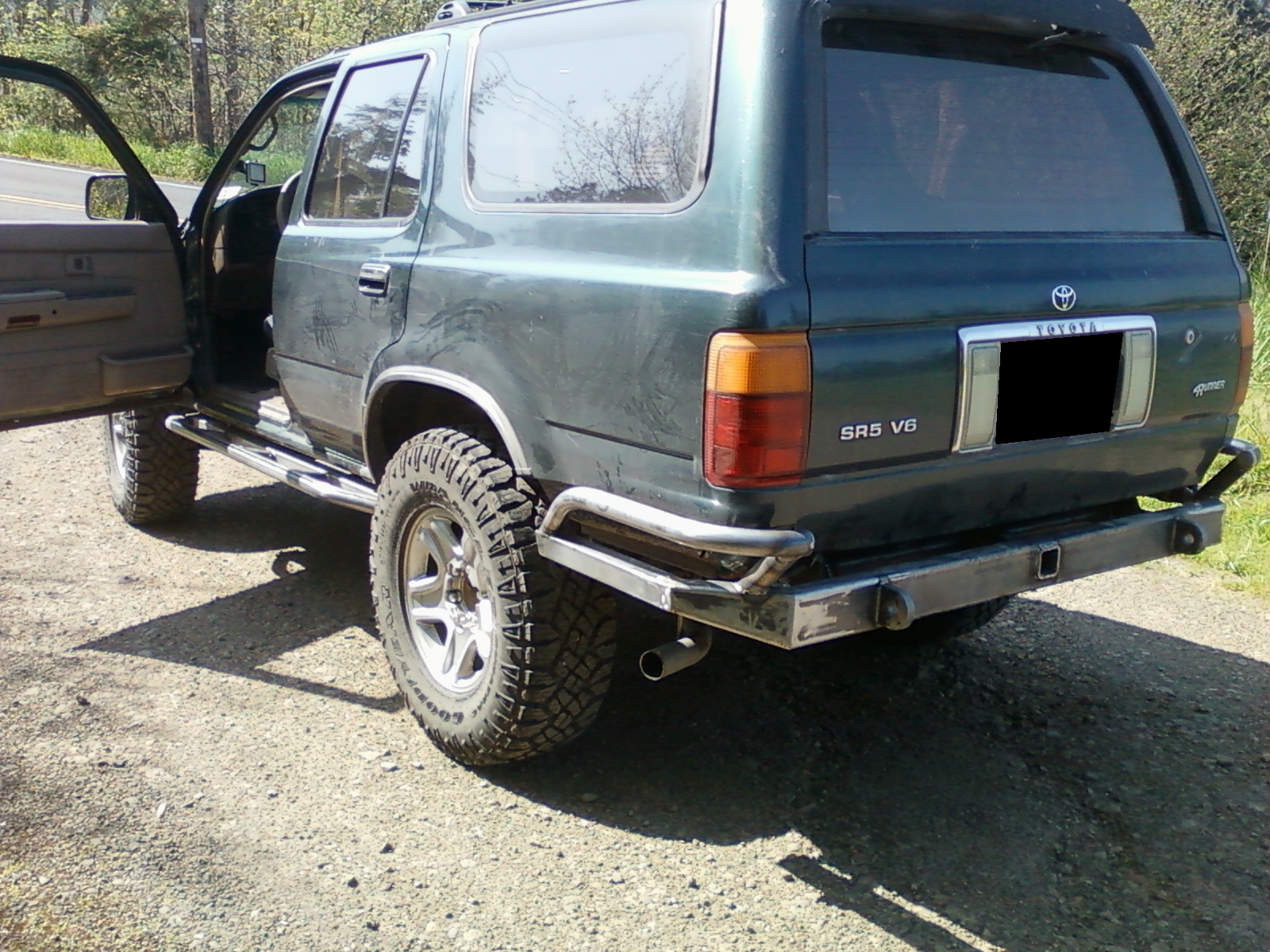

-Corrected "Check Engine" light with 2 12.5 ohm/20 watt resistors (Really they are each comprised of 2 25 ohm 10 watt resistors that I wired in parallel; (Man, does one of them get hot! Melt your shoes hot...)
-Swapped transmission (Supposedly 170k) and rear diff./carrier (160k); pinion and ring looked pristine. Transmission ended up being a bit noisy, and the 3rd gear synchro is unhappy downshifting from 4th...
-Put Duratrac's on from the '80, excellent tire, but I now have wobbles at 65-75 mph.
-A local fellow, Matt from Washougal, fabbed up a set of sliders and a rear bumper. He is a very upright guy, and can build most anything you imagine. (PM me if you want details)
