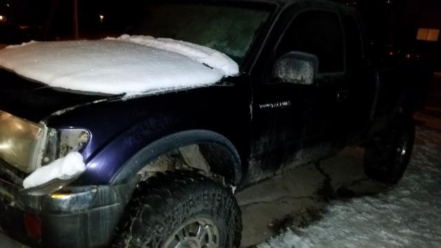

Welllllll.... that project died a while back. However, I have a new project along the same lines; but going into an 85 4Runner.
This time I picked up a wrecked (frame hit) 98 Tacoma for a donor truck. Everything's there; no searching for anything. I still have the 2wd T100 oil pan too.
I'm aiming to have THIS swap done by the end of March 2015.

Donor truck, it's not S/C anymore:
