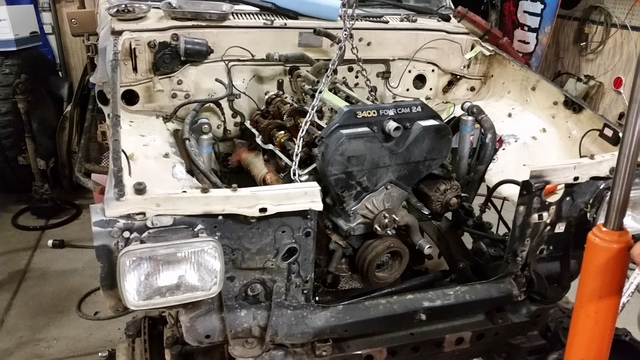

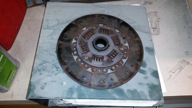

Last September I royally roasted the clutch, so that was the starting point of the actual 3.4 swap; pulled the 22RE/trans/cases in a weekend and replaced the timing set/water pump/etc in the 3.4 the next.

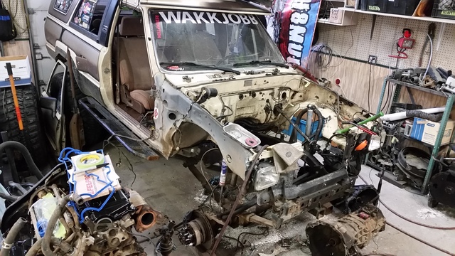

So far:
plated the frame
pulled the 22RE wiring
gutted the dash to get at stuff better
cleaned out all the HVAC stuff
installed a tilt steering column
got a rear seat delete panel
decided to do head gaskets on the 3.4 (286k on OEM stuff... uh, no)
pulled every wire from the donor truck
broke that down by system and tossed a LOT of it (ABS, A/C, cruise, E-Locker, air bags, etc...)
loosely bolted on the T100 rear sump pan
attached the R150
lowered it into the engine bay
cried a little tear of joy
