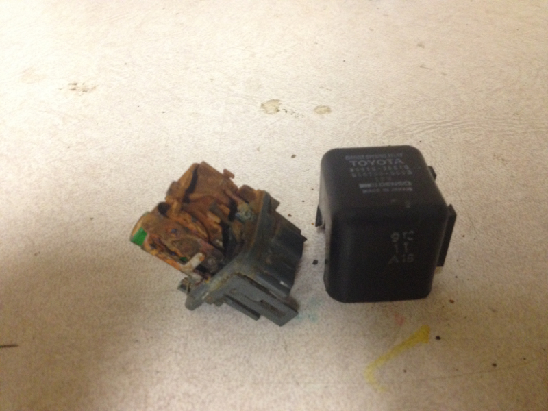

I know... I just bought this runner a few months ago with the swap already done. I'm getting ready (doing my research) to go through all the wiring and redo it. Also went wheeling in it a few weeks ago and was trying to go up this steep rocky ridge and every time I would get about 1/2 way up and as soon as I hit that ledge hard the efi fuse would blow and kill my engine? So my guess there is a little short somewhere and I got to find it. Also when I replaced my cor it was rusted to gummy bears.

That could mean that it was submerged? Is there any signs of water damage?
Old 05-21-2013, 01:54 PM
Jesse Fullerton's Avatar
Join Date: Feb 2013
Location: Oregon
Posts: 47
Received 0 Likes on 0 Posts
No signs of water besides that...
