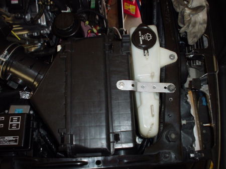

Final fitting of the 3.4 air box is done, it's a tight fit but it's almost like it was made to go there.
A 3.5" hole was cut in the inter-fender for the air supply:
I cut a 3.5" rubber flex coupling from the plumbing dept at Lowes to seal up the hole and keep the engine breathing the cooler air outside the engine bay:
Here's a view from inside with the turn signal removed:
Part of the old battery tray had to be cut out to make room for the air box:
Both of the bottom airbox mounting brackets are being used, but the upper bracket that normally bolts to the radiator support in the newer trucks has to be cut off, so a new bracket was made to replace it.
