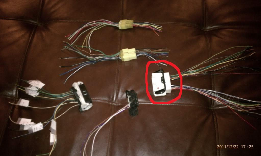

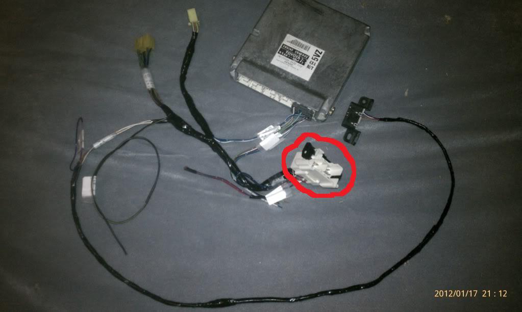

I have been able to source all the connectors needed for the 3.4 swap except for one. I have searched everywhere to find the part-numbers and have had no luck whatsoever. I would really appreciate if someone could help me figure out the part number to the connector I have circled.
It is a male 26-pin white connector with the rotating locking tab.
The only info I have found is that it begins with a 90980-XXXXX.
Thanks

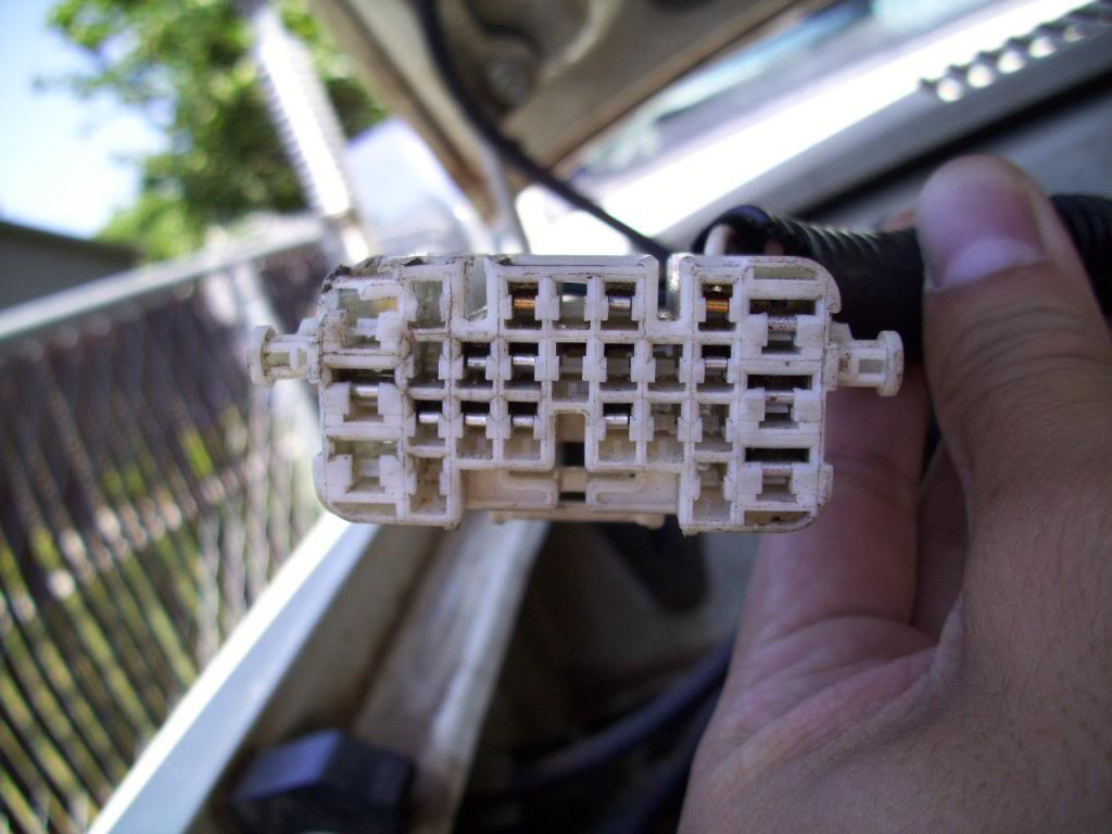

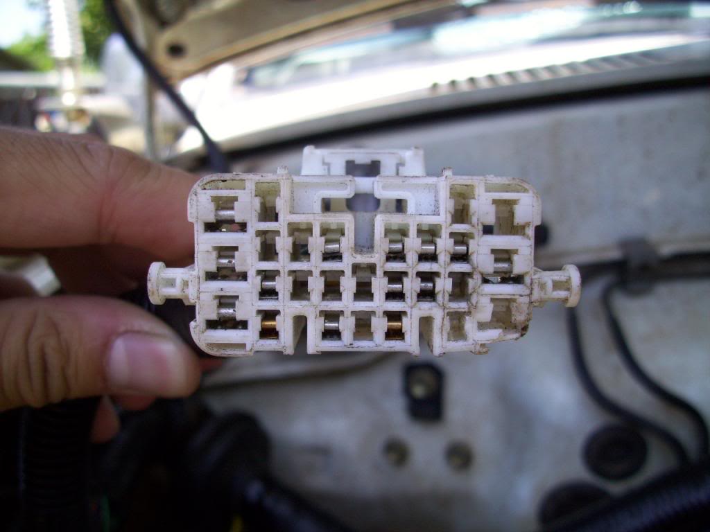

Can you post up a pic looking directly at the pin arrangement? I have a connector guide that may help come up with the part number if I can see the pins and shape of the plug.
I could not find any 5 digit numbers on the female end of the connector.
I tried a few things to see if I could see the numbers on the male connector easier like using a magnifying glass and even rubbing a bit of dirt on the numbers to get them to contrast with the connector but still no luck they are too damaged to see.

Cf, those plugs in post 8 look the same to me. Are they the same plug taken at two different times i.e. before and after the tab was broken off?
Take a look at 90980-11632 on page D-101, 176.
It looks like your female plug upside down. Yes?
Then on page E-49, 363 we see 90980-11631 as the male to 90980-11632 female. The 4.8 pins are the outer 3 on each side and the 2.3II the remaining 16 pins.
So, 90980-11631 may just be it for the male side. Don't know for sure though.

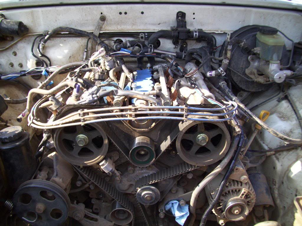

Here is where I'm at right now. I just got some more hoses to route and hook up, I got two more connectors to re-pin and replace the timing components, mount the ecu and figure out an intake. I also did a 5-speed swap and the transmission I received never came with an inspection plate so I still need to source one. If anyone has a spare one that will work between a 3.4 engine and a 1992 toyota truck manual transmission I'd be more than happy to purchase it from you.
