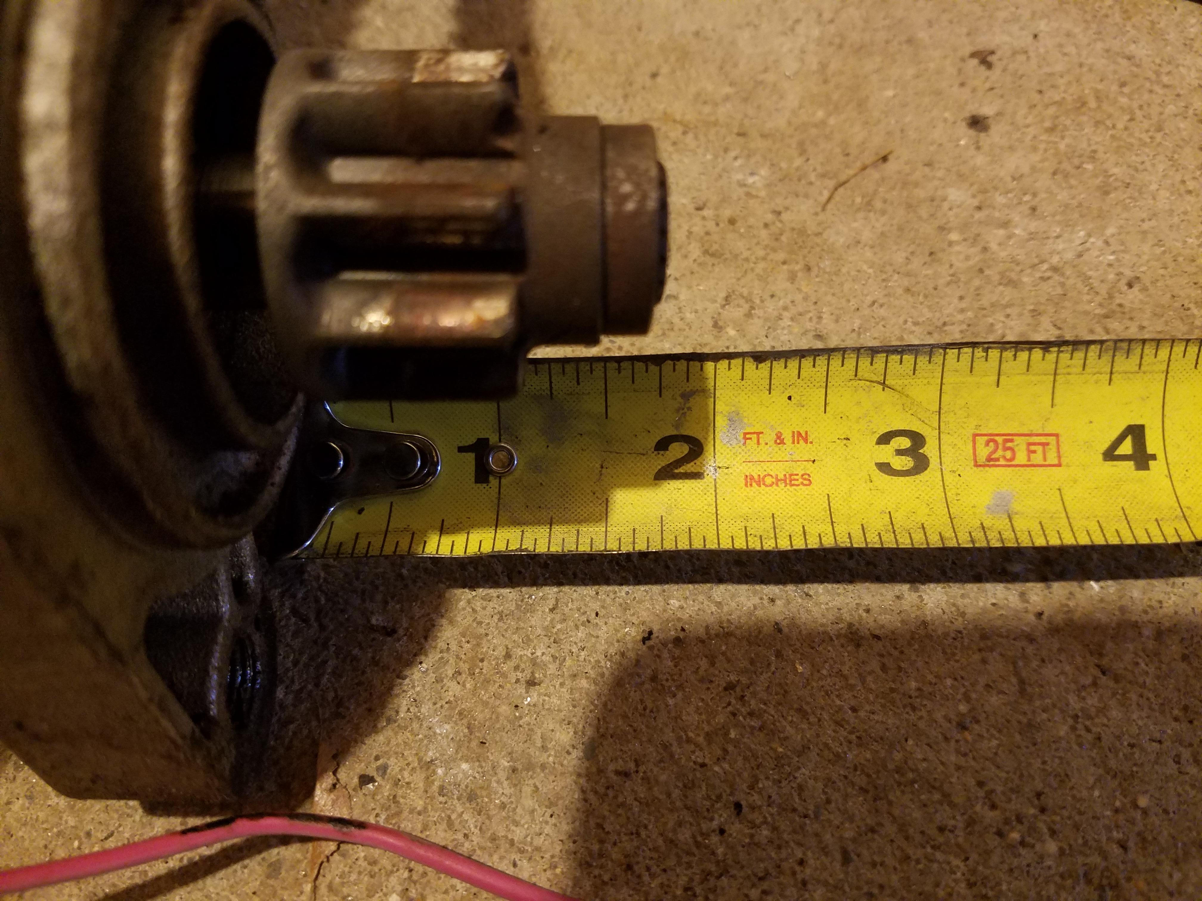

Pics for searchers: this is an aftermarket TYC out of a '97 3.4
This is a Denso out of a '90 3.0
I didn't get the camera dead in line with the gear end for the Denso either, rushing as I didn't want to burn out the coil, so the difference in throwout is actually a little less than it appears even, possibly the same, certainly within 1/16, at least between these years and brands.
