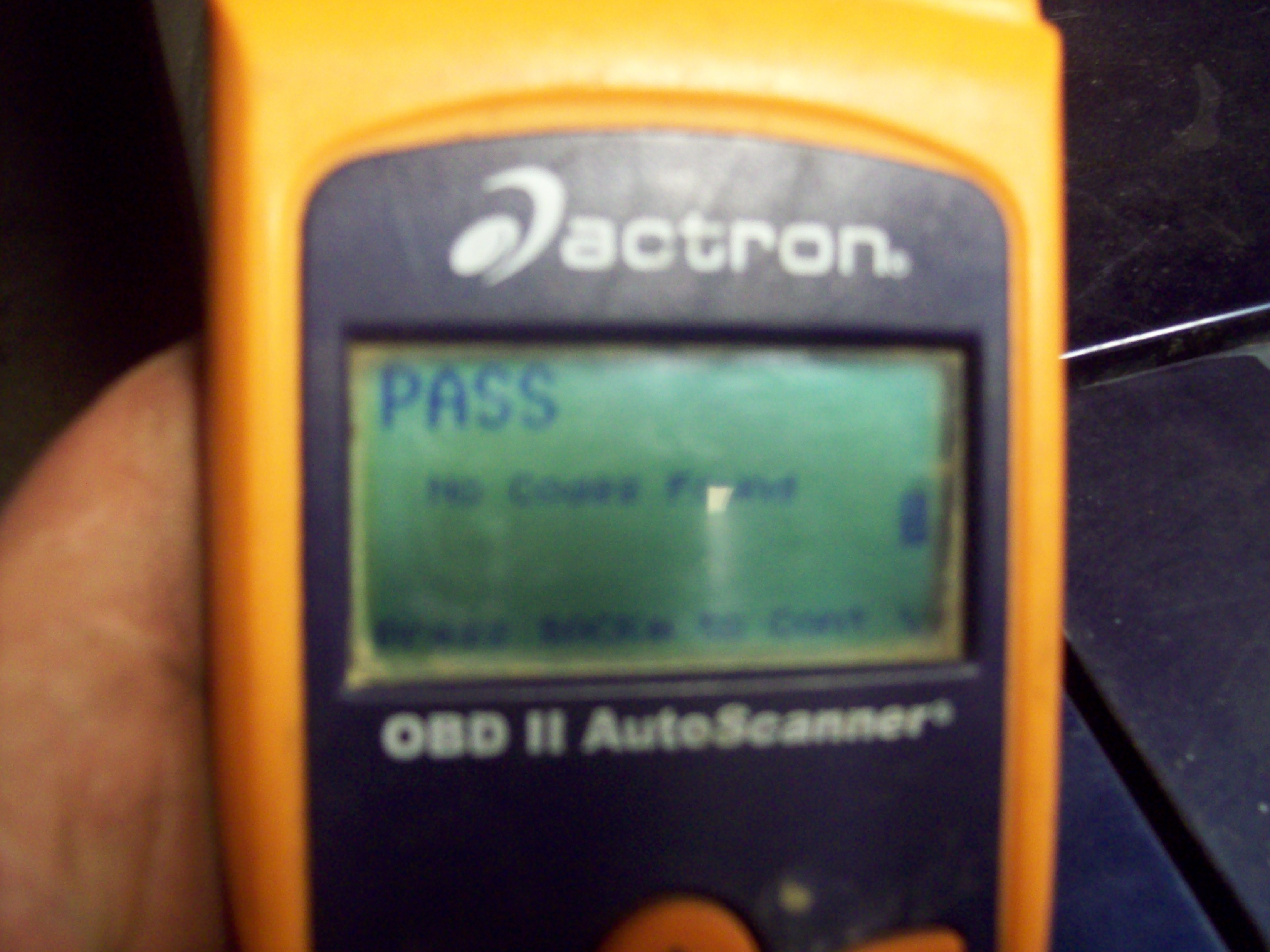

So I finally got the 3.4 to run today. I have a few wiring issues to balance out. I can get on to buttoning up the exhaust. Coolant lines ,power steering, bleed the clutch and away we go.

It was a big week for the yota. The exhaust is finalized and routed. The motor finally runs starts and stops as it should. We finished mounting the battery in a newly made tray. The airbox will still need some work I haven't decided how to go about that yet. The hood seems to clear everything and shut nicely so no cutting there. I had a lot of wiring issues that were unforseen it was almost easier to get it close and then do the final stuff in the 4runner it was just easier to test out. Today I will get the wiring hung and strung and wrapped for final install, finish welding the exhaust and install a new to me used brush gaurd for some flare.

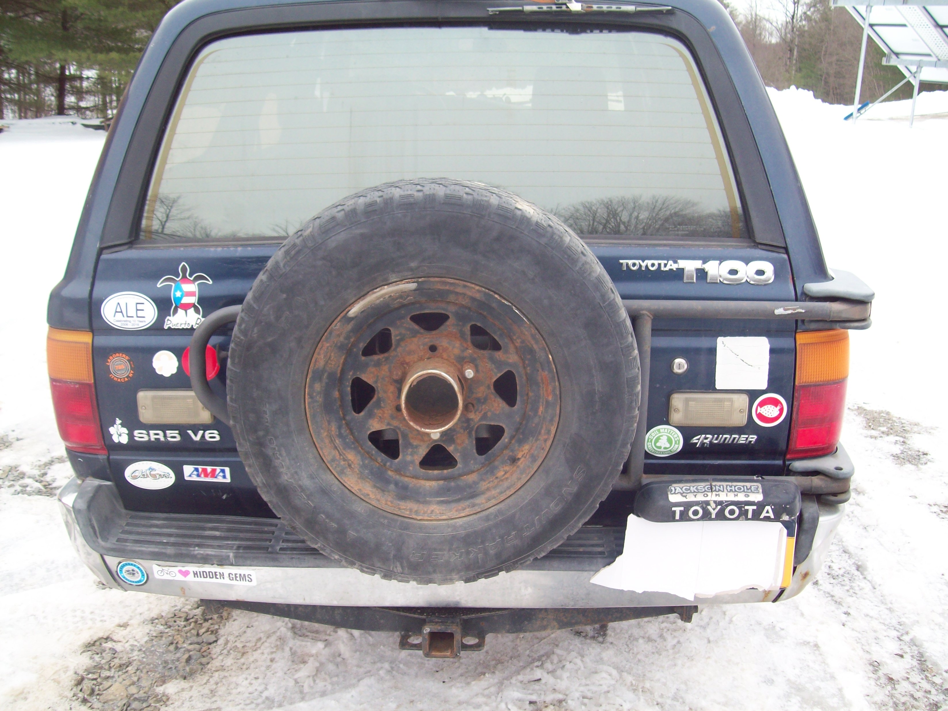

A few more pics of the completed yota. I have been drivin it to work for a couple weeks. We have put about 600 miles on so far loving the added power 3.4 swap made a great truck even better.

I got this period correct grill and chrome bumper at the pick a part last week. I had a crappy black one with the small yota logo from a tacoma on there for a while I like this new one better. Lucky me only one 4runner in the yard and it was a 1990 like mine with perfect grill. I am still looking at options for the airbox I made that shield/bracket to hold the MAF and air cleaner but not sure I am blocking enough debri with it. You can see where I used a 10mm compression fitting to link the two different power steering lines together. My brother salvaged the T100 logo from my donor just before it went to the scrap yard seems to fit well up there on the tailgate.
