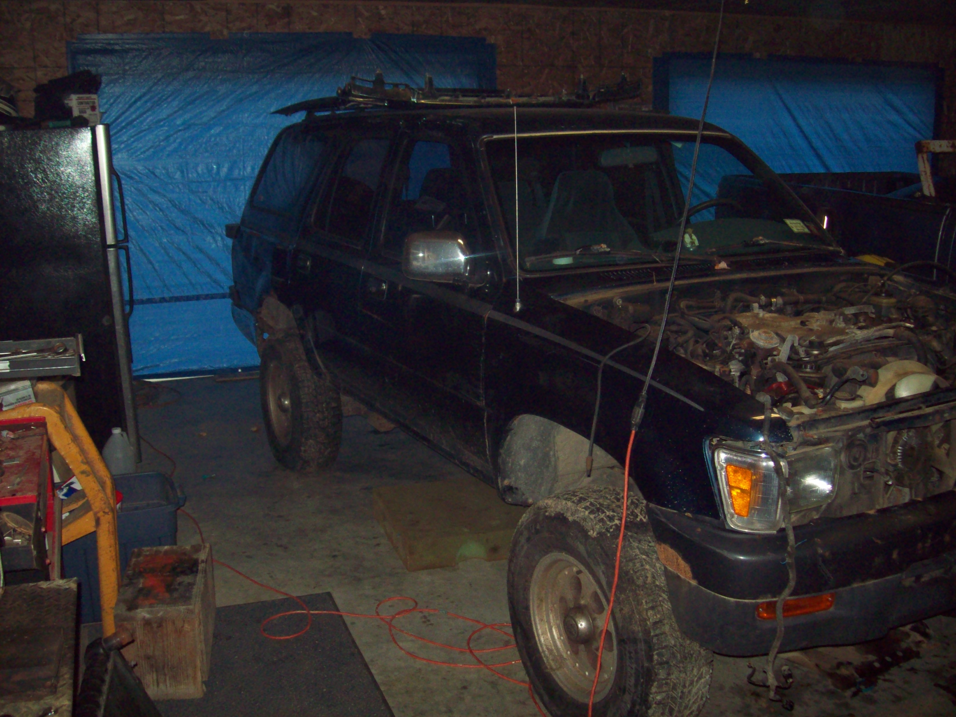

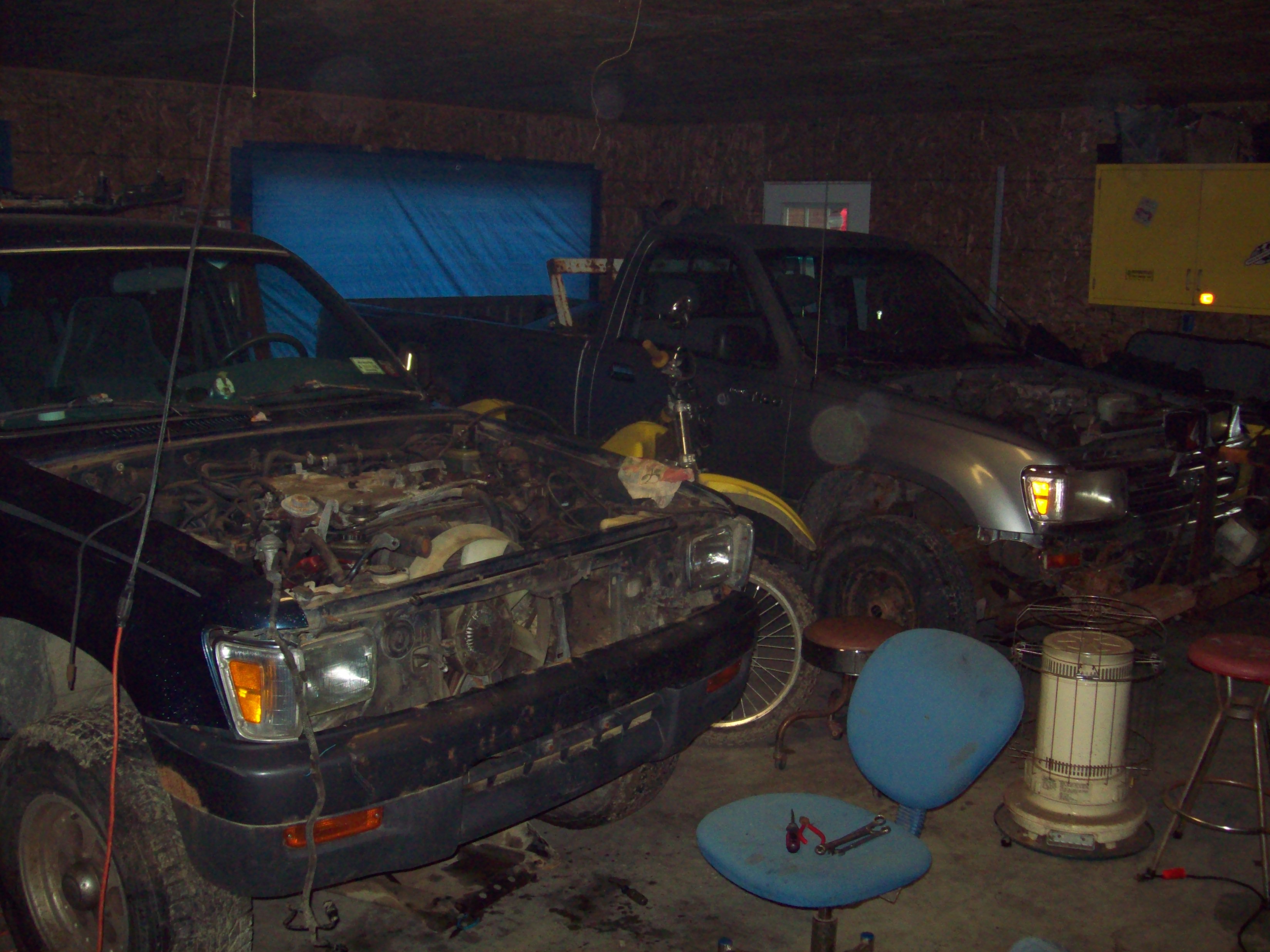

I have finally begun my swap. I brought both trucks in the garage yesterday and got the hoods off. I should be ripping the blown 3.0 out one night this week after work. Then just pull the 3.4 and drop it in the runner.

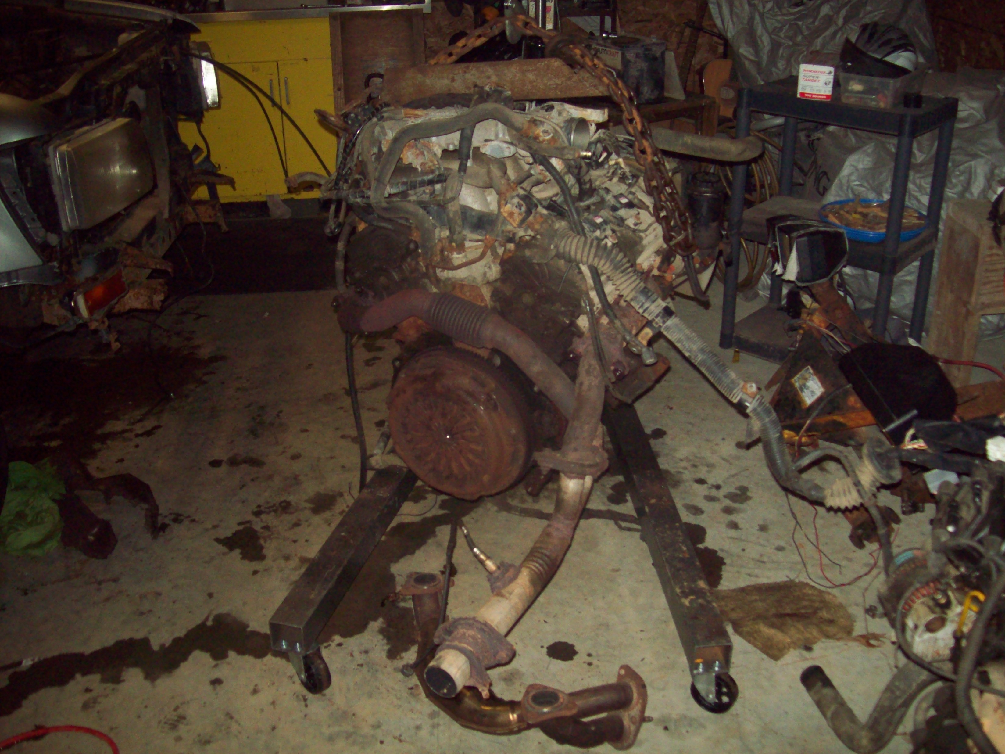

I finished pulling the engine out of the T100 last night. We pulled the blown 3.0 outta the runner last week. Both motors came out complete with the harnesses. I am using the Y pipe from the T100 with a crossover from ebay and the 3.0 crossover to build a new one and cutting and splicing in the section of exhaust that includes the rear o2 sensor. Gotta get a clutch while I am in there Not sure what to get 95 t100 clutch kit I am assuming. I only noticed that the two connectors to the body harness are different this Will be a challenge looks like maybe repinning like smaay said hoping to be ready to drop the motor this weekend but its deer season here so if I am not working and its light out I am hunting.

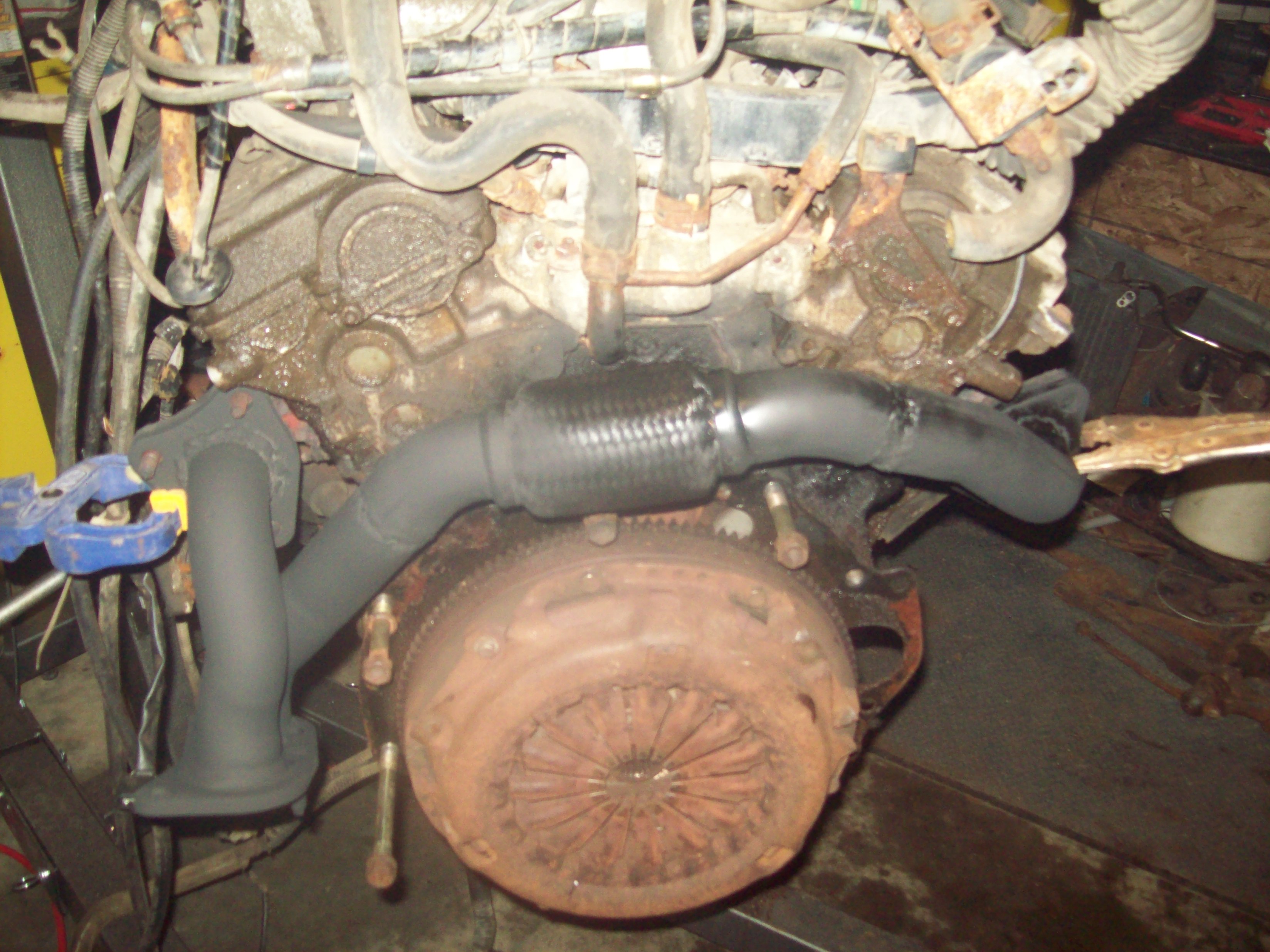

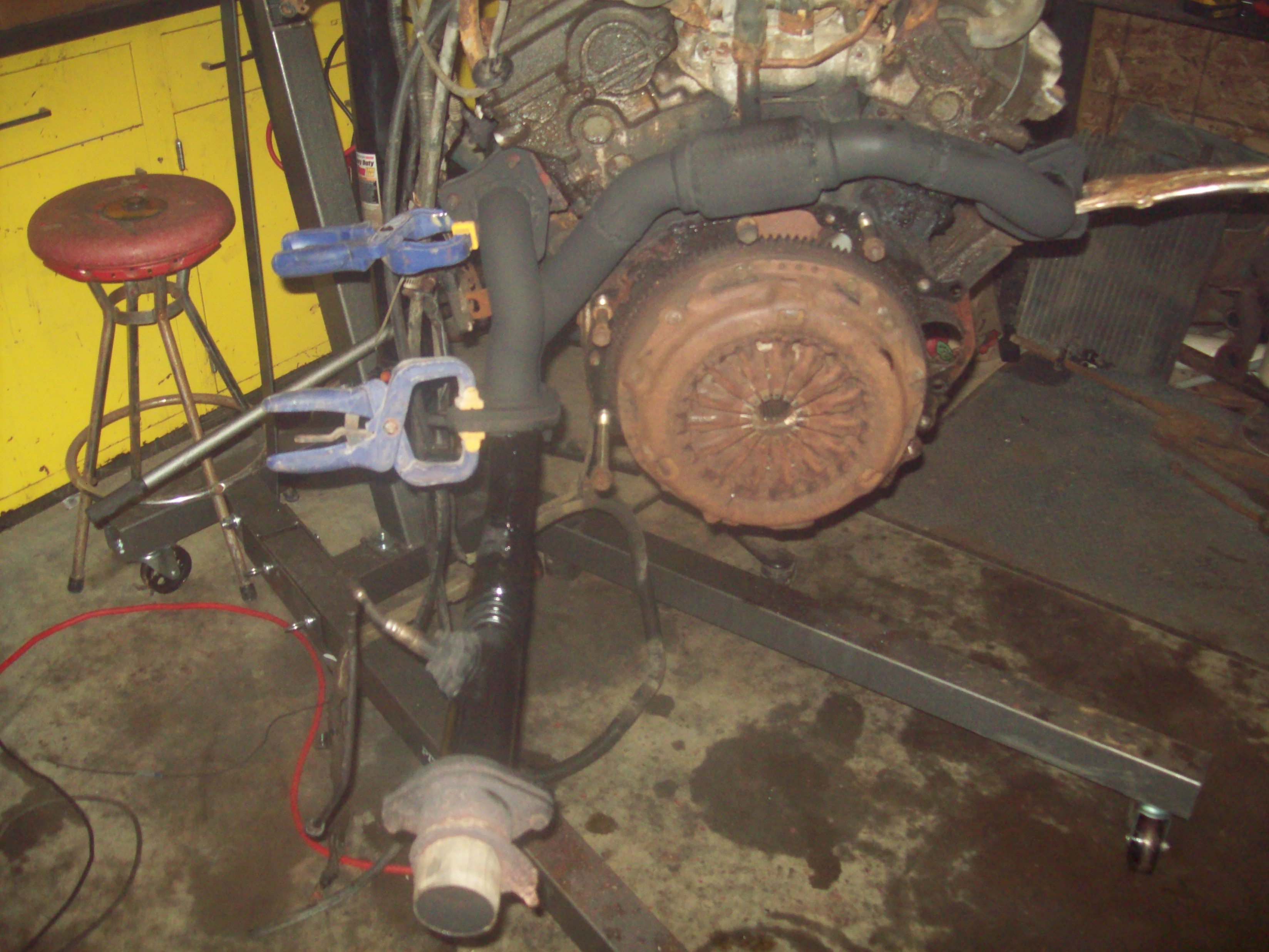

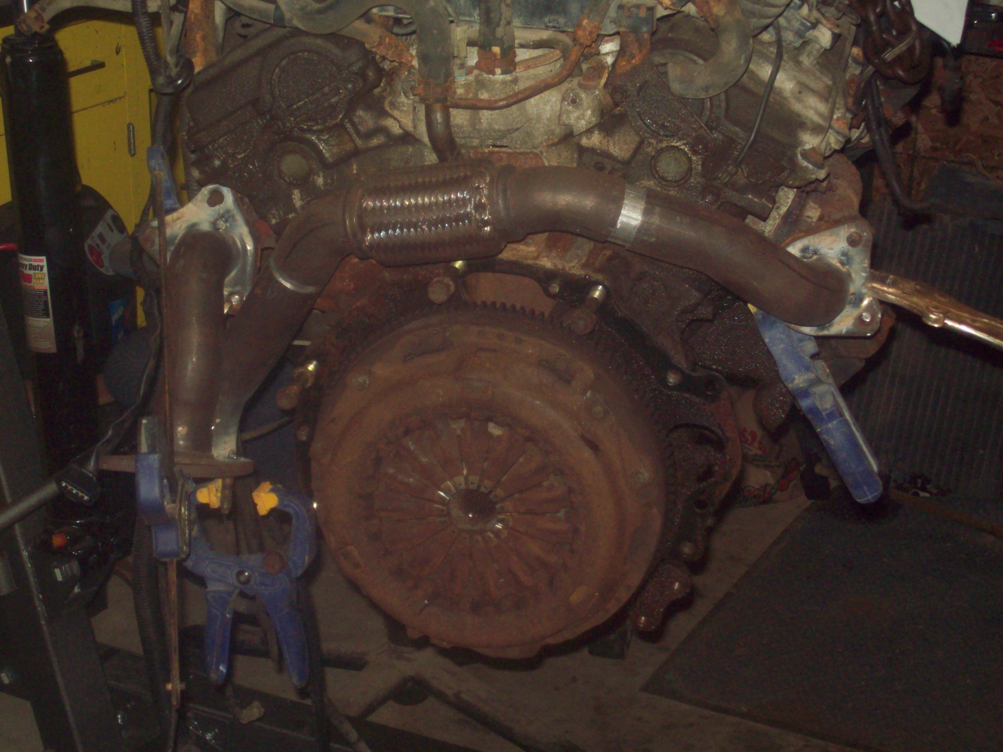

so I got the crossover welded and painted last night. I have been staring at the wiring and got hung up on that. Decided I will just push through with the mechanics of it and I will get to the wiring when I get to it. New clutch and exhaust gaskets and I will be dropping the 3.4. I am not sure I saved any money or got a better product than sending my crossover to one of the shops for fabrication but I can say I did it myself. I followed the advice I read on here cutting the flanges loose right at the welds was genius It made re welding much better. I used internal sleeves to adapt the flex to the other two ends and will be putting the heat shield back on tonight when the paint is dry.

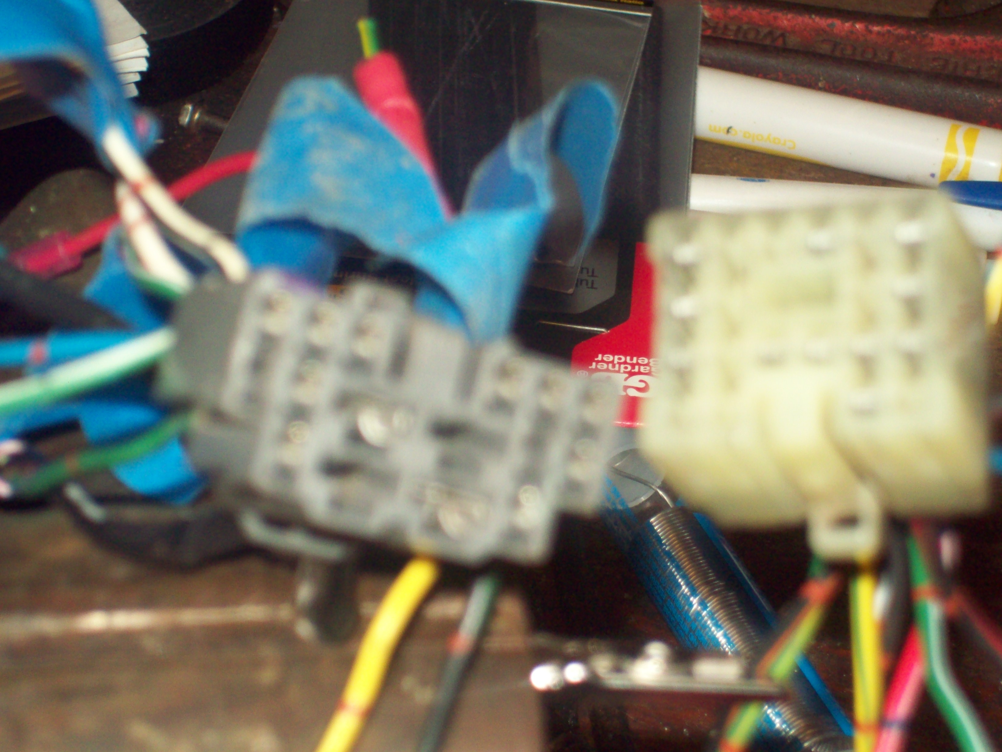

So after my last post I went outside to the garage to poke at the yotas as I unwrapped the tape from my harness I found this. I guess this is not the first motor swap the runner has seen. I was suspect all along. It has 325,000 plus miles. I found a paint pen marking on the tranny saying 89 toyota I thought just the trans had been done. Not much original left on this truck I re did the inside from a wrecked 94 shortly after I got it right down to the carpet inside.

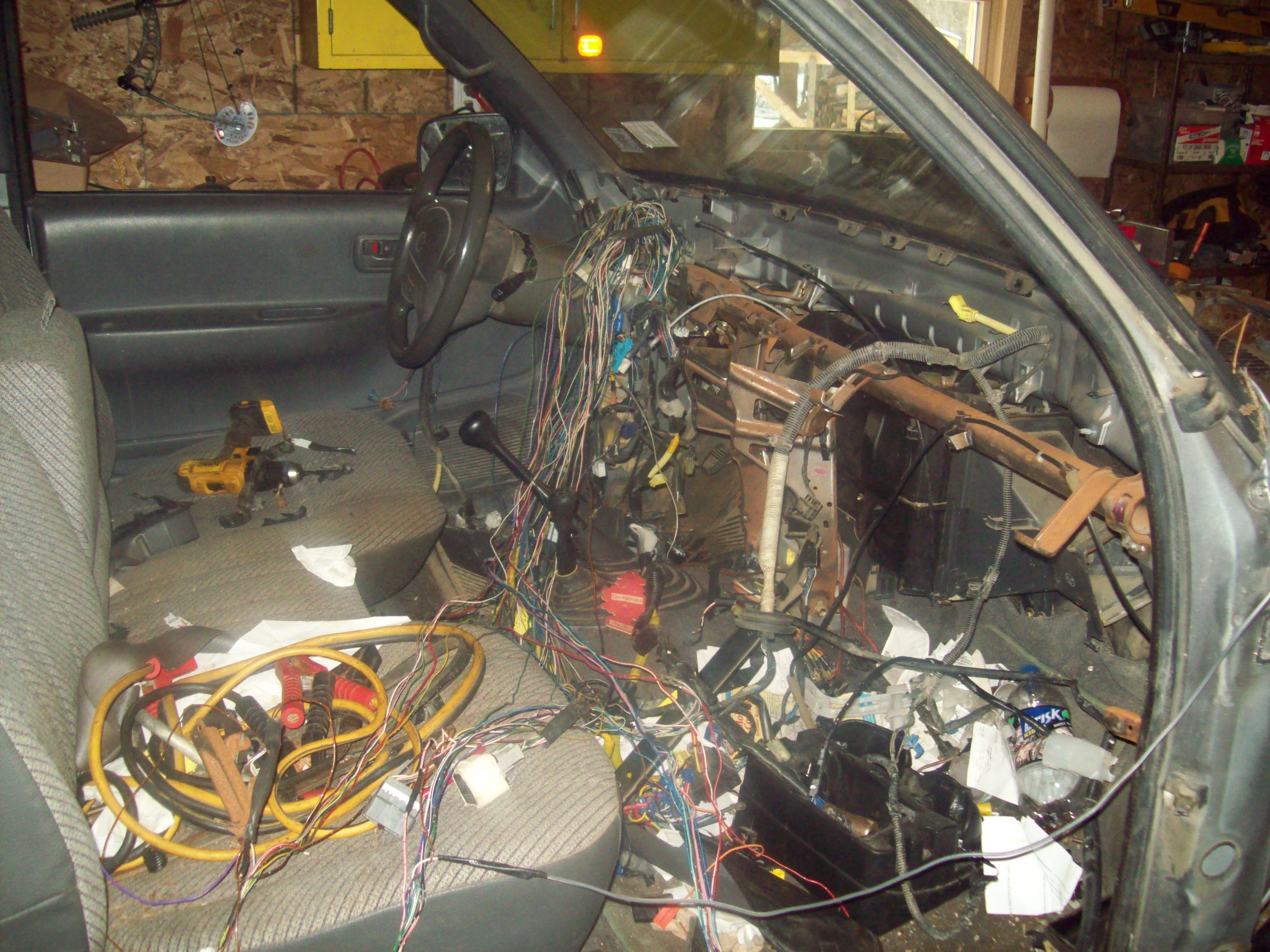

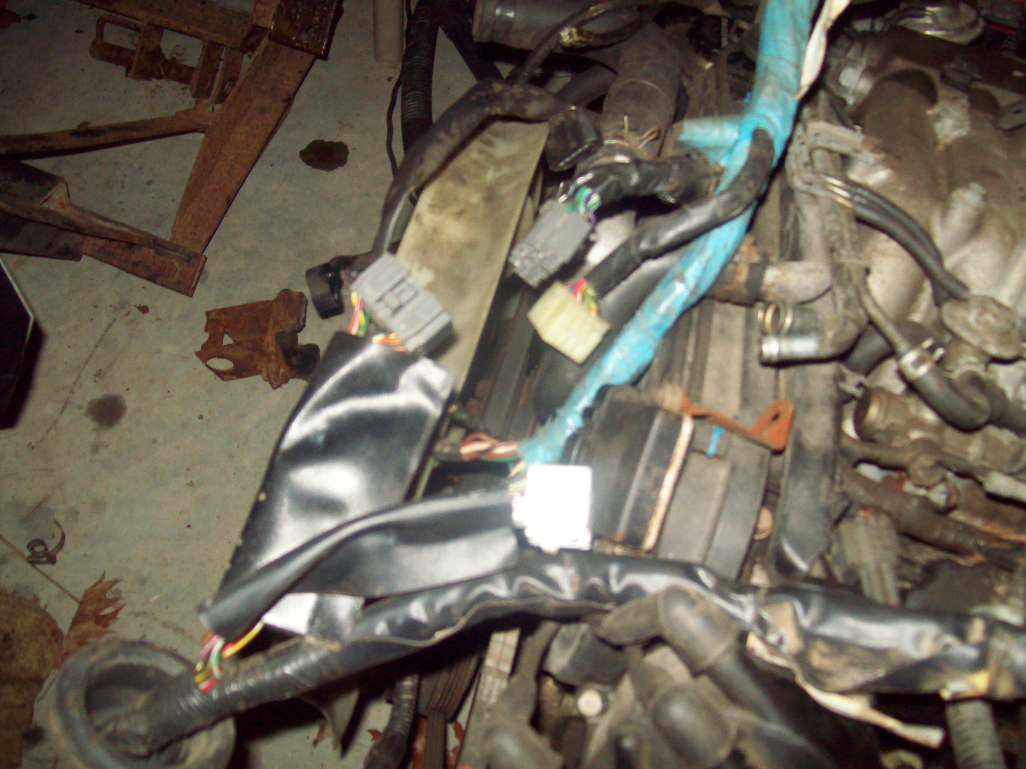

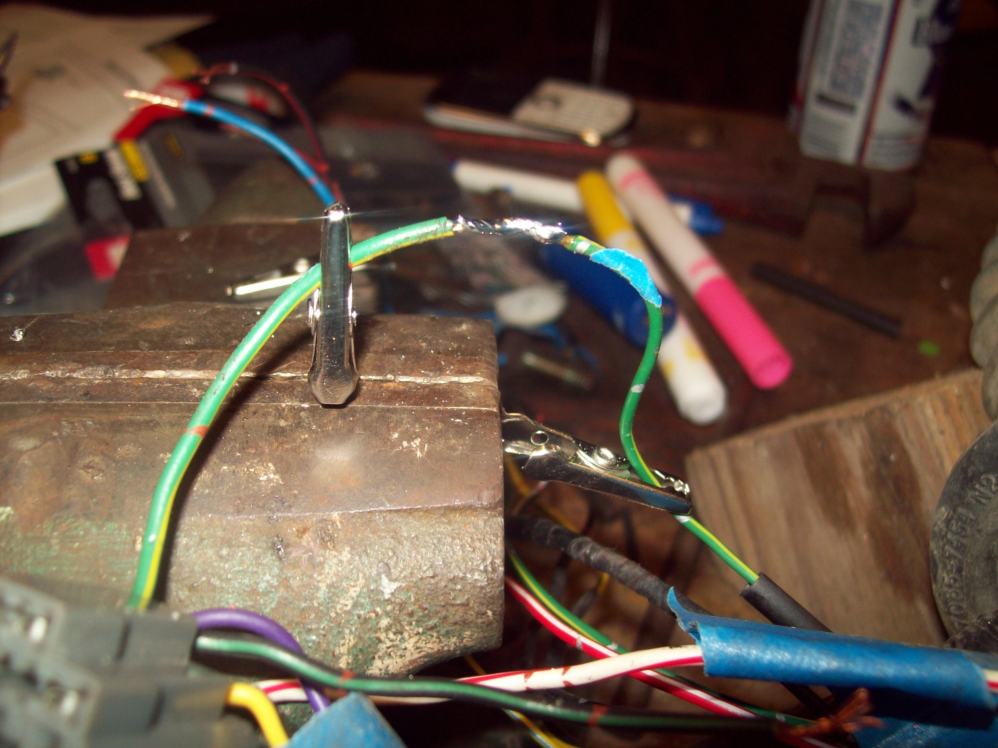

So I have going hard at the wiring this weekend. I have at least 80% of the harness built. Thanks to smaay for the help and ewds. I also printed a copy of themonch's pdf of connector and wiring theory. Thanks to all the other thread owners/starters that I took notes from. I have read a lot of them saying they wish there was one universal easy way. As everyone told me it isn't there they are all different. Donors, years, prior work, any number of things. I have a 1990 runner and I am not sure if it is a crossover year or if someone repinned stuff and cut connectors when they changed the motor. I have what appears to be a hybrid 88/89 n5 body harness connector coupled with a 90-96 IH1 connector not n3 and only half of the pinouts and wire colors in the ewds and other files match what I have. I have used a combination of others wisdom and pinout sheets, combined with ewds for both models when all else failed the meter (luckily I have both trucks side by side in the garage.Got some pics of wiring and my setup. Mostly I wanted thank all those that have posted and those who took time to help a bit more, to rant in a place where i would get some understanding and fore warn others performing the swap DO YOUR HOMEWORK.
