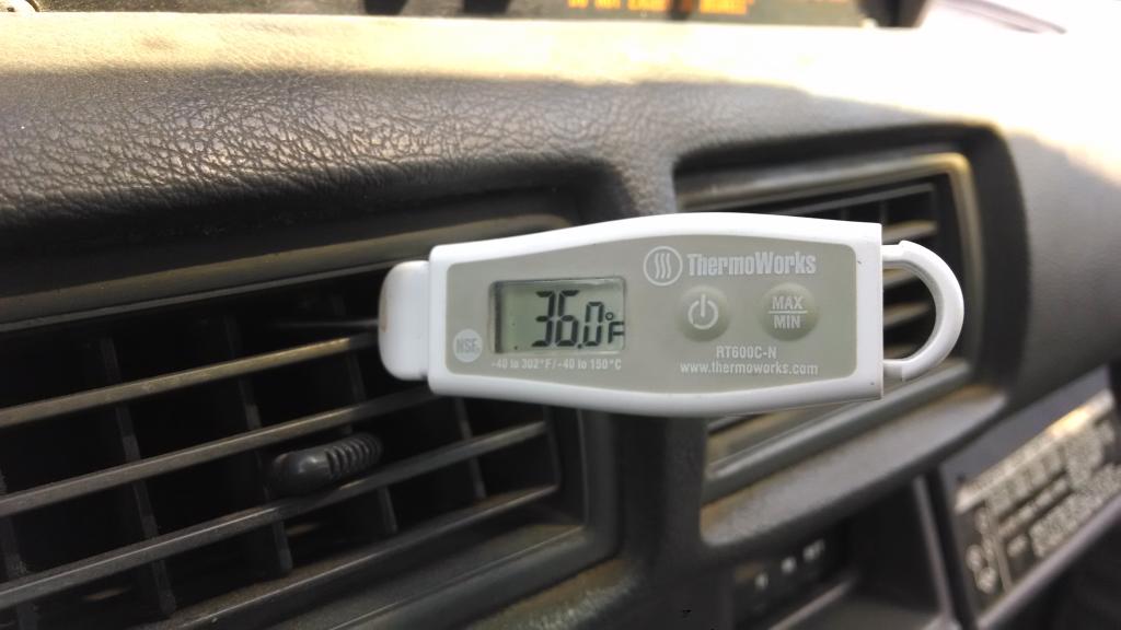

Old Aug 15, 2014 | 08:40 AM
wickedlester's Avatar
Joined: Mar 2014
Posts: 29
Finally......
