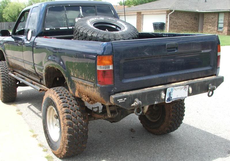

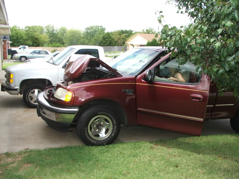

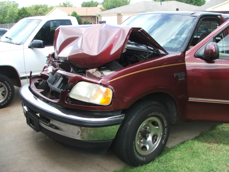

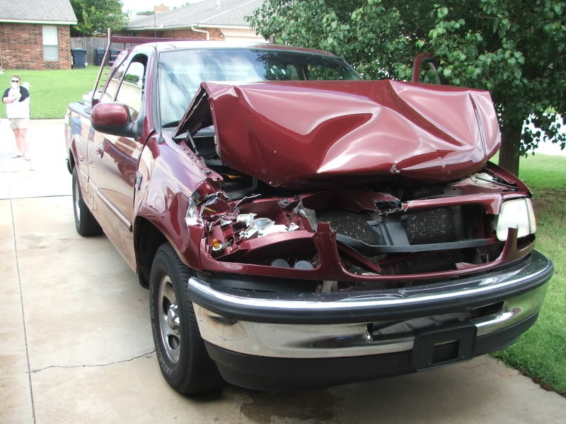

Well, today I got in an accident. It seems everyone on here does for some reason I was slowing down for the car in front of me that was turning into his neighbor hood when all of the sudden I hear tires squealing from the driver behind me locking up his brakes. My head hits the backrest before I know it, and I get this sinking feeling in my gut. We were on one of the major streets here in okc, so the guy that hit me pulls off the road into the neighbor hood that I was slowing down for originally (he had pushed my truck that far forward), I throw my truck into reverse and follow him. He pulls off to the side and when I look at his truck my stomach sinks even further. It was a 98 f150 and it looks like it will total out. I'm thinking "great, if this totaled out a full size truck mine is toast" I hop out of my truck, make sure the other guy is alright and dosent need an ambulance or anything and then go and look at his truck....

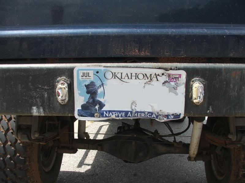

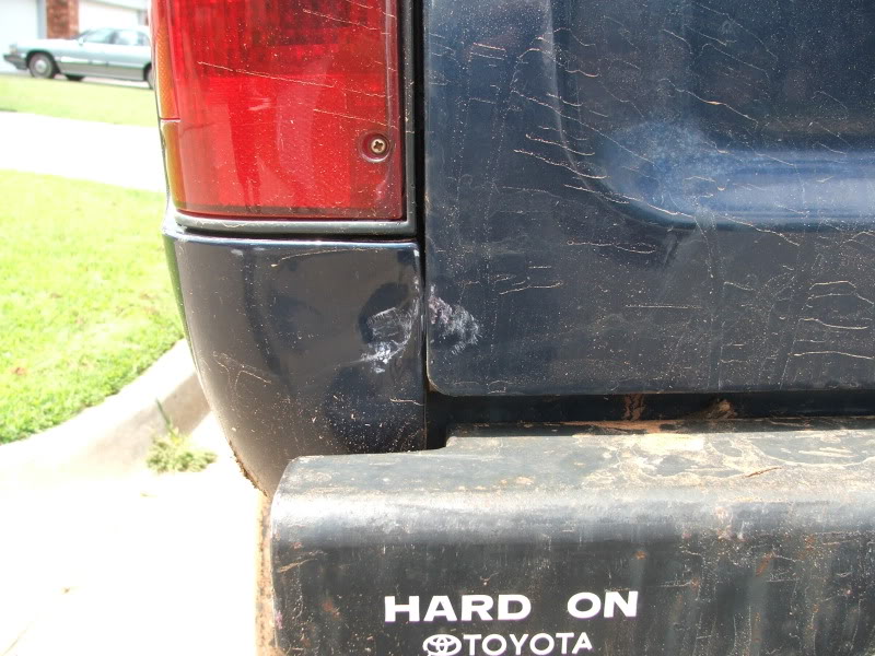

So then I go and look at mine....

I wouldnt believe it if I wasnt there to witness it. It put a couple of dings below my left tail light, mangled my tag, tag bracket, and tag lights - and thats it!! I officially LOVE my rear bumper, it saved my trucks life!! LOL

WOW that thing help up nicely! is your bumper made out of 1/4" steel or thicker? Glad to hear the Yota turned out well though.

IIRC its 5/16", LOL! The real question is how's the frame Jason, and your neck?

holy crap 5/16"?!?!?!?! that thing is sure enough stout.

Yeah, the bumper is 5/16" thick (at the time I made it I couldnt find a 1/4" thick piece shaped like that) and what the d-rings are hanging on is a piece of 3" x 1/2" steel that goes all of the way through the bumper up into the frame. Where the d-rings hang I doubled it up to help spread the load.
