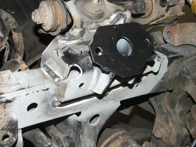

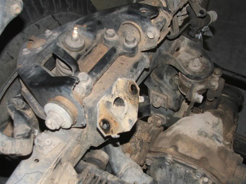

Started with taking the old motor mounts off (after I took the upper control arms off of course)

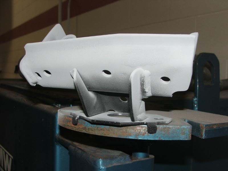

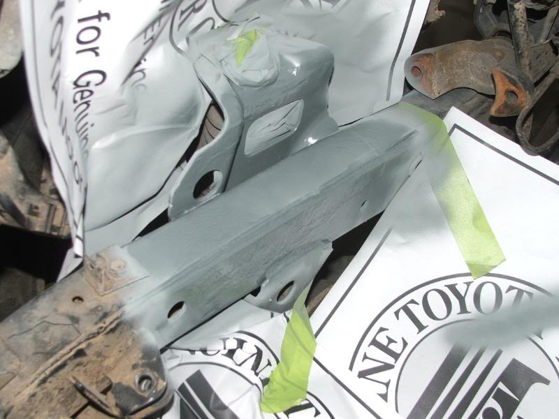

Cleaned up the frame and sprayed this "weld through" primer

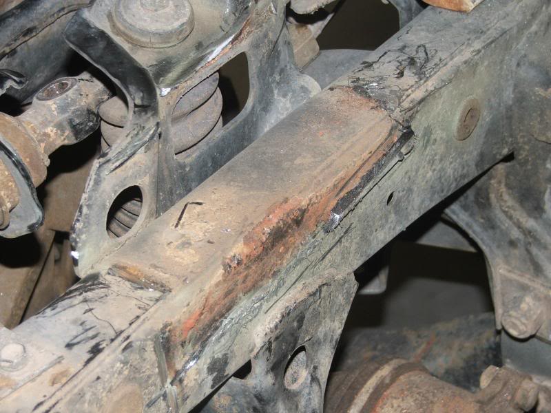

Then welded it up
I decided that I didnt like how the welding went with the primer and welded the driver side w/o it. I did however prime it after it was done.

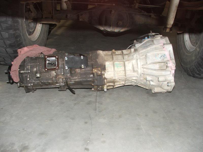

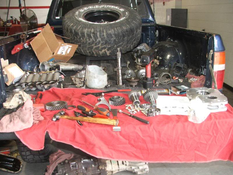

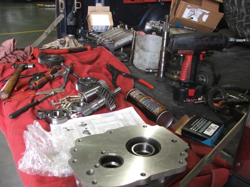

and started on the transfer cases, I decided since I was this far that I would double up the t-cases and put them behind the 00 taco R150 that I got
Once I got to that point and got the trans/transfer case stabed in the truck I had a "little" bit of surgery and was out for about a month

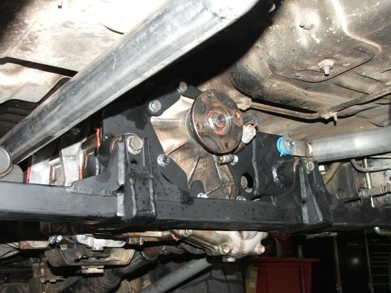

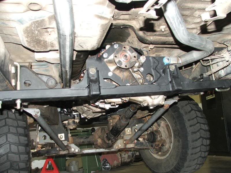

Once I recovered from the surgery it was time to try and get my truck goin again. I got under my truck and just looked at the transmsission and transfer cases for awhile before I finally decided how I was going to mount them

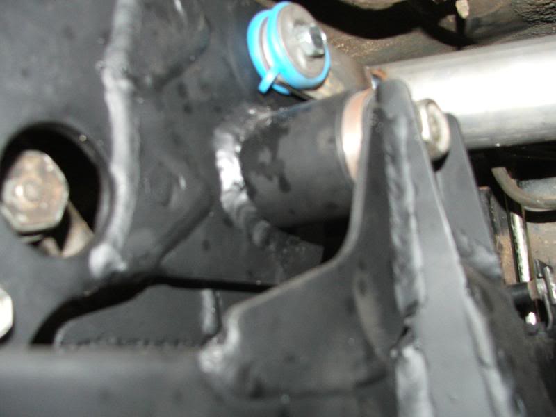

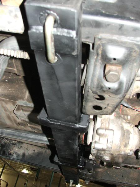

I used a piece of 3"x1 1/2" rectangular tubing for the crossmember and decided to mount it to the frame using u-bolts. I originally was going to use the u-bolts pointing down, but decided that would probably get hung up to much so I fliped them to point up (havent done the driver side yet) and welded a piece of 1 1/2" flat plate on the crossmember to help distribute the load.

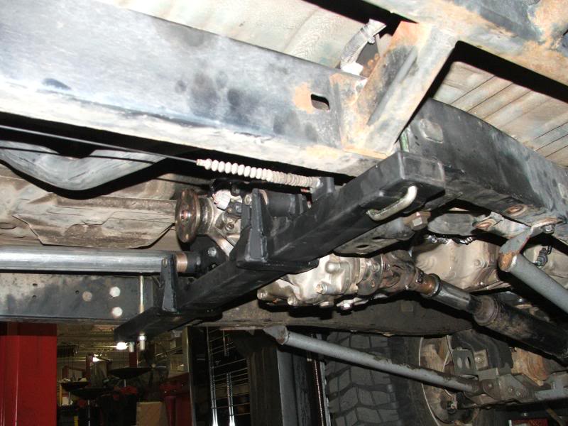

I used a fror style mount on the t-case. I found on pirate4x4.com the plans for one and I had a guy that I was talking to online that had access to a water jet machine cut one up for me. When I got it the plate did not have enough material on the passenger side to weld on a tube for the mount, so I butt welded a piece of steel to it and added the scabs on top of the butt weld to help the strength (the triangle pieces - gussets layed flat)

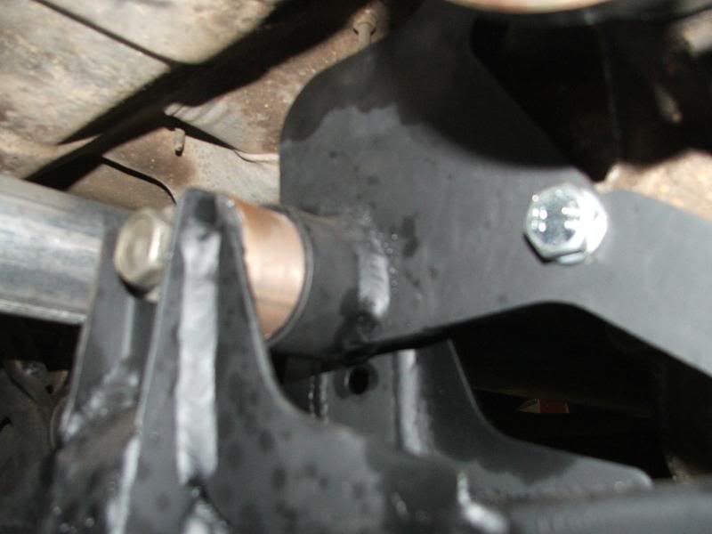

I found out that if you use 1 3/4" dom tubing with a .120 wall that yj spring bushings are a nice and tight press fit. On the crossmemeber itself, I went to the local race shop and found some brackets that were about 3 3/4" tall that I welded to the sides of the crossmember and then reinforced them with gussets.
I know that the old t-case mount is still on it in those pics, it was just on there for temporary purposes while I was mocking up this mount.

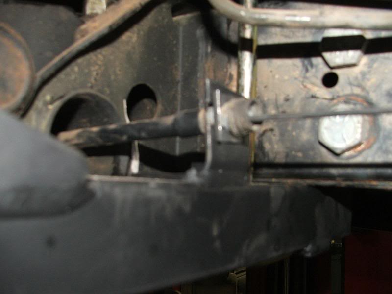

The e-brake was real easy, I just cut the old mount off of the frame and used that to weld on to my new crossmember.
(sorry for the fuzzy pic)

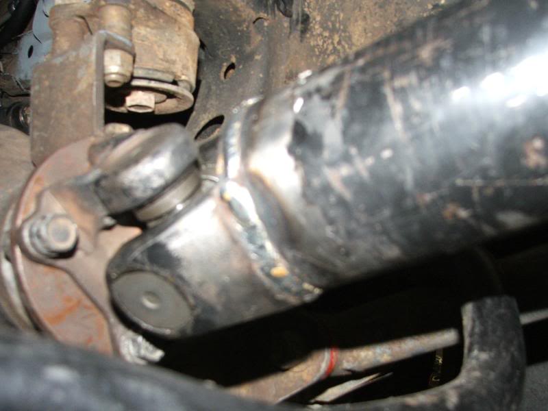

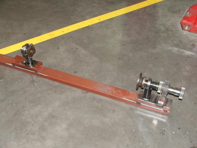

Understand that I am a cheap-skate, so I decided to make the front driveshaft myself. I had an old one out of who knows what that was a little to long so I chopped off the end and found a good way to shorten it on pirate4x4.com. There is a guy on that board that used his spare parts from a double t-case to make this mount so that you can check the runout of your driveshaft when you are trying to do it yourself
So I copied what he had done and made my own, chucked up the drive shaft in it, and did it myself. They were also saying in that thread that I was reading to not make one continous bead all the way around or you will warp the d-shaft, so I made several 1" beads until it was completed.
