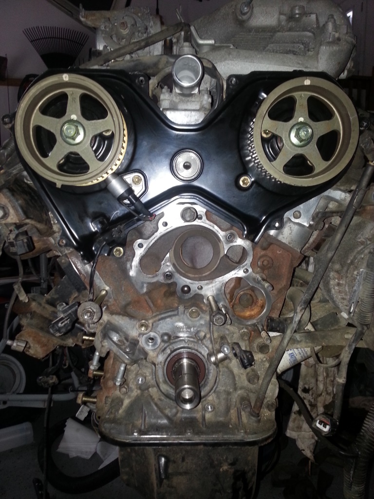

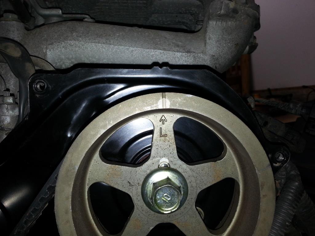

I got the sprockets, water pump, thermostat, idlers on today. I thought I was getting the timing perfect. Once I got it all together, I looked and noticed that the crankshaft sprocket appears to be a "half" of a tooth off... or maybe a quarter of a tooth. Anyway, I could just be paranoid but I thought it best to check with the "collective" experts on here before I went any further. I cranked it around two turns and it ended up back at the same exact place.
Is this ok? If not, I guess I have to pull the belt, turn the crank to the right one hair and then put it all back together. Thanks for the info.
Attached Thumbnails 1st Gen 4runner 3.4L engine swap-crankshaft-sprocket.jpg   1st Gen 4runner 3.4L engine swap-left-cam.jpg   1st Gen 4runner 3.4L engine swap-right-cam.jpg

Figured out that was fine. Barely bumped the right crankshaft, the bottom was in line perfectly and when I looked at the two cam shaft marks they were still in line too.
