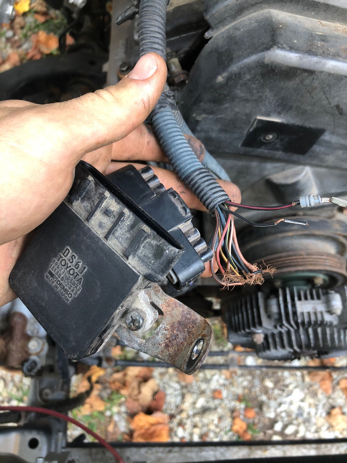

1996 3.4 igniter pinout or picture
If anyone anyone has a pinout or could take a picture of their 1996 igniter plug it would be super helpful for me. Mine got ripped out in the motor pull... guess that’s what I get for not paying attention and double checking ... wire colors are as follos
br/b
br/y
br/r
br/w
br
b
b/w
b/y
b/l—-blue
b/r

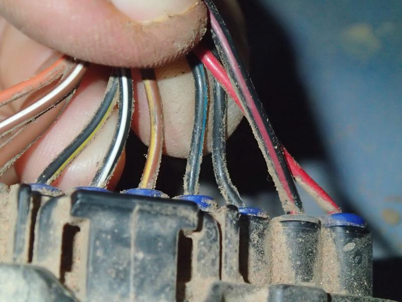

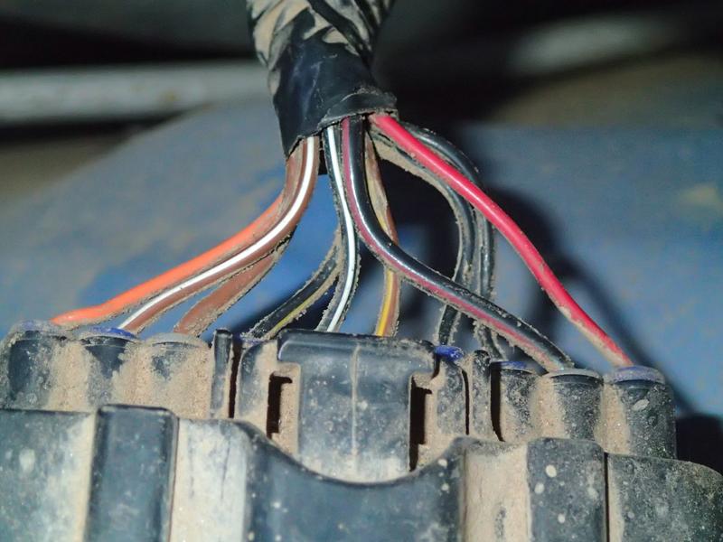

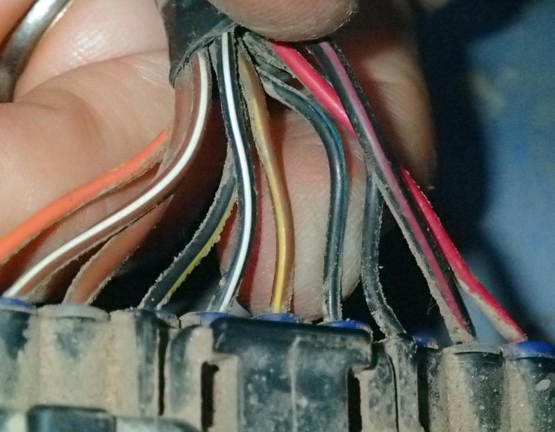

My 96 3.4...
Orange
Brown/white
Brown
Black/Yellow
Black/White
Brown/Yellow
Black/blue
Black
Black/red
Red
As it is seen in your pic, left to right
Pics coming for better reference...
