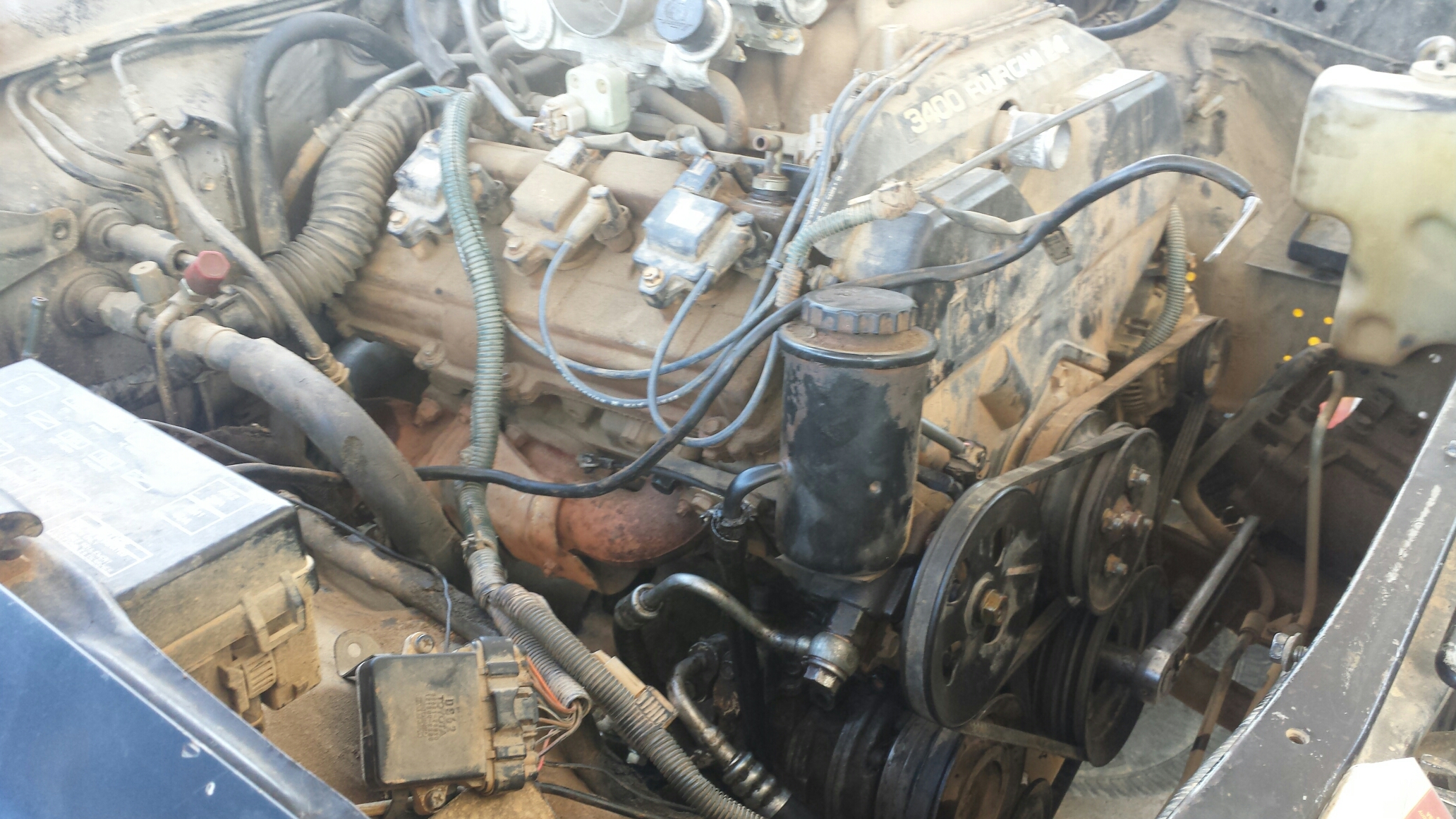

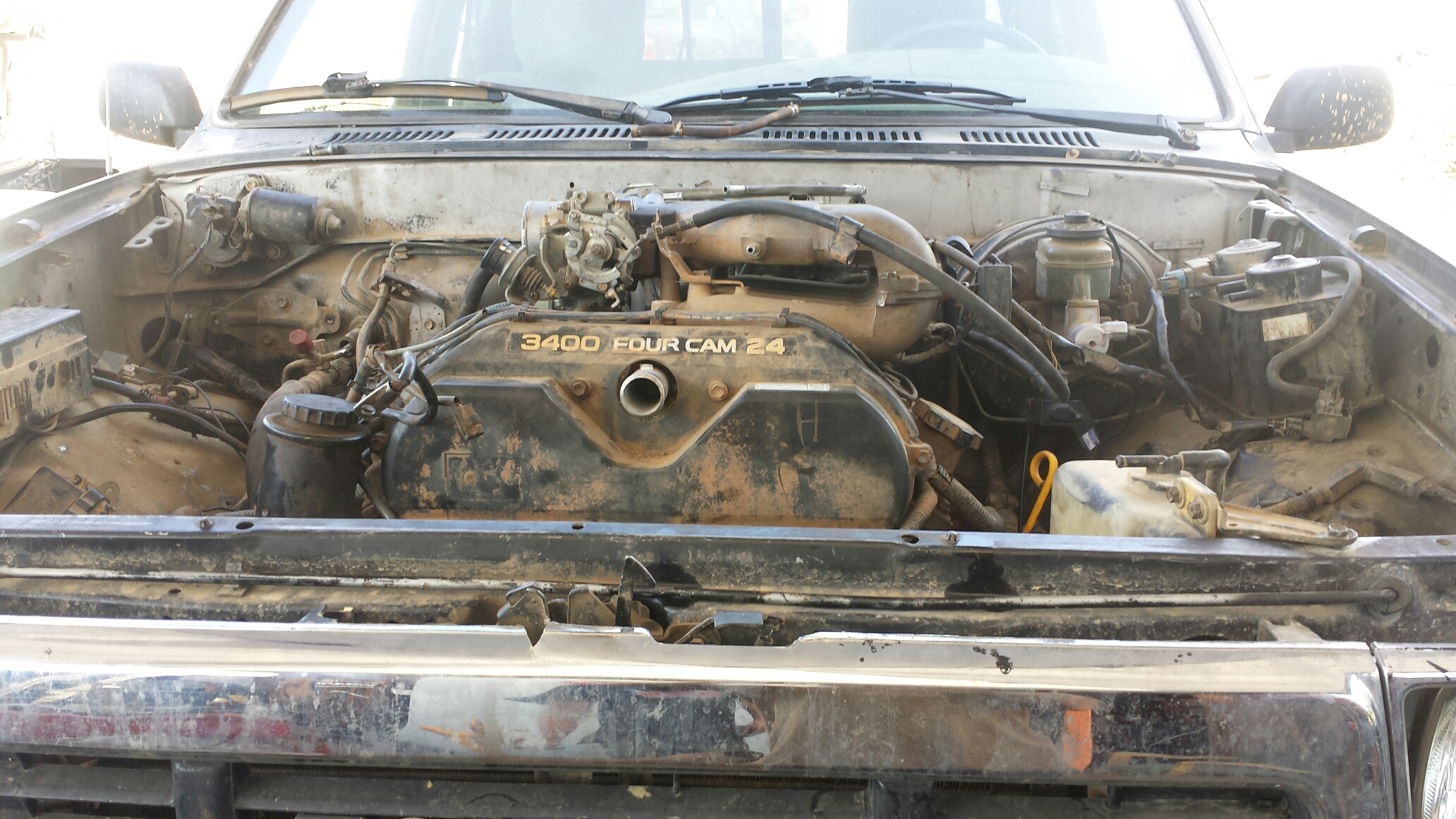

So I got around to getting the motor in with a custom fabbed crossover, I'll have to change it when I go to bar it. I ended up having to use the 3.4 power steering pump but I changed the pulley to a v belt pulley from an Isuzu trooper. I also had to add about 1/4" of shims behind the a/c pump to clear the block.

Well I thought this writeup was going to be a little more informative. After getting the motor in the truck everything was pretty straight forward. I still have to fab a mount for my Evap box and I still need to buy my own intake box since I'm borrowing a friends. Anyways motor is in the truck, I got it fired up yesterday. I missed a vacuum line and that threw a check engine light, but after I got that fixed no more check engine light. Looks like my wiring is pretty dead on, I'll find out if everything is working after I get my exhaust finished today. It was nice tho, it fired up first try, no chasing wires to figure out if something was in the wrong place. Rockin!!! Also the pulley swap I did to retain my stock belt setup worked like a charm.
