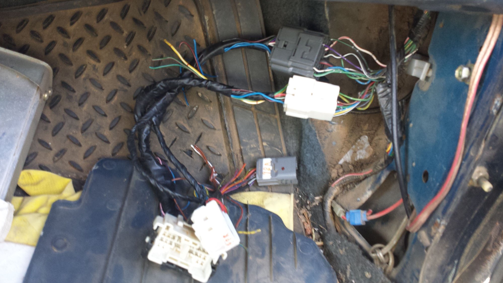

I also got the wiring finished and connectors transfered.
94 connectors in the 89
94 connectors and 5VZ swap harness
Spreadsheet made it easy to decipher

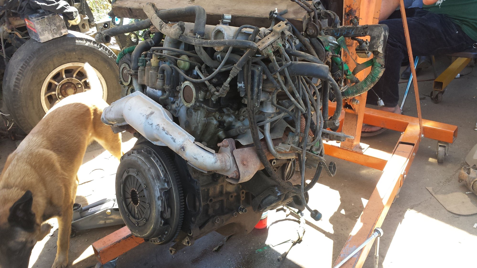

3.4 to go in.
Front of 98 5VZ
Passenger Side of 98 5VZ
Driver Side of 98 5VZ

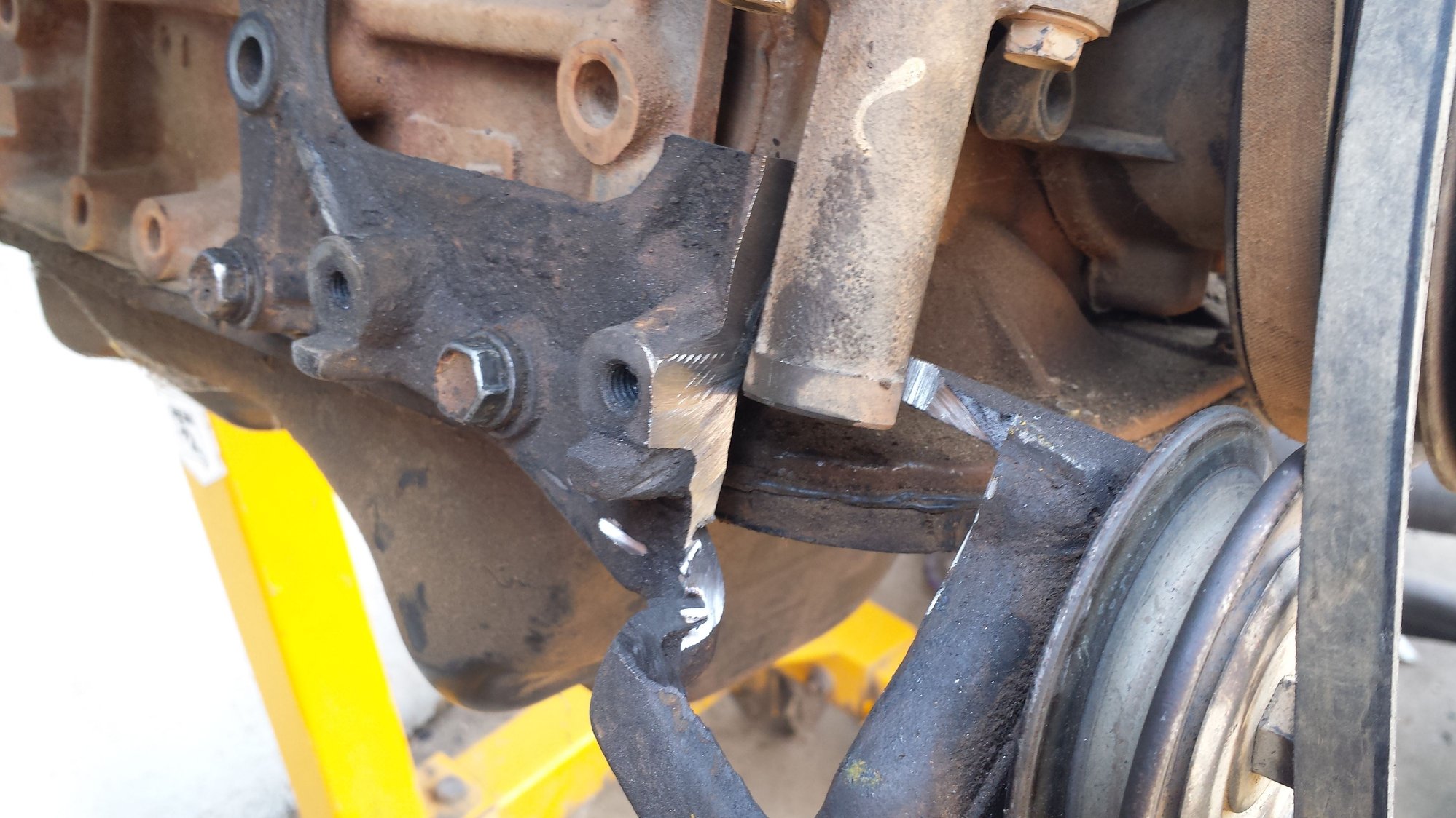

Old 08-19-2015, 04:30 PM
Fyca's Avatar
Join Date: Jan 2015
Posts: 23
Received 1 Like on 1 Post
Ok so I made a little progress today. I was trying to figure out a way to keep all of my stock accessories because I don't have the 3.4 accessories and it would be out of my budget to find them. Anyways I ended up modifying my 3VZ A/C bracket and using the 3VZ crank and water pump pulleys. The pumps are still in the truck but here is how the bracket looks. Everything lines up perfect, although I may need to make or buy some standoffs for the A/C pump since the 5VZ casting is slightly different and some tabs poke out a little further. Oh ya, I also got my 3.0 dipstick in and mounted, nothing too hard but I'll post pics of that later, I forgot to take pics of it.
The room between the water pump pulley and the A/C belt is very minimal with this setup. You can see in this pic that the pulley is sitting on the belt by a hair. I think when I get it running it might smoke for a second from the rubbing, but the belt itself should be fine. If not then I will put the pulley on a lathe and take off 1mm or so.
