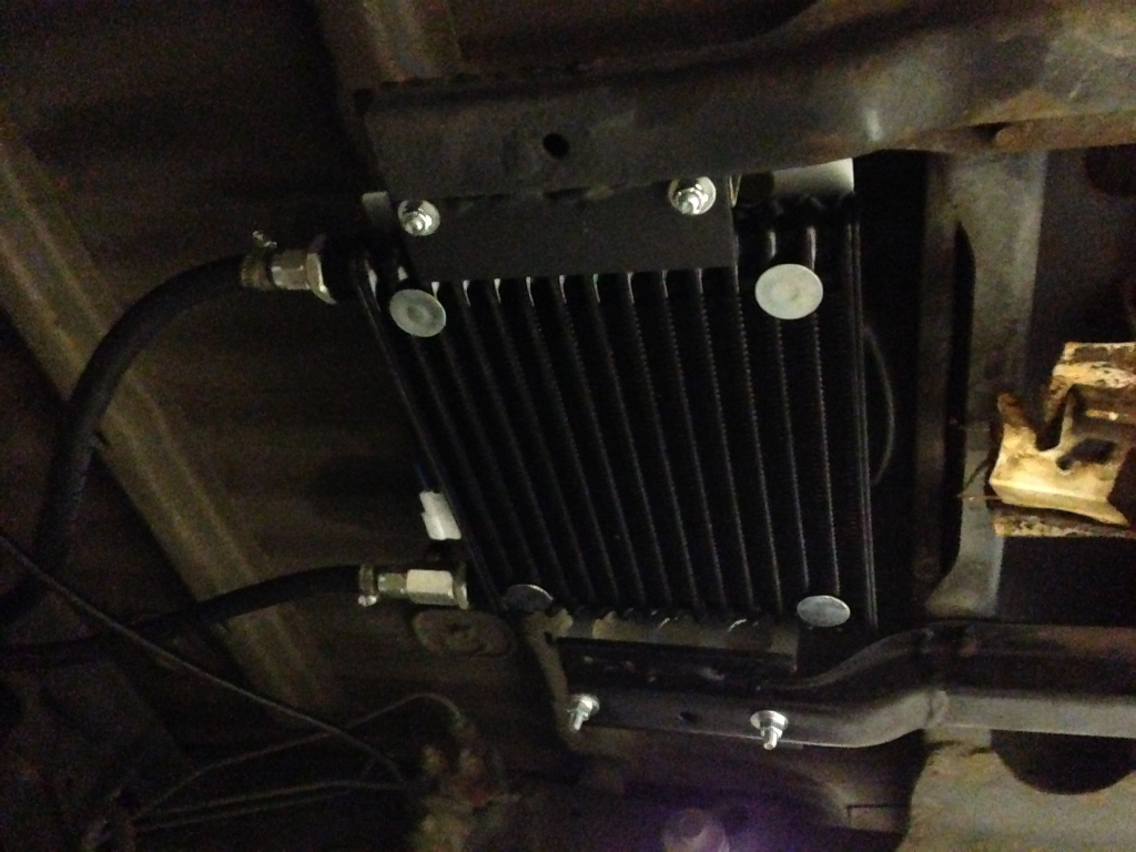

Have not updated this for awhile, but I was able to get the remote tranny cooler installed. I installed one earlier, but it had a hole in it from the factory and when I fired it up to move it to work on the exhaust it dumped all the tranny fluid all over he shop. I ended up mounting it above the the spare tire mount.

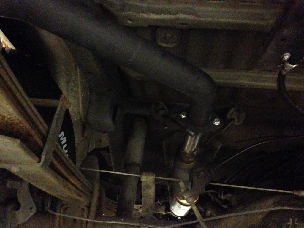

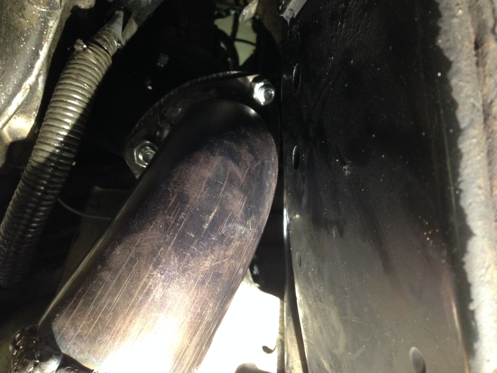

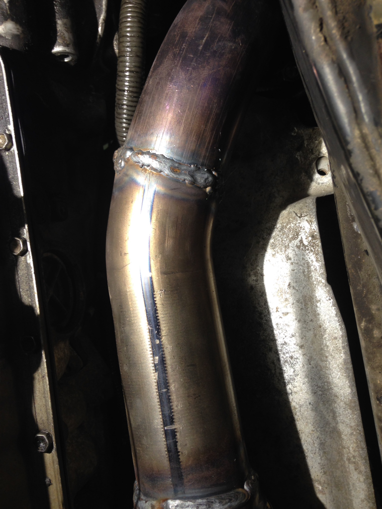

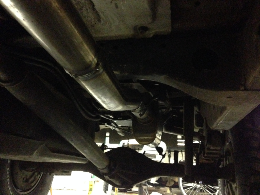

I also finished up the exhaust. It was a tight fit getting it away from the frame from where the crossover dumps. You can see here just how close it is to the frame.
