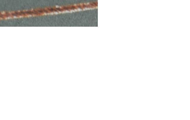

How much rust are we talking about? Show us a picture if possible.

Man, that took forever. sorry, guys it's been cold and rainy here. Somebody please help me out with what I should do with this rust

OK i live in Minnesota and fix rust on my truck just about every year so I give so info to put you in the right direction. As for the good news the amounts of rust that you have are very minor and will be easy to fix. If you go to checkers or any auto parts store and look in the body repair section you will find everything that you need. All you will need is sandpaper, rust treatment(brush on stuff works best) and body filler. First buy some of the auto sandpaper that looks kinda like a sponge its either green or brown, you take that and scrub area with rust and try to remove all loose paint and rust(It probably won't get rid af all the rust's color, then brush on your rust treatment and let dry for atleast 24 hours if you let it dry 48 hours the better you are. Truck must be in a moisture free environment while drying. Once it is dry take some 600 grit wet/dry sandpaper and sand it in a circular motion to try to smooth out surface, if you can't get it perfect get some body filler and apply it on surface, I generally spred it with my finger but if you have a plastic puddy knife that works best. You are building up the body filler to get rid of the uneven surface from that sanding, let the filler dry then lightly sand it till it looks smooth. Tape off area with blue painters tape and apply primer with rust preventative in it, let dry then apply topcoat of paint allow dry then wait 48 hours the rub it with rubbing compound to blend new paint with old. Forgot to say you will also need tape, primer and body paint.
It really isnt that hard hope I didn't scare you, any question send me an email at blainelukens@msn.com
