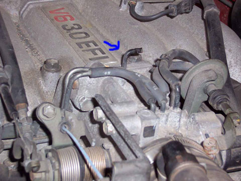

I just purchased a 93 4runner 3vze 4x4 and I noticed there is a line coming off the throttle body that is crimped off. It looks like a possible vacuum line, but I don't know for sure. Pleas look at the pictures and let me know what is supposed to be hooked onto it and where it goes. I also have the storied rough idle, I wonder if that might have something to do with it.

Just went and looked at mine, also a 93 3vze, but I don't even have that fitting, just what looks like a hole in that spot. There is no vacuum leak there though, so sorry can't help much. The vacuum diagram doesn't show anything there either.

Hey thanks for the quick reply. I am stumped on why it is there and a little nervous about fooling with it because it is running fine with it there except a little of a rough idle. So? Maybe I should just leave it alone for now, unless anyone can give me some ideas on it. But once again thanks for looking.

judging from your picture, my 3.4 has two "90 degree stems" that go into the throddle body on top, that look just like that. I've always wondered what those are for.

I have the same thing and mine is capped off too. I have seen several pictures of 3.0 engines on this forum and noticed that that there is nothing going to it on those either.
How rough are you idling? I just had a horrible idle probelm and it was a combination of vacuum leaks, a torn throttle body gasket, EGR Valve stuck open and a bad cold start injector sensor. My cold start injector was constantly firing and it was freaking out my ECU. try disconnecting it and see what happens with your idle. Obviously I don't kno what your problem is because I don't have the details, but I looked for advice on this topic and got limited responses
