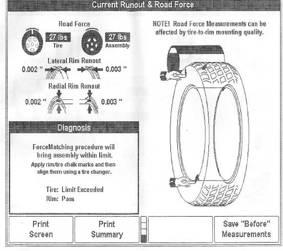

Have you seen the readings or the printout from the Hunter machine? It will tell you the radial runout for the tires and rims. It will pass/fail the tires and the rims each separately. If I remember correctly from Gadget's webpage on this issue, if your road force reading is more than 15-20 it will always be felt:
http://www.gadgetonline.com/vibration.htm
This seems to affect some trucks worse than others. Sounds like you are in the same boat as I am. I know how frustrating it can be. Good luck with yours...

You should get some kind of report from the place that Road Force balances your tires that looks what I have attached below. It will tell you whether or not your rims pass, the radial and lateral runout, how much road force your tires and tire/rim assembly puts on the road, and whether or not your tires and rims pass the Road Force and can be balanced. Anything over 27 is marginal and you will feel it. This printout is only one of three pages you should get for all 4 tires. Let me know if you have any questions
Attached Thumbnails Still Fighting 60+ mph vibration...Give me some possible mechanical causes PLEASE...-hunter2.jpg
