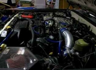

There will be a few more small parts that I will add as I go and compile a final list. Below I have taken a few before pictures and of a few parts that have arrived so far.

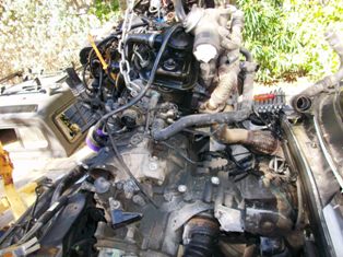

I have made a bit of progress, I have pulled the donor engine out of the passat and started to prepare for installation into the Toyota. Everything is going real smooth so far the fly wheel came off with out any problem, the adaptor plate bolted right up, and the new flywheel and pilot bearing pressed right into place like a glove. ACME did a great job on the adaptor kit. I bolted up the R151 bell housing and it looks like it is all going to bolt right into place on the R150 no problem. I have been working on deleting the EGR system by unbolting it and making a block of plate on the exhaust manifold. I will also be modifying the intake manifold by cutting of the area that is facing towards the back of the engine and has the EGR valve in ling, it looks very restrictive and as I have read, it will end up clogging up the intake manifold as the diesel soot and crank case venting makes for some nasty plaque build up that leads to power loss. Also, I will soon start on moving the oil pan drain to the rear of the pan, as I have seen from others that have done this swap, the stock oil drain will end up on top of the front differential. There is a nice flat spot on the back end of the oil pan ready for an oil pan drain to be put in. Now just waiting for the mechanical injector, pump water pump and looking for a non A/C water pump pulley and a couple shorter belts as I am getting rid of the VW a/c pump since the pump will not allow the engine to fit as the steering box is in the way. I will be fabricating a bracket to use the original a/c pump that came on the v-6. Most people I have seen doing this swap don't do a/c, but it gets good and hot down here in Austin Texas and it is working great right now, you could make ice in the cab, and there is plenty of room on the drivers side of the TDI and a bunch of threaded holes from the original engine mounts to bolt on my fabricated bracket and it will easily hook up with a longer v-belt pulley which will be tightened with the power steering pump.

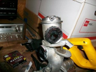

Also took off the intake manifold to start my modification cutting off the section that contains the EGR valve, to provide for better air flow and to keep the intake from clogging up. I had a big surprise as I removed the intake manifold which was enough oily soot to fill up a large coffee cup or a coke can, I can't believe this engine was running as well as it was, restriction was anywhere from 1/4 to 2/3 clogged, and It was still pushing the passat around pretty good. Once I clean this manifold and clean the head out with a bunch of seafoam, this thing is going to have some good power.
