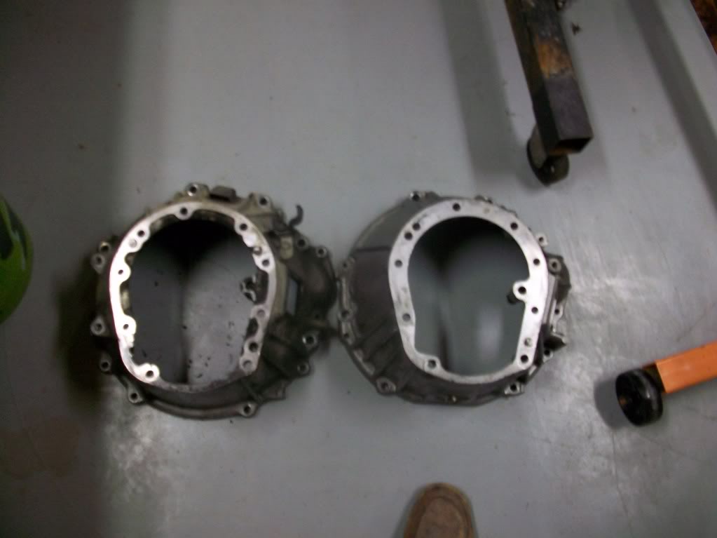

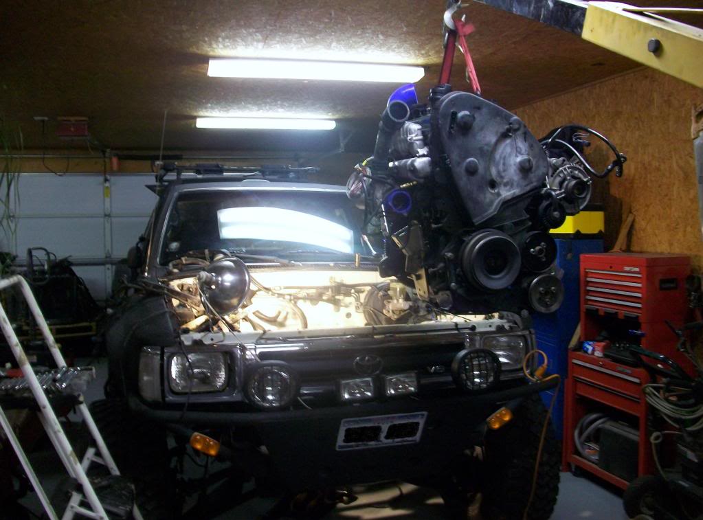

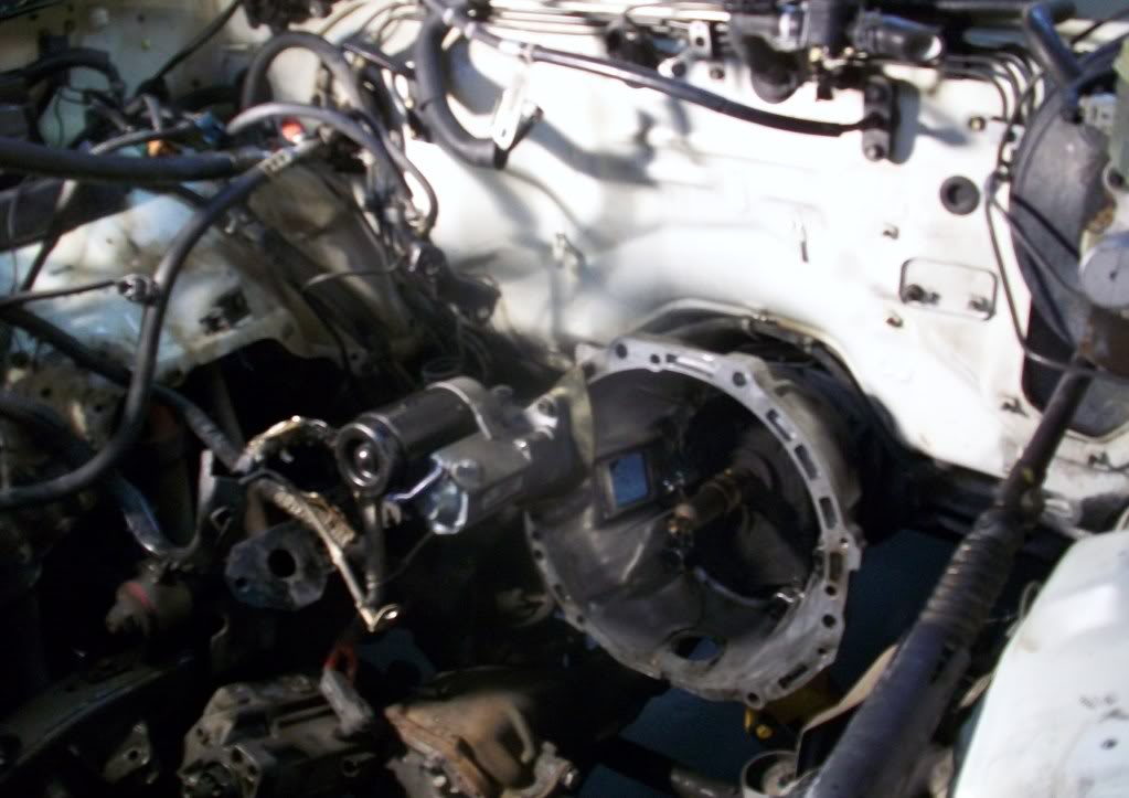

So got in the garage last night, pulled off the old bell housing. Put the new bell housing on and it fit like a glove, next bolted up the engine and everything looks great, tons of room on all sides to work on this engine when it gets bolted in, no clearance issues whatsoever. Now I just need to fab up engine mounts, fab up intercooler mounts, re-install the engine with the clutch on, and figure out the wiring and plumbing for the cooling system. Hopefully the injector pump shows up this week so I can get this thing running before school starts.

Question for you, what do you think about moving the tranny & tdi forward a few inches (moving the rear tranny mount and longer/shorter driveshafts)? I'm guessing that you did not do this.
I was just curious as some others (on the VW forums) had suggested doing this for better clearance for the engine. Wanted to get your thoughts on it.

Yeah, no modifications needed. Plenty of room all around, for example you can fit a 1/2" socket wrench between the engine and the fire wall to install or remove the bell housing nuts and bolts. This engine fit in there great. I am very please with this project, I can't wait to get it out of the garage, hopefully next week I will be dieseling around town.

How's your clearance to the front diff? I think that was the contact point these other guys were concerned about...

No problem with the diff and oil pan, plenty of clearance.
