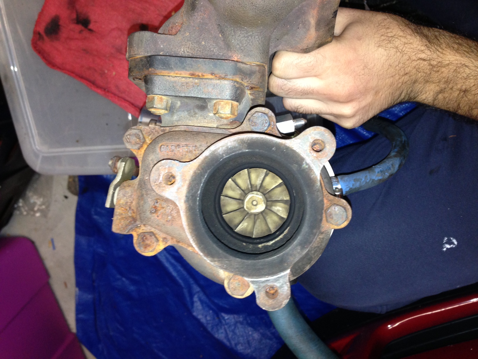

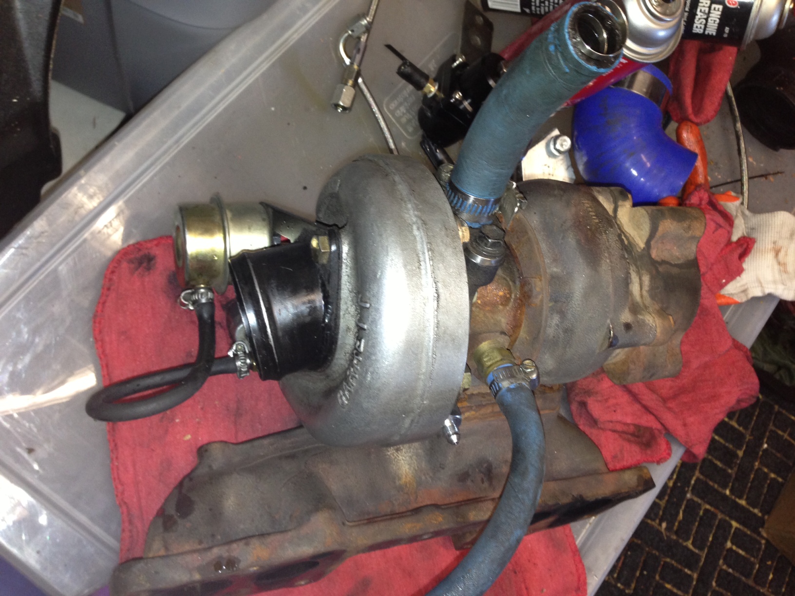

The offending turbo. no shaft play, but seems there are signs of oil getting into the exhaust side, mostly the black oily stuff and all white smoke all over the place. compressor side is dry surprisingly. I will take that as a good sign it probably is just got cooked oil in there I will go through and clean it out during the rebuild.
