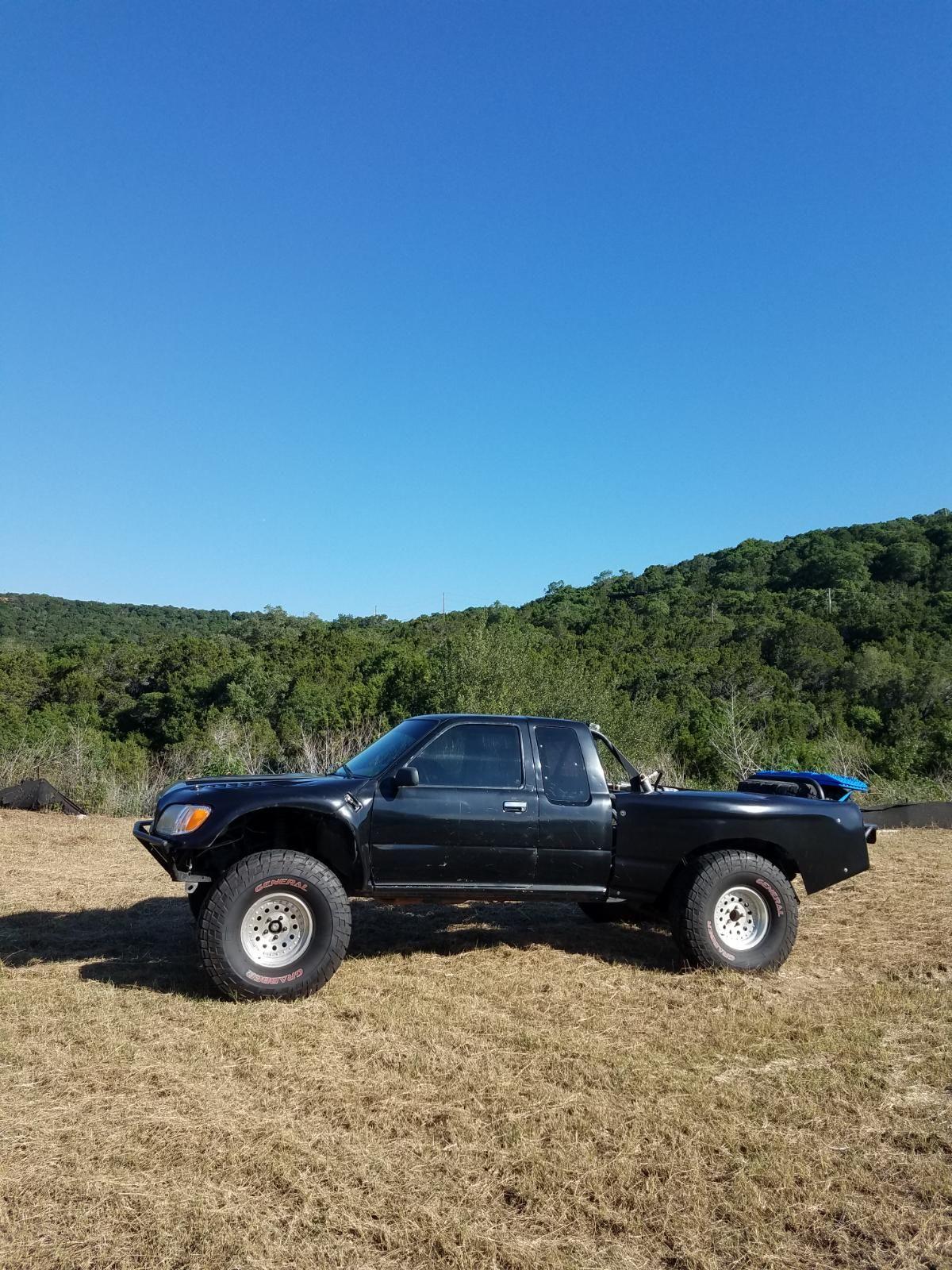

Been a while since i've been here looking for options as I just got started on my build I'm taking my time and doing it right but truck will be back in service. My rig is a 2wd 95 custom front a-arms with 2.5 14" race runner coilovers 2.0 bumpstops with king Kong stearing right at 18 in of travle the rear is deaver leafs custom hangers 18" racerunner triple bybass with a ford 9" 35x12.50. 22re 5spd.

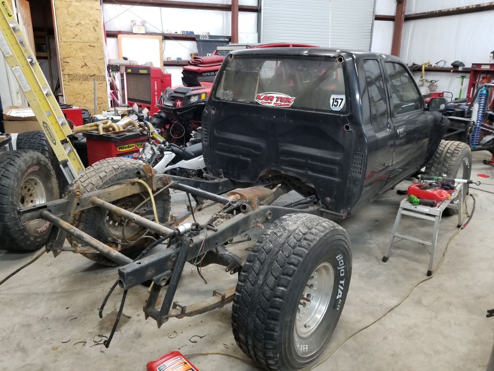

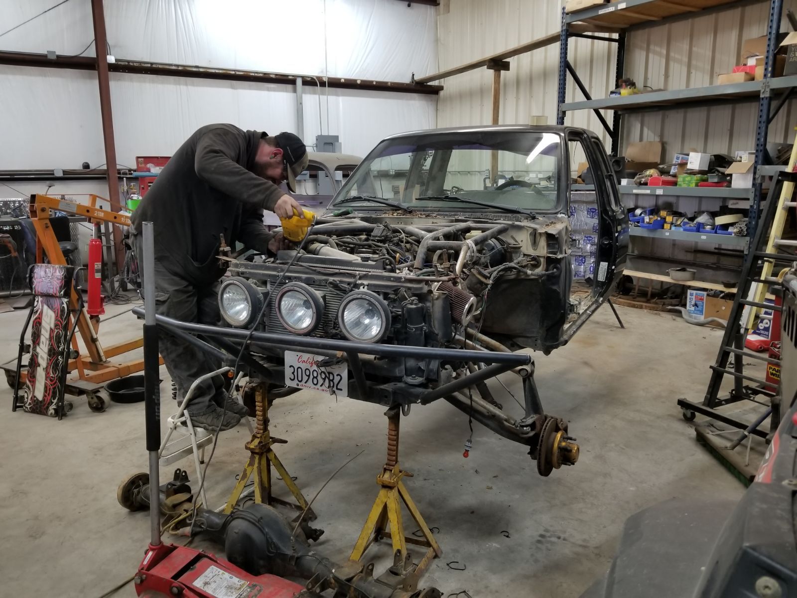

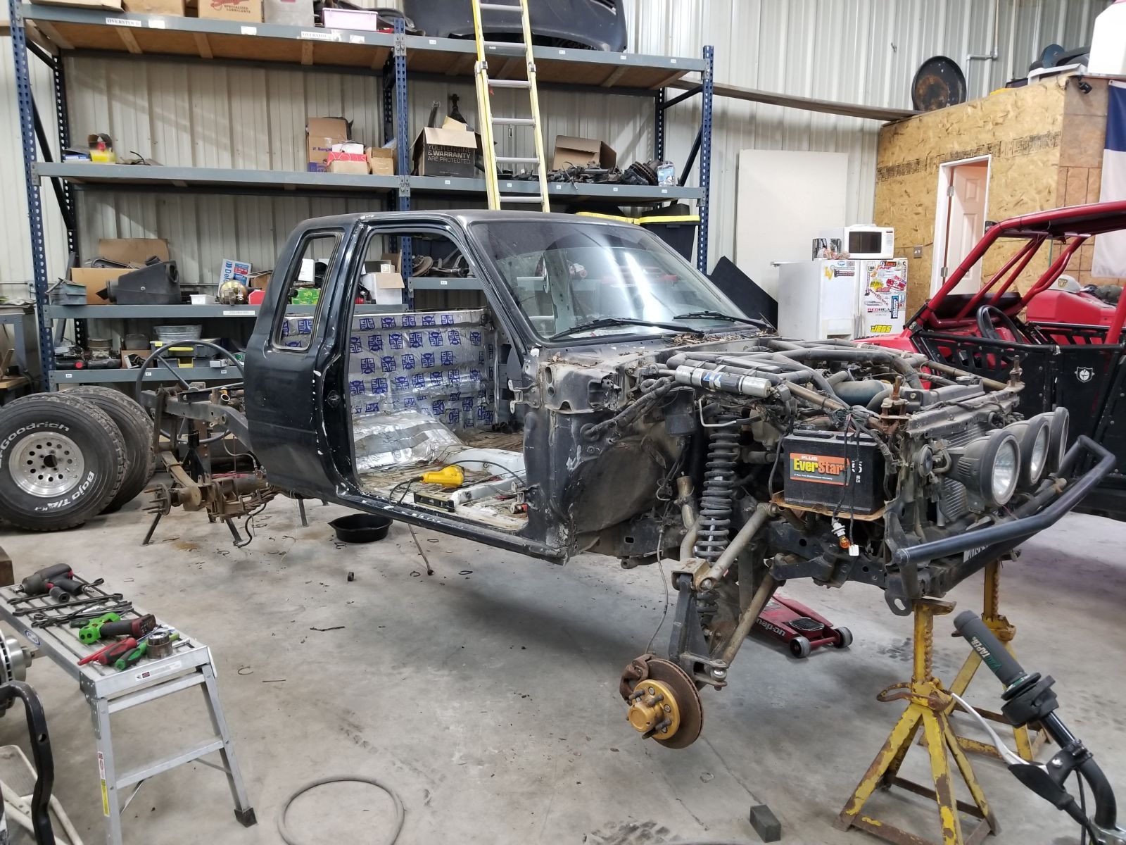

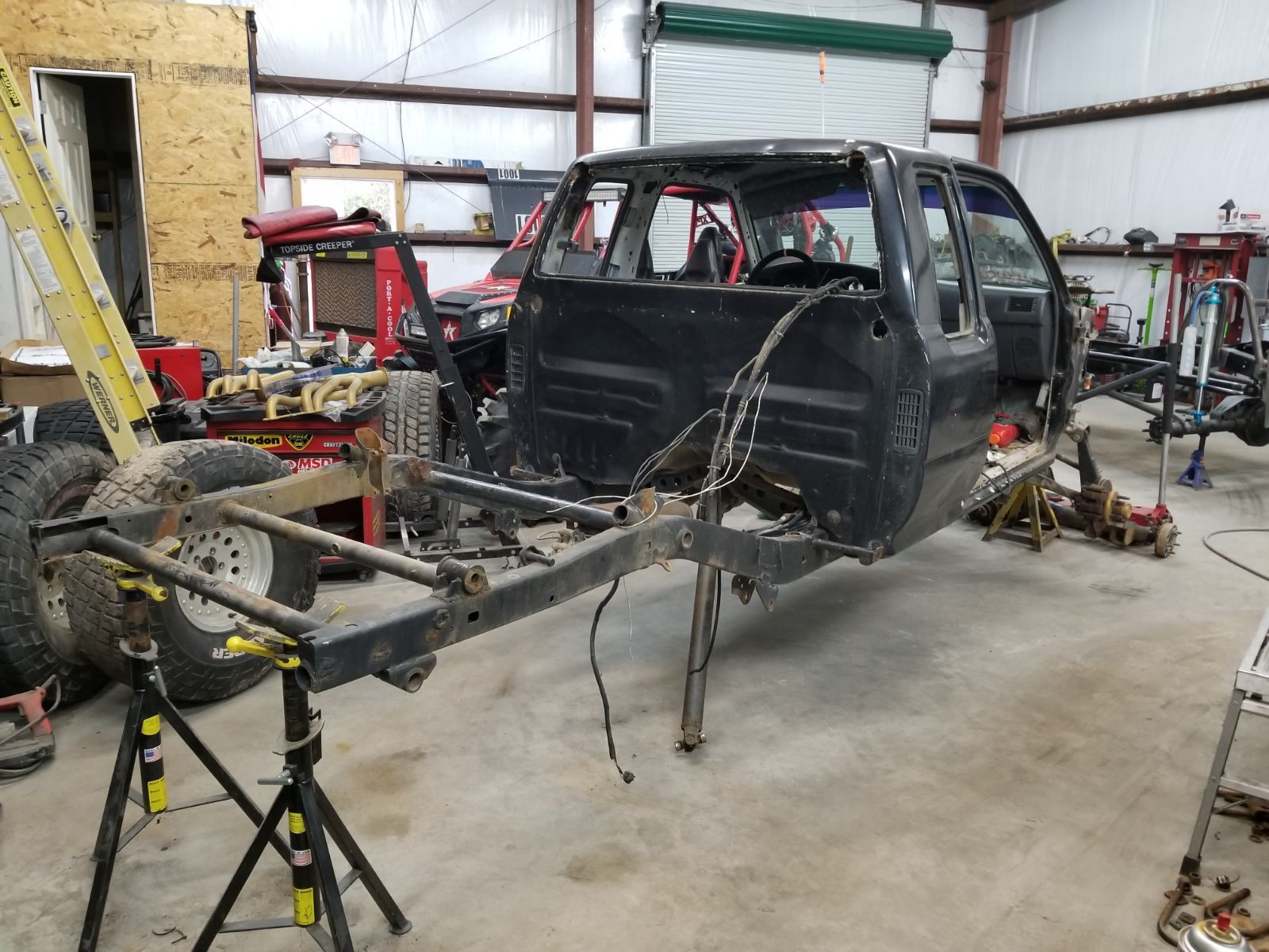

We cut out the old sub par engin cab and bed cage.
the rebuild plan is all new page full cage front to back 1 3/4 tubing except for the cab it will be 2" as I plan on using it to race the NORRA Mexican 1000. Front suspension will stau the same but we will be doing a backhalf with 4link (no need to change my screen name as my race truck is 3linked )
I bought a wrecked Tahoe with a 6.0 as a donor. And using a built L480e. Painless wiring harness
there's the background and plan now for the question. What are my options for keeping the heat and AC ? The yoata has factory heat and AC as well as the Tahoe.
just looking to get ahead rather hit a roadblock.
thanks for any advice
