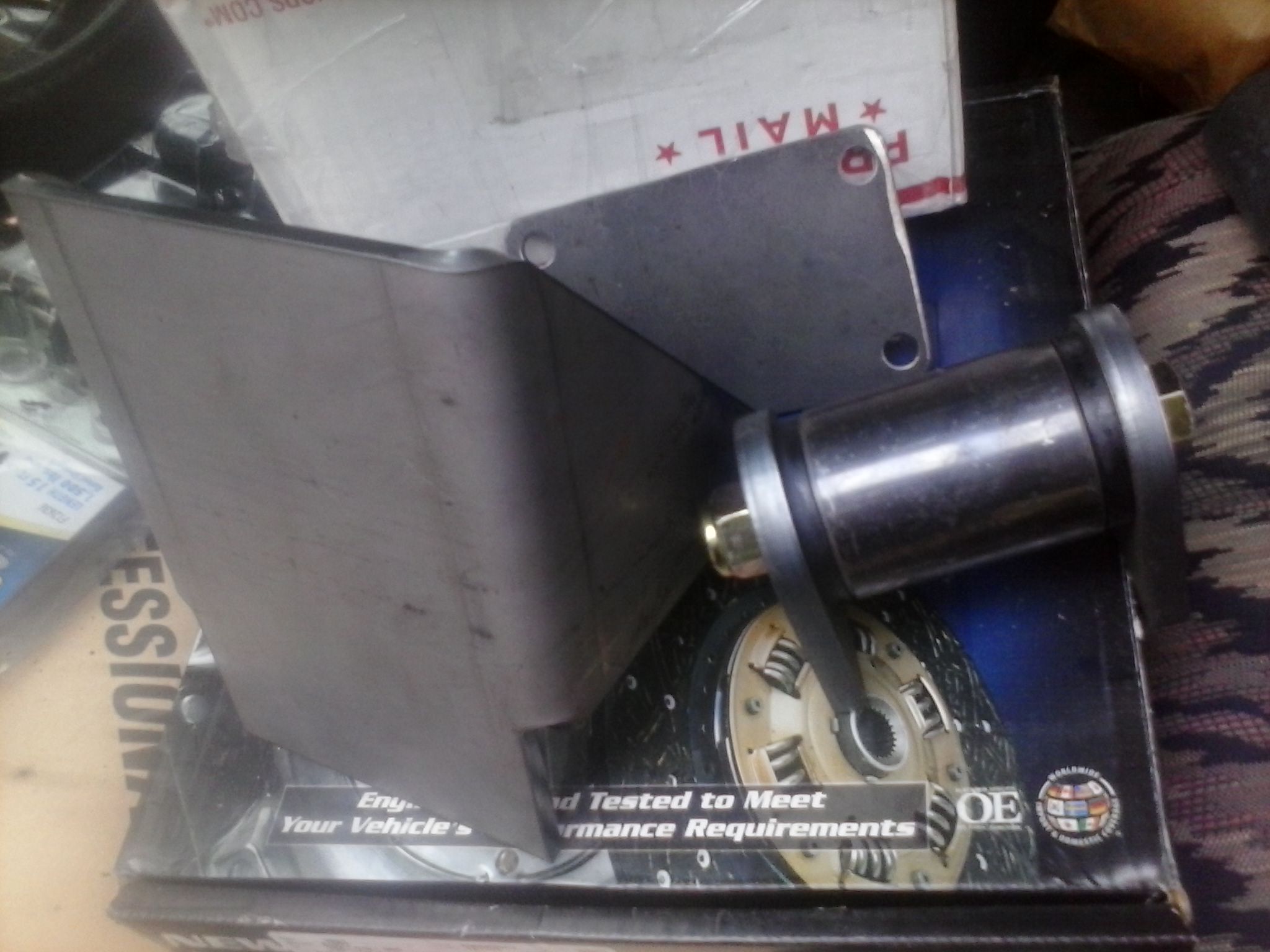

The engine mounts are;
http://www.ruffstuffspecialties.com/...g/XMEMKIT.html
Have also made some motor plates.

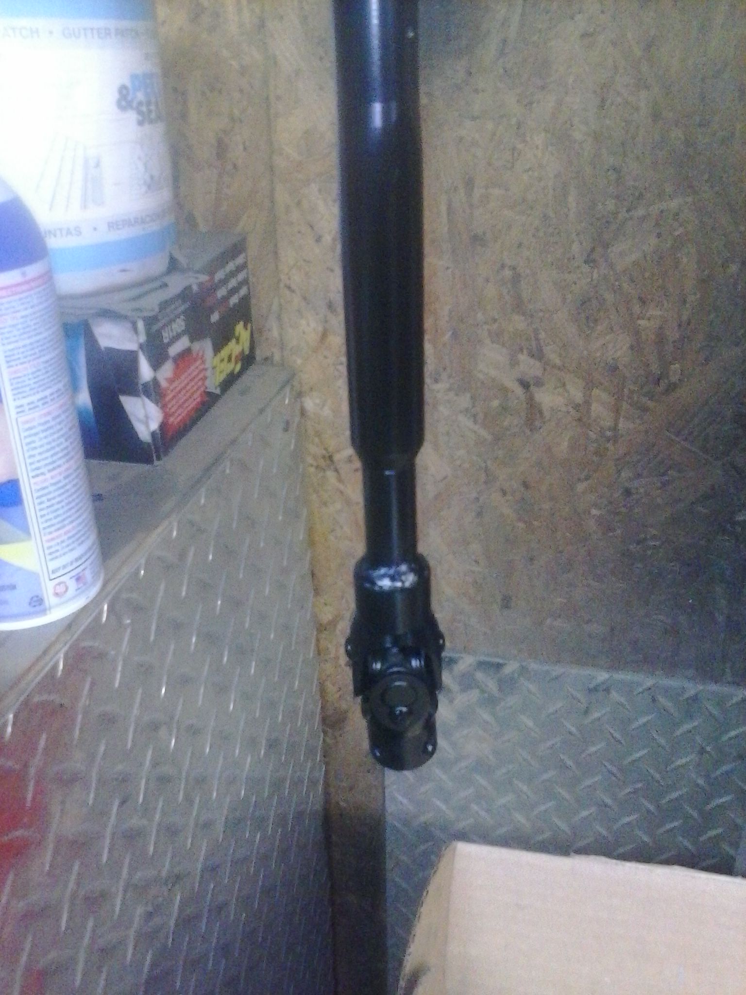

Steering U-Joint to remove rag joint and open up room for headers;
http://www.woodwardsteering.com/ Part number UA-108.

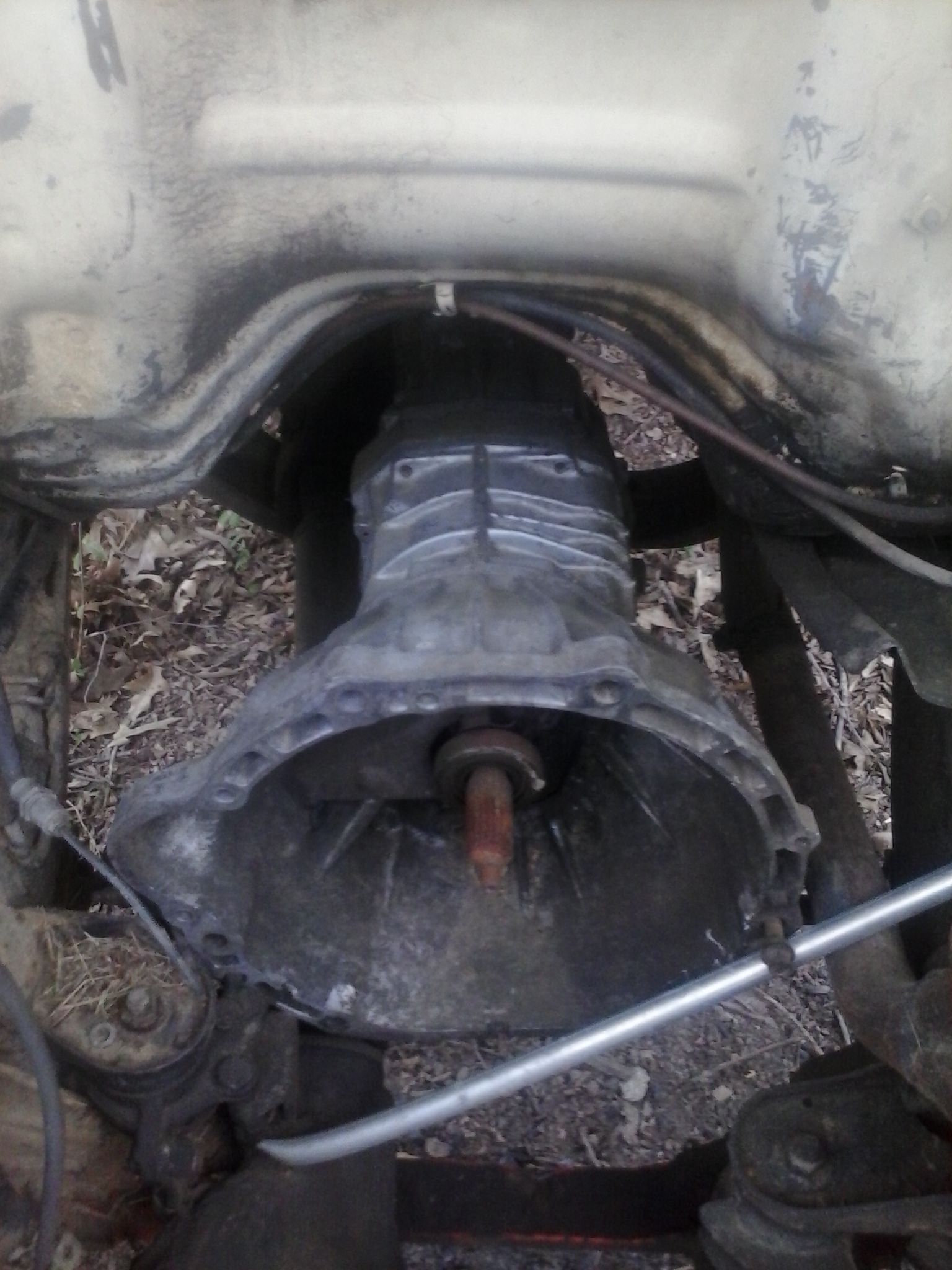

Clutch is a stock unit from O'reillys for a 93 4runner.

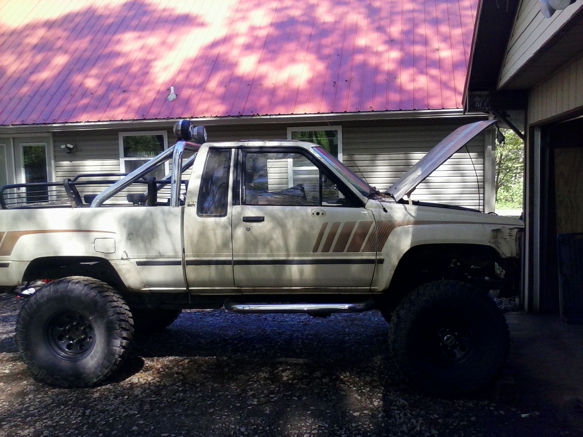

The truck has a 4" Rough Country lift kit and a 2" body lift. Body lift will be removed. 35"x 12.5r15 BFG KM2's on black steel 15x8. I will be rotating the upper intake to allow the use of a Snorkel. Also I will be cutting the front out of the grill not only to allow the ease of install but also to allow me to move the radiator as far forward as I can. I will probably have to modify the steering damper location and the oil pan to get it low enough with body lift removed!

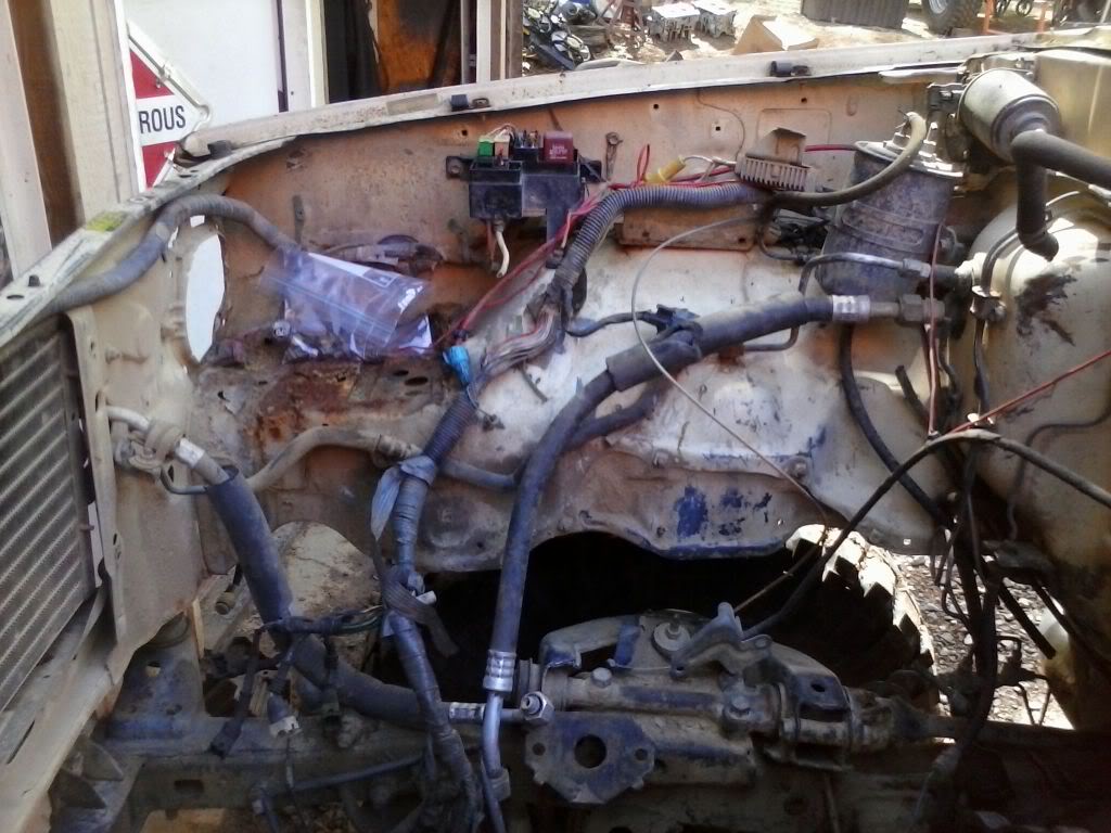

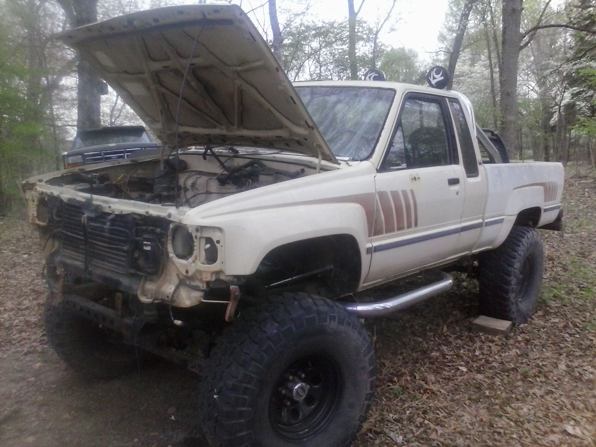

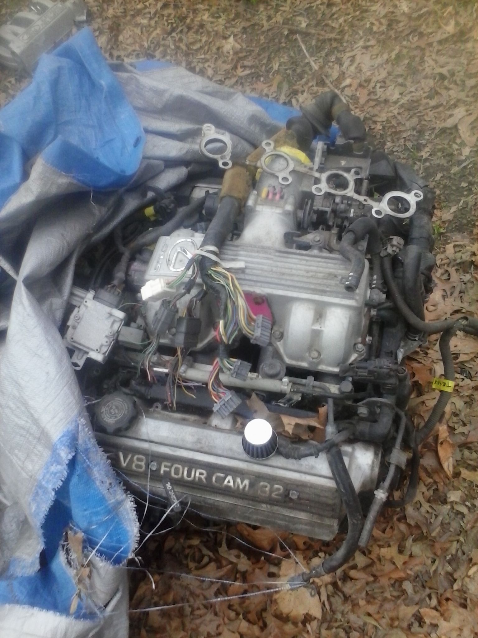

Some Pics!

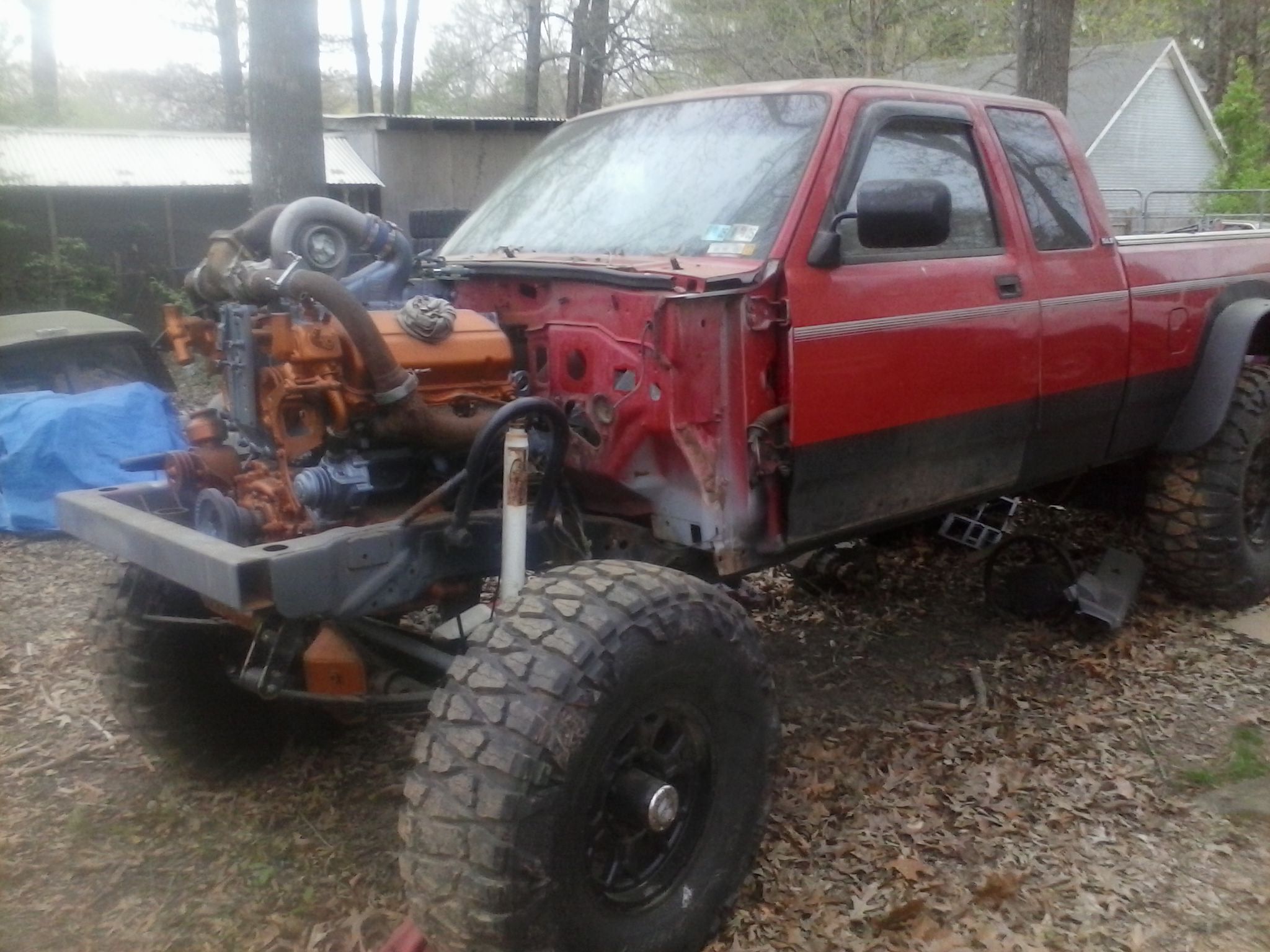

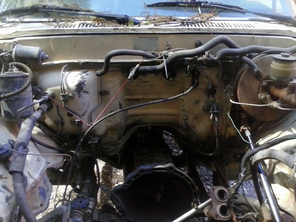

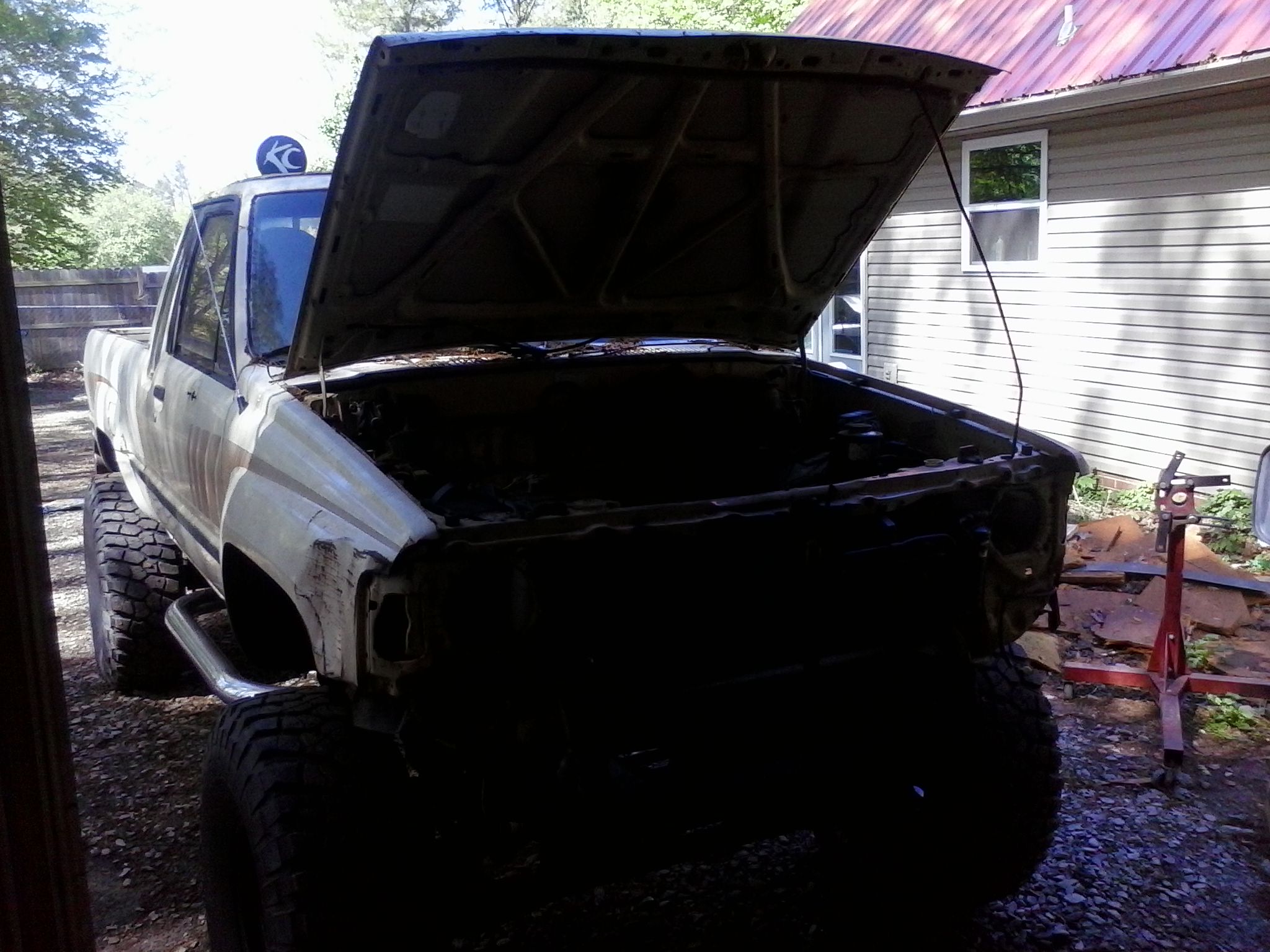

Some pics of the project so far! Hopefully the work will start next week.

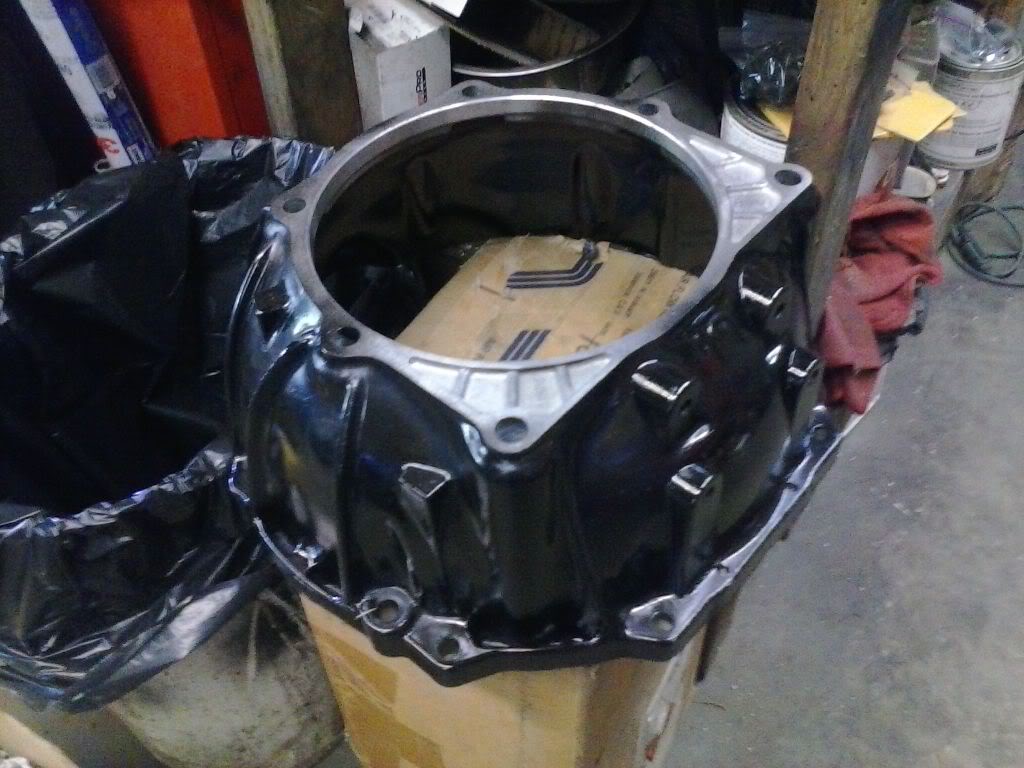

Attached Thumbnails Another 1UZ swap in an 87 SR5.-img_20140421_163455.jpg   Another 1UZ swap in an 87 SR5.-img_20140421_163520.jpg   Another 1UZ swap in an 87 SR5.-img_20140421_163614.jpg

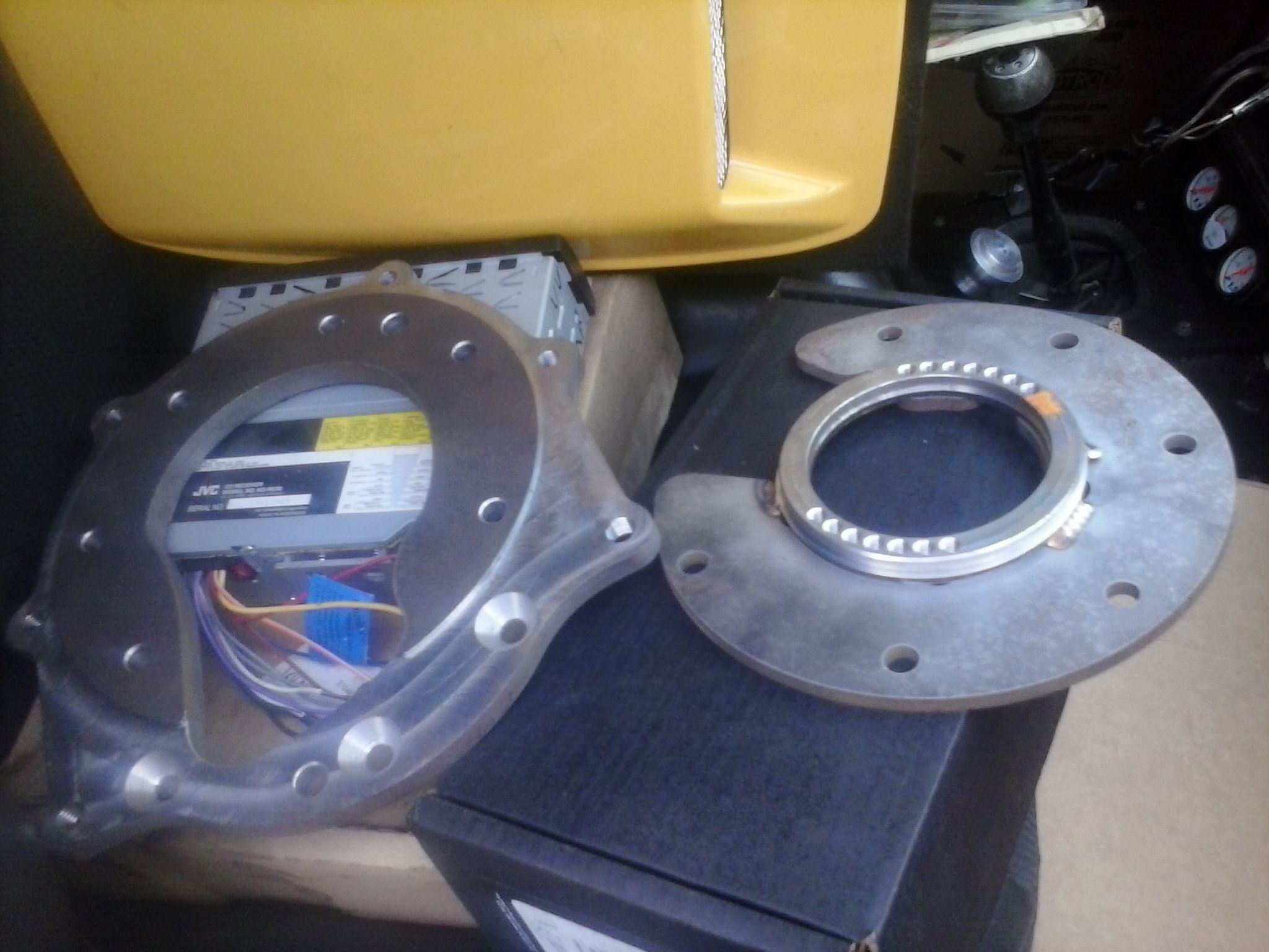

More pics!
Some more.
Attached Thumbnails Another 1UZ swap in an 87 SR5.-img_20140421_163636.jpg   Another 1UZ swap in an 87 SR5.-img_20140421_163714.jpg   Another 1UZ swap in an 87 SR5.-img_20140421_163826.jpg

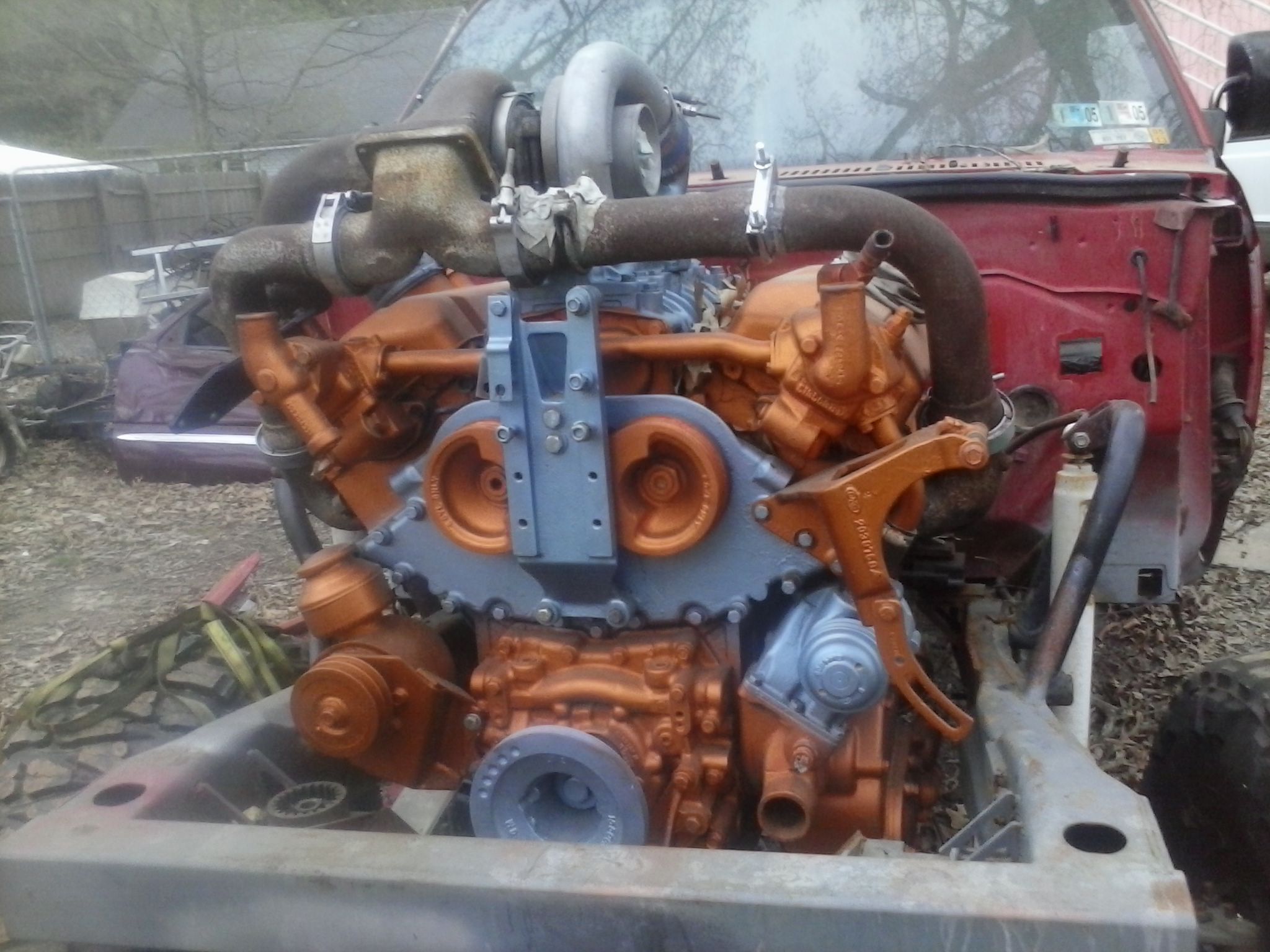

Another engine swap I am doing!
Sorry not of a Toyota but interesting all the same.
Attached Thumbnails Another 1UZ swap in an 87 SR5.-img_20140421_163533.jpg   Another 1UZ swap in an 87 SR5.-img_20140421_163539.jpg

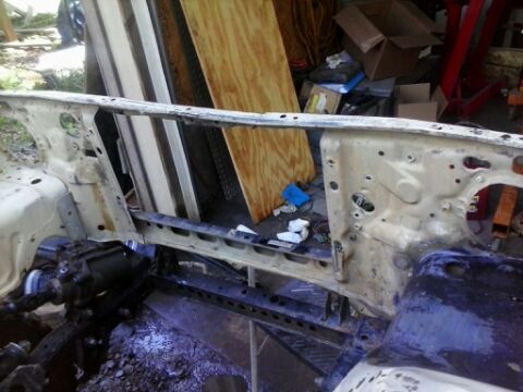

I am excited. First I will be cleaning and sorting out the truck. I will also be cutting out the front core support for easy access and modification for the bigger radiator!

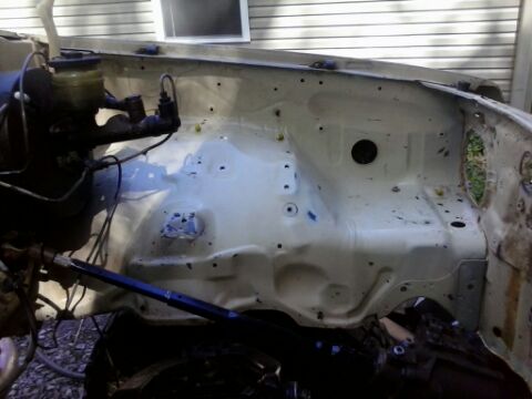

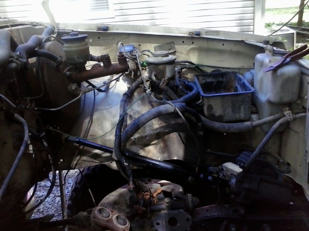

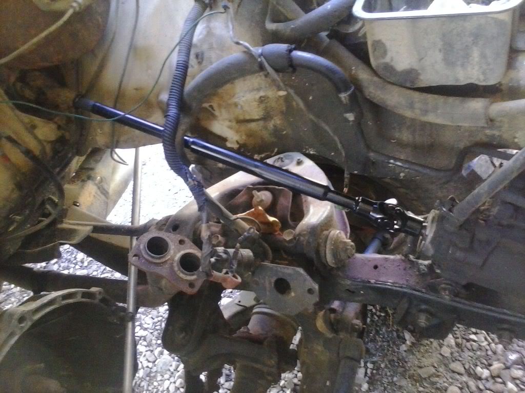

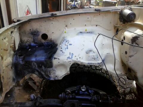

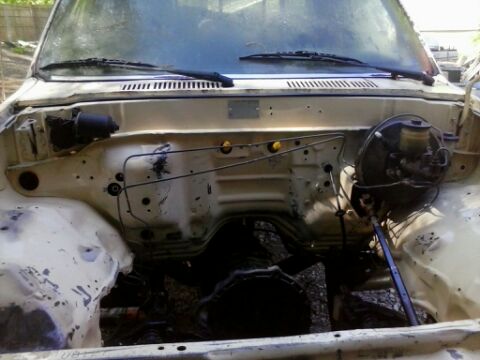

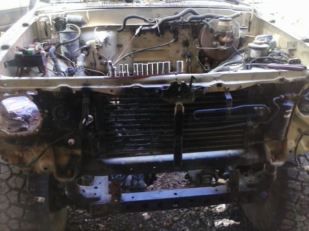

A few pics before I start.
Here are some before I started cleaning. Tomorrow I will post the results.
Attached Thumbnails Another 1UZ swap in an 87 SR5.-img_20140430_102418.jpg   Another 1UZ swap in an 87 SR5.-img_20140430_102428.jpg   Another 1UZ swap in an 87 SR5.-img_20140430_102440.jpg

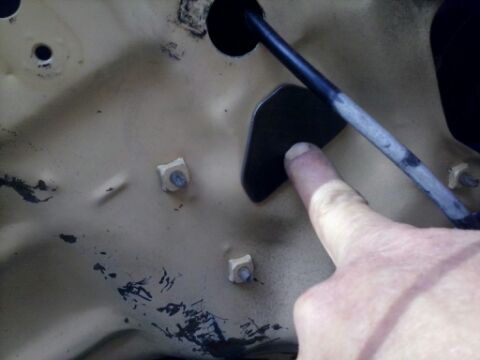

More pics!
Size:  103.6 KBName:  IMG_20140430_102458_zps32ea528c.jpg
Size:  100.5 KBName:  IMG_20140430_102513_zps4ab7707a.jpg

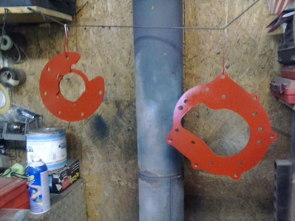

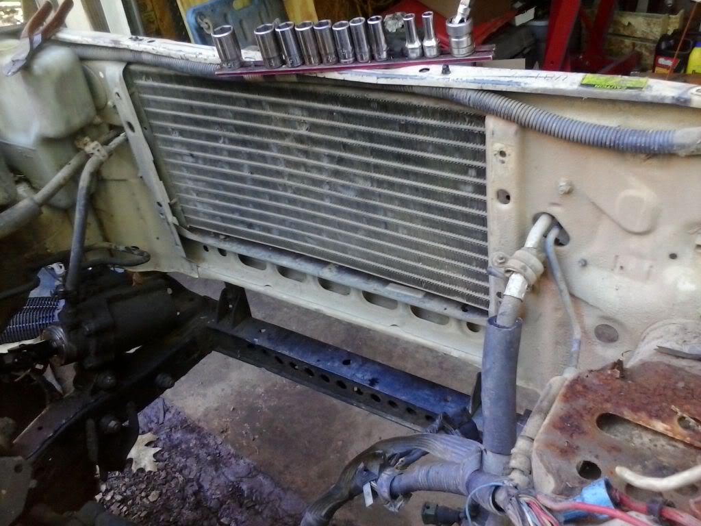

Progress Pics!
Size:  31.4 KBName:  output_zpspoopz7oz.jpg
Size:  27.3 KBName:  output_zps0udb8yru.jpg
Size:  35.7 KBName:  output_zpsyzwf3fxn.jpg

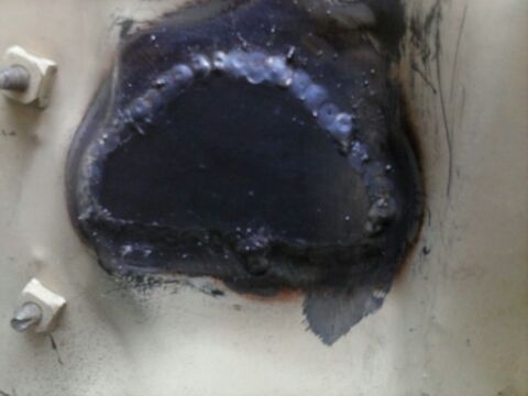

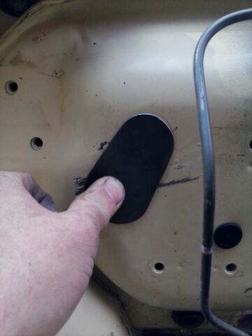

Holes filled!
Size:  17.7 KBName:  output_zpstlkn1spe.jpg
Size:  19.1 KBName:  output_zpsoqrnqhnf.jpg
