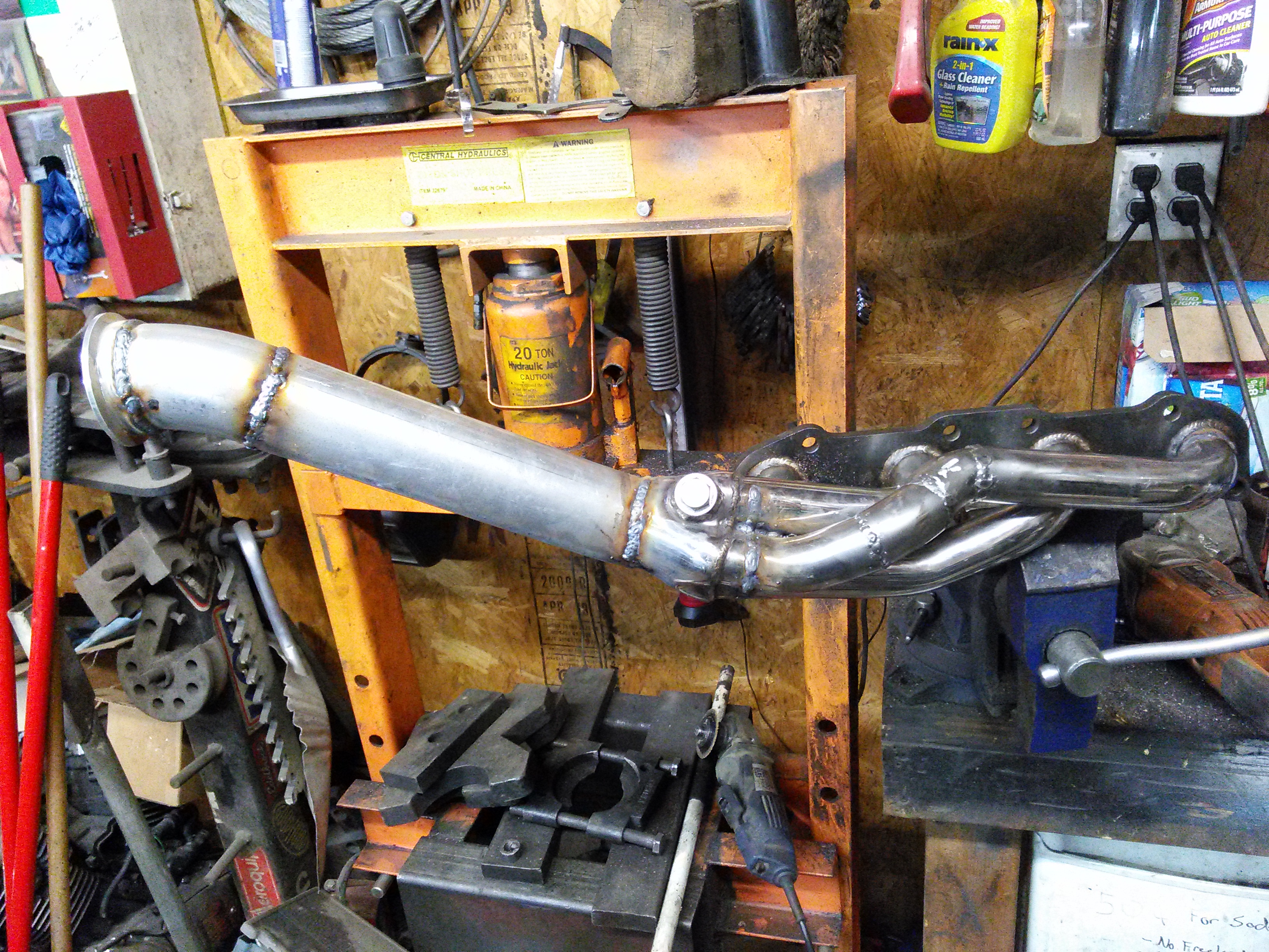

OK we are going again!
Got my headers in. I am modifying them. I will post pics of the mod soon.

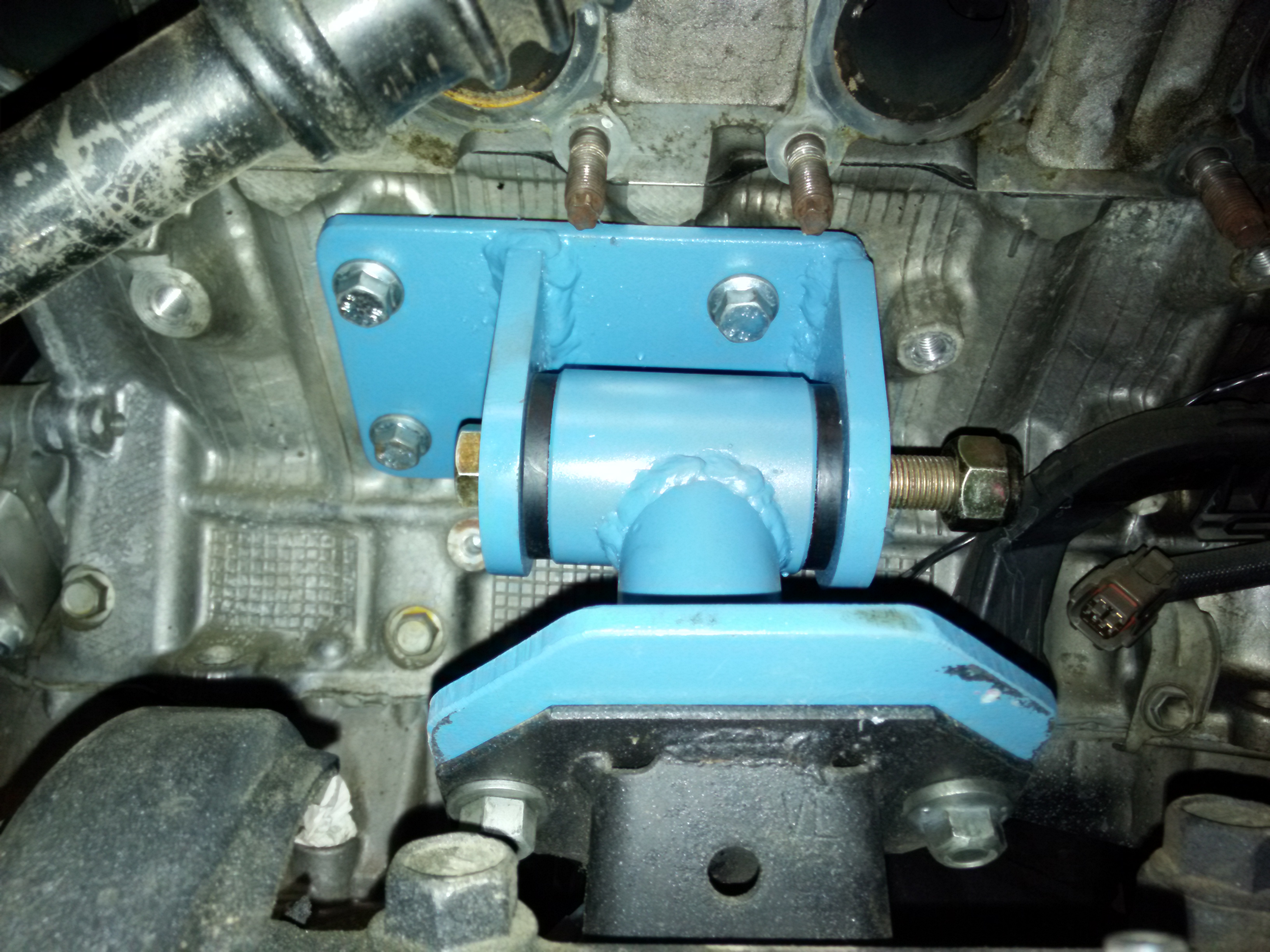

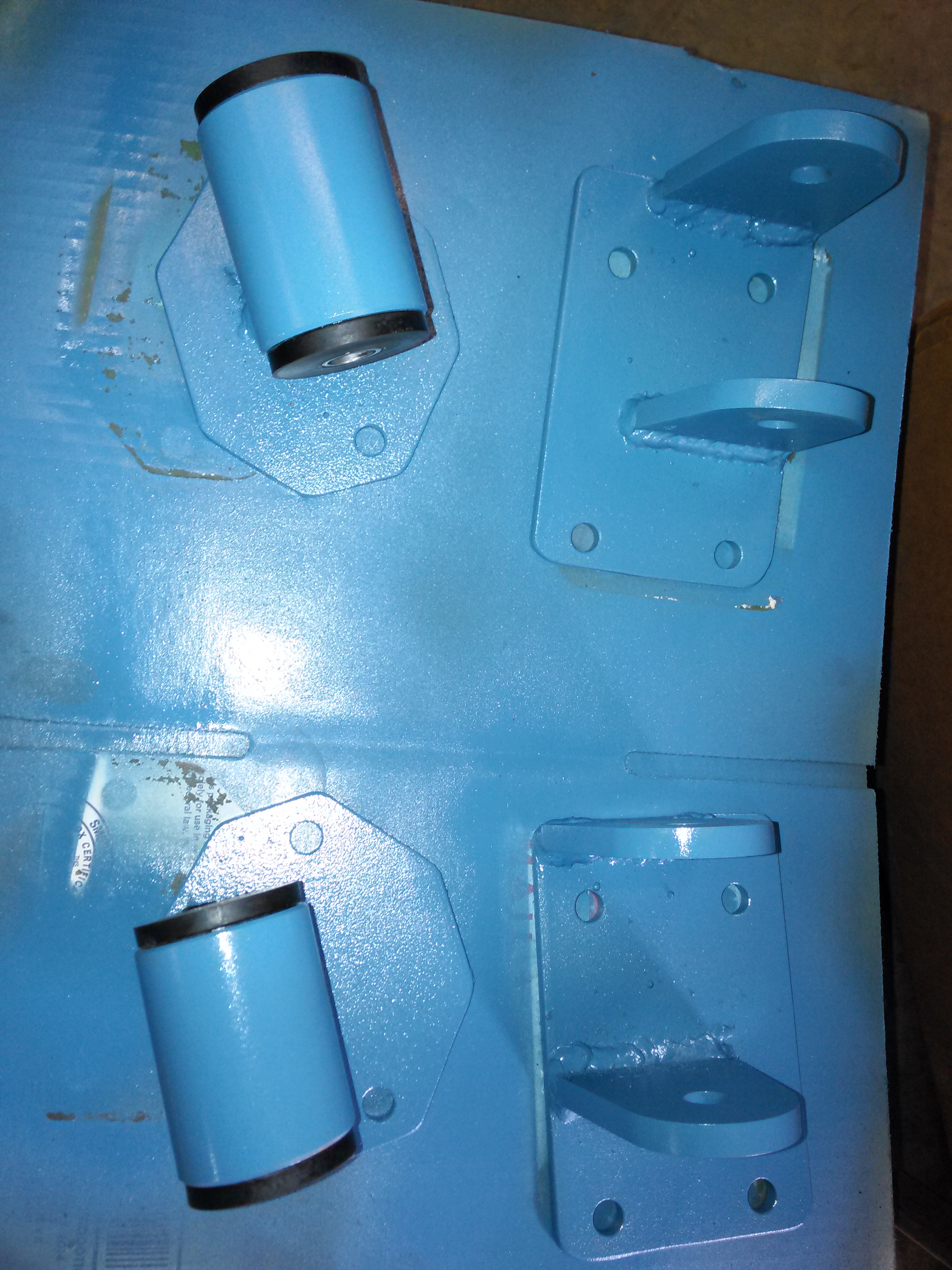

OK got side tracked by another 1UZ swap!
Our shop is doing another swap! It's in a 91! ECU turned out to be fried so we are using a Megasquirt MS3 with MSX! One good thing that came out of it that I made a set of bolt in engine mounts! Will be continuing with mine next week!
