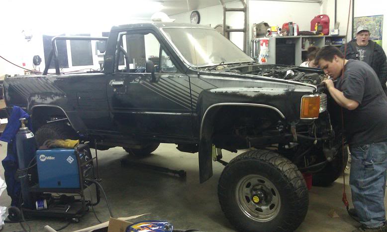

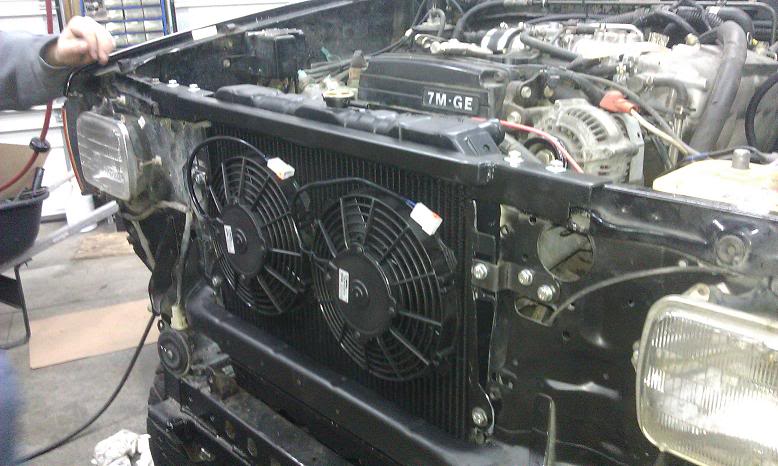

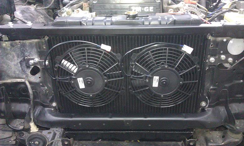

Well here's some shots of the beast as she sits right now. Just finished mounting the radiator/e-fans and final touches of the core support last night. Gonna try and start and build thread this weekend.
