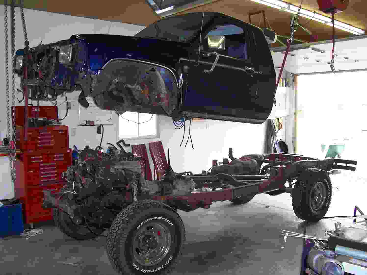

Your project is simular to mine
Hey guys,
Looks like your working a simular project. I am putting a 5.0 in my 84 SR5 truck. I am a little farther along with the engine but I've currently got my hands full with fixing the rest og the truck
You will have fun with the headers as they will not clear the frame. I cut mine and rebuilt them to make them fit. I also used the bell housing from North West Offroad and it seams to work out fine. The exhaust on the drivers side does come close to the slave cylinder on my truck so I had to make up a heat shield.
I used a flywheel from a mustang as I need the smaller balance weight. Finding a 187 tooth flywheel with 52 ounce balance weight used on later model 302's is hard and expensive! I just drilled and tapped a new mounting hole in the bell housing and mounted the starter closer to the ring gear.
Here is a link to my website...The site is not yet finished but I am working on it!
If you have questions feel free to contact me via the Yotatech site or my own
www.funfactorfab.ca
