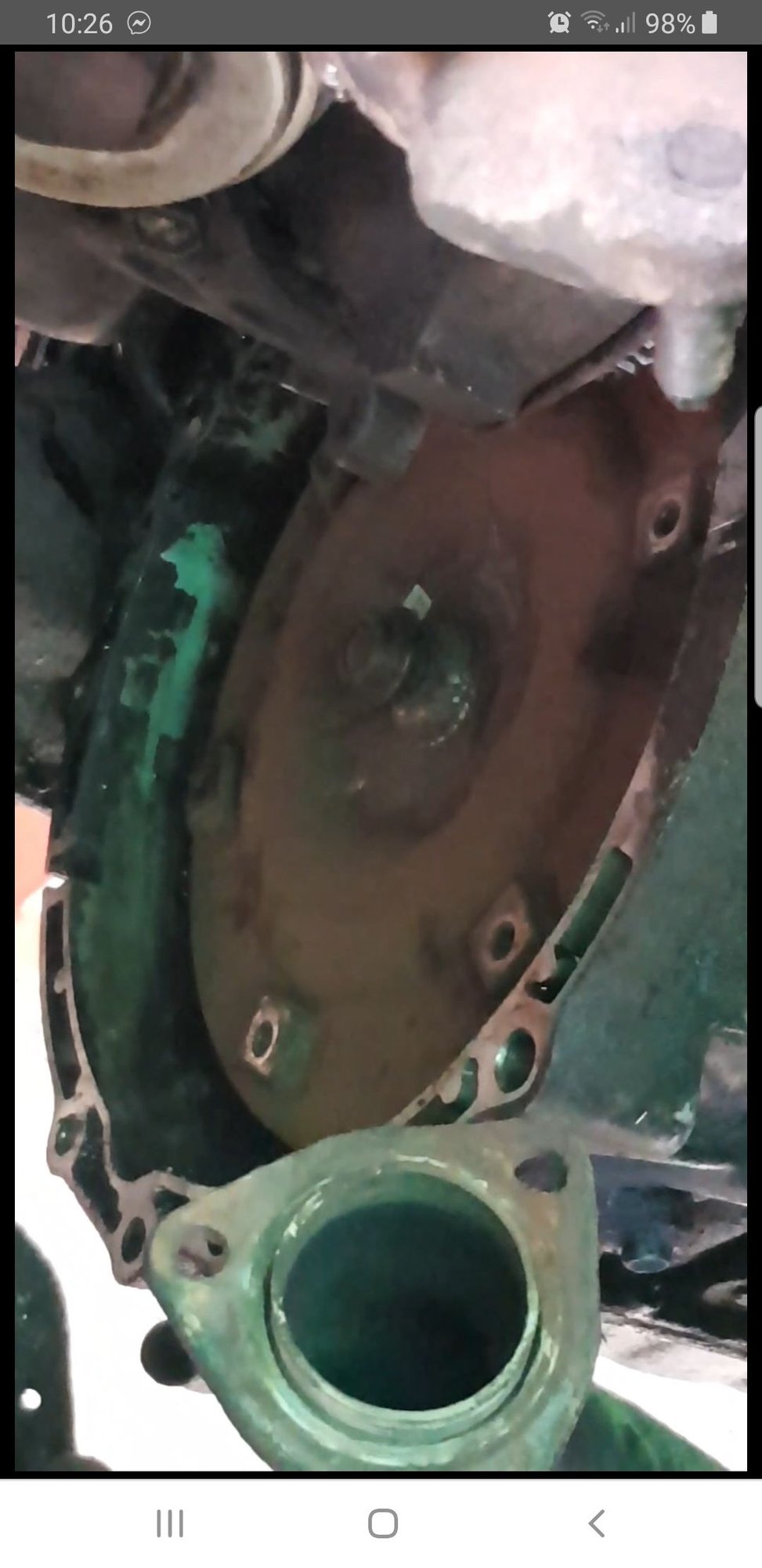

Thanks for your reply. however you do have to remove it. I didnt bother yesterday and I could not get the trand to line up, 1 side will get close to bolted and other side wouldnt, I removed spigot bearing and on 2nd attempted the trans slipped right in 😉

I didnt think so either. But pulling motor out and looking at the end of the torque converter it's clear as day what needed to go where. Good to know for future reference and hopefully my thread will help someone else. I attached photos showing the end of my trans 😝

Yep centering lug on TC, you won't be happy if you bent or broken this.
