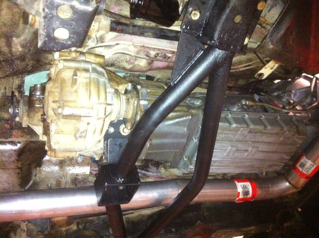

Got a pic with the front d/s installed? Looks like it will be close to the trans and maybe the exhaust towards the front

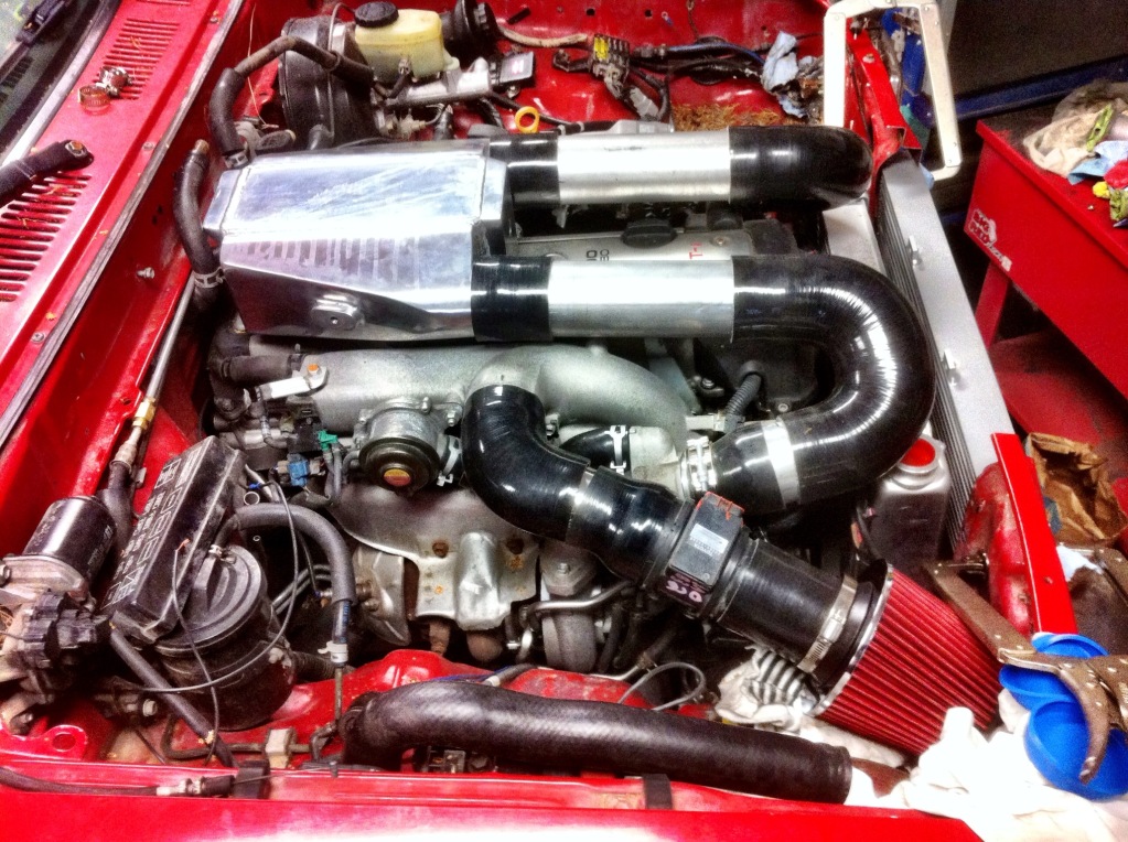

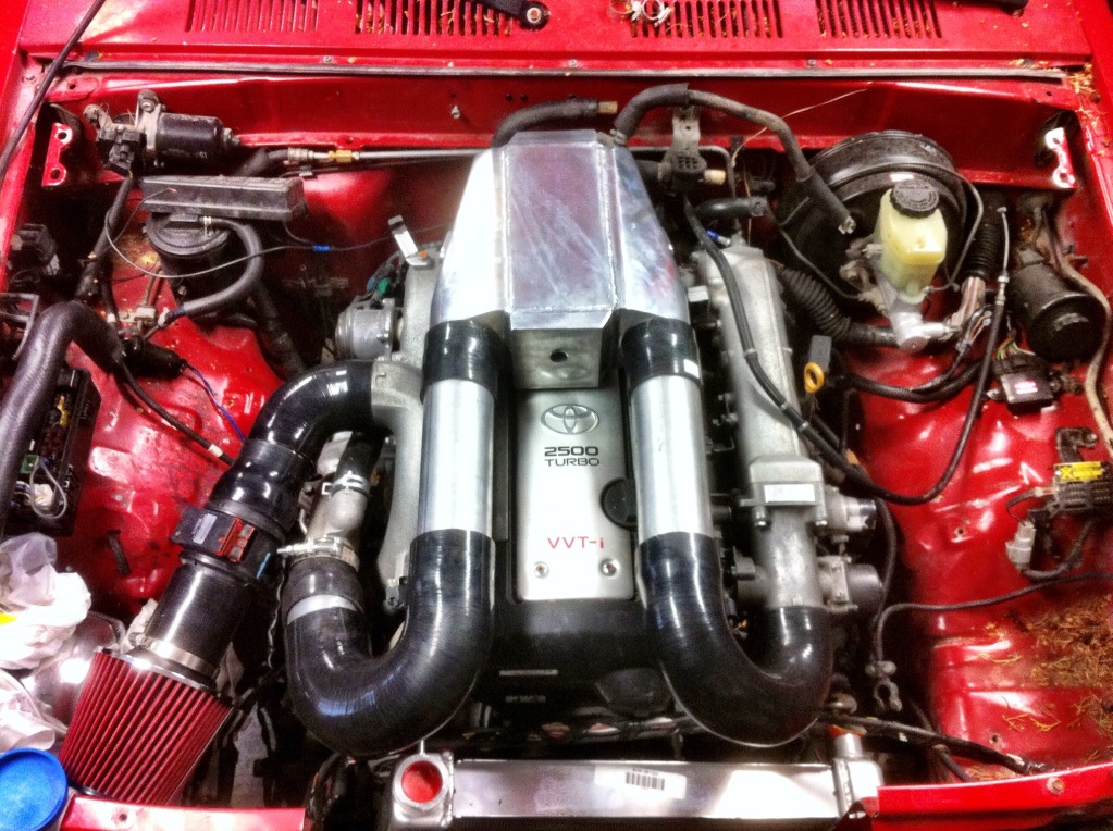

OMG... that is one sexy setup that you have in there.... makes me want to put one in my 2003 4runner and hook it up to a 5 speed auto.
How do you like the liquid to air intercooler so far? It looks like it has 2.5 inch inlet/outlet. Am I right?
Are you running fully stock minus the intercooler change?

It's a 3" in/out.. So far it's on it's first shake down week 1. I will post a clip of it driving and start up soon.. I'm getting the truck back next week to go threw it.. Leaks ect..

HOLY CRAP INDEED...IT REALLY DOES FIT!!!
But..can you say without a mm to spare?

I have A bit more info on pirate4x4. But yes motor is a tight fit. And MM count. Got a griffin rad from sumit-racing. Then modified the ˟˟˟˟ out of it. A wider thinner rad would have made some things a lot easier. But would have changed placement of some things.

I'll be interested to see if you have cooling issues at all. That's a pretty small radiator for the power levels that motor is capable of.
Looks damn sexy though. Sounds like it spools quick too if its making enough boost in neutral to open the BOV. Also sounds like a little compressor stall going on, time for a bigger or lighter BOV??
