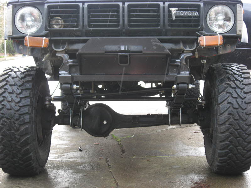

Here's my build with a old landcruiser front axle....and no brace.
https://www.yotatech.com/forums/f152...tacoma-283930/
