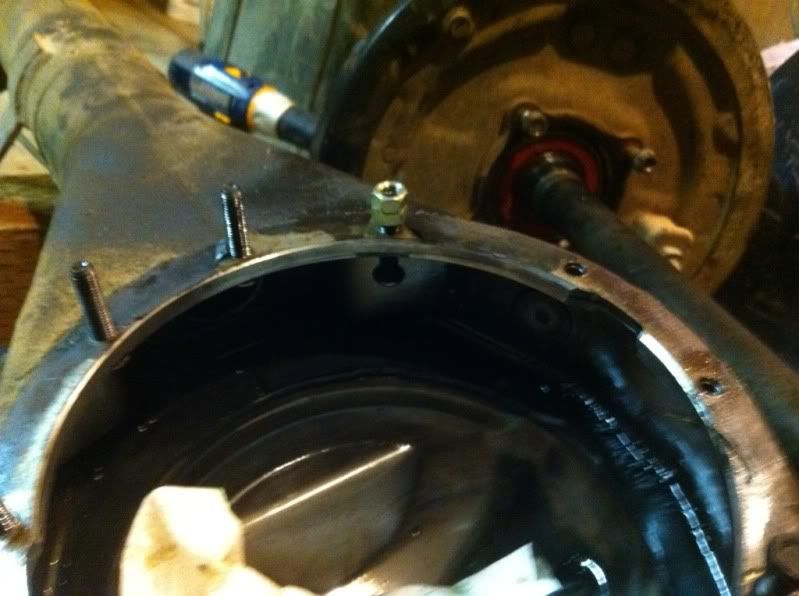

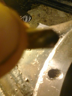

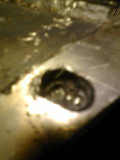

So I fd up this stud pretty bad and dont know if i have to scrap the whole thing or will silicone fill it up and keep it sealed or should i put JB weld on there then put the silicone on top of it. The pic where taken with my phone so they may suck ass. The Third pic is a drill bit and how deep the hole is so if i could get some help and if you want to bash on me about it go for it lol.

For those who still care to answer your look at the end result of a bad stud removal its started as a flat with the surface stud bolt i didnt punch it first and it turned into this horriable mess up see now i was able to drill through it but the stud remover broke off in the hole and when i should have stoped i just kept going to until nothing was happening. The three pics are the hole its self and by using a drill bit how deep it is I know these are kinda newbie questions but any help would be awesome.

Ill get better pics if i can but its a broken stud on my axle housing where the front diff bolts to the axle housing that ring. Would have helped if i said that before.

If that's on the upper part of the housing, you could probably run it if you accepted a little bit of a leak, but if that's on the lower part of the housing, you'll need to drill it the rest of the way out, probably fill the hole with weld, then drill and tap a new hole.
Have you got the other studs out? If not, don't use that method again, whatever it was. Try double nutting the rest.
