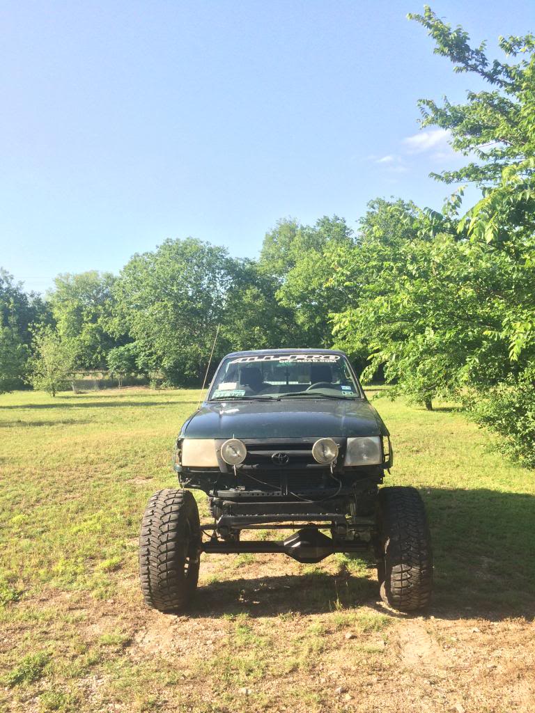

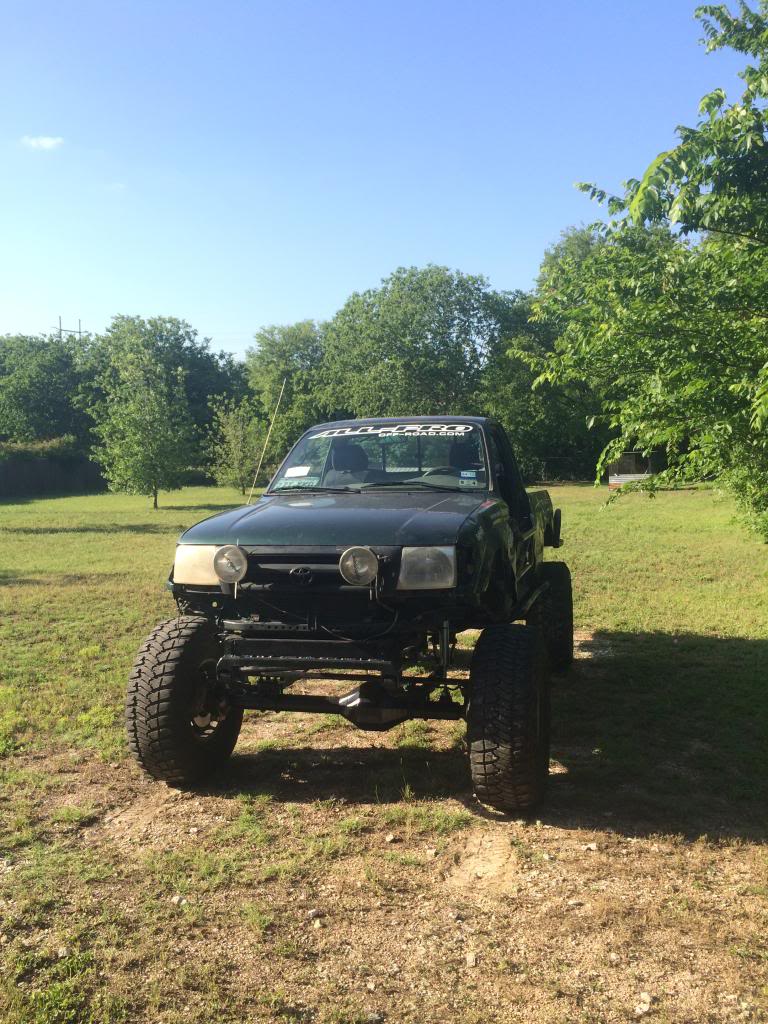

In this first one I'm loaded down with all the old IFS, the front bumper, fab gear, etc. The rear was sagging a little bit.

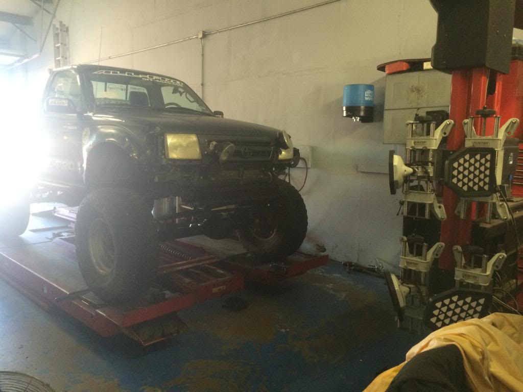

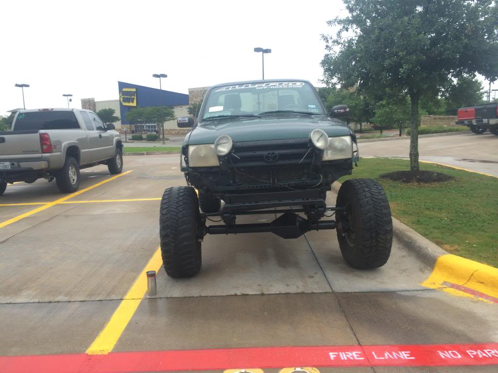

Got the truck aligned today. I knew it looked funky. I thought I set the toe at 1/8" in but the tech said it was toed out. I think my "floating" Tacoma rotors threw off the measurements some. After the alignment I got it up to 70 with no death wobble and a lot less wandering. The only vibe present is from my rear drive shaft due to a worn slip yoke. The vibe was present before the swap, though.
And before anyone says anything, I have a full tank of gas. My gauge is broken.

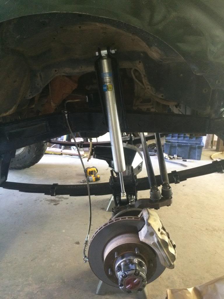

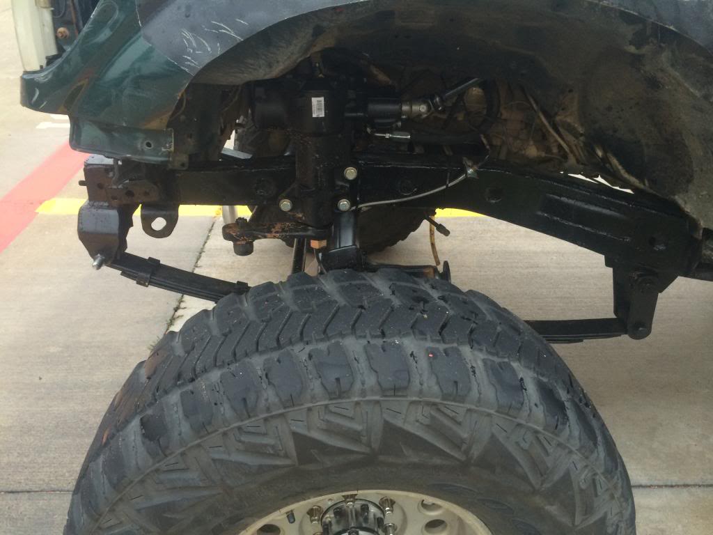

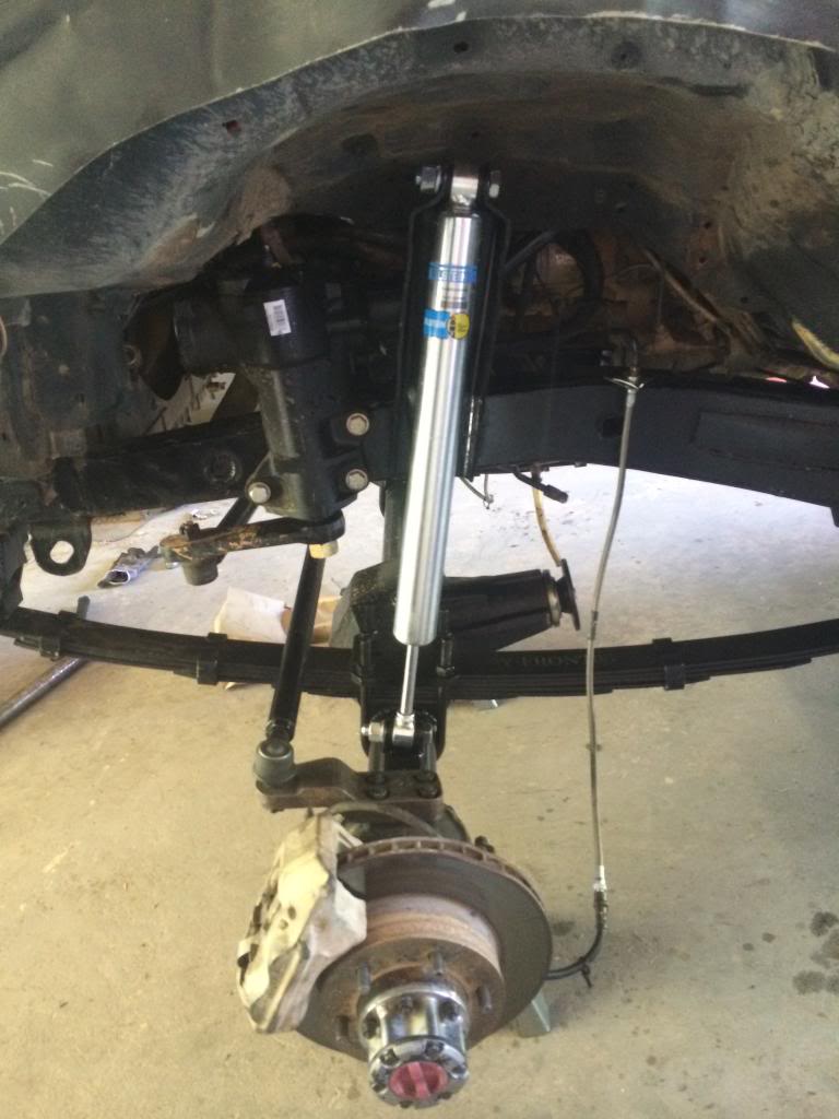

Finally got the shocks mounted up today.
I was given a free pair of 12" Bilstein 5125's by a good friend. They ended up being too short. Another friend of mine had a pair of 14's that were too long for his truck. We ended up doing a straight trade and we're both happy.
I drove home 20 miles on the freeway and man, the truck drove like a brand new truck again! It was awesome! I'm fully in love with this truck all over again!
The ford shock towers were perfect. No cutting the inner fenders. There is about a 5* difference in the angle of the shocks because the steering box was in the way but, that's no biggie. It won't be too hard to get the box out if/ when that ever needs to happen. I'll simply need to turn the steering shaft 90* to get at the lock-nut from above. It's all good!

This coming week I have a couple last minute things I need to do to get the truck ready for K2.
I need 1 more birfield snap ring, drive shaft hardware for the front, hardware for the halfmoons on the back of the axle, and hopefully get some front bumpstops. I've got the material for the front bumpstops but I don't have any actual bumps.
Other than that, this thing is almost 100% again!

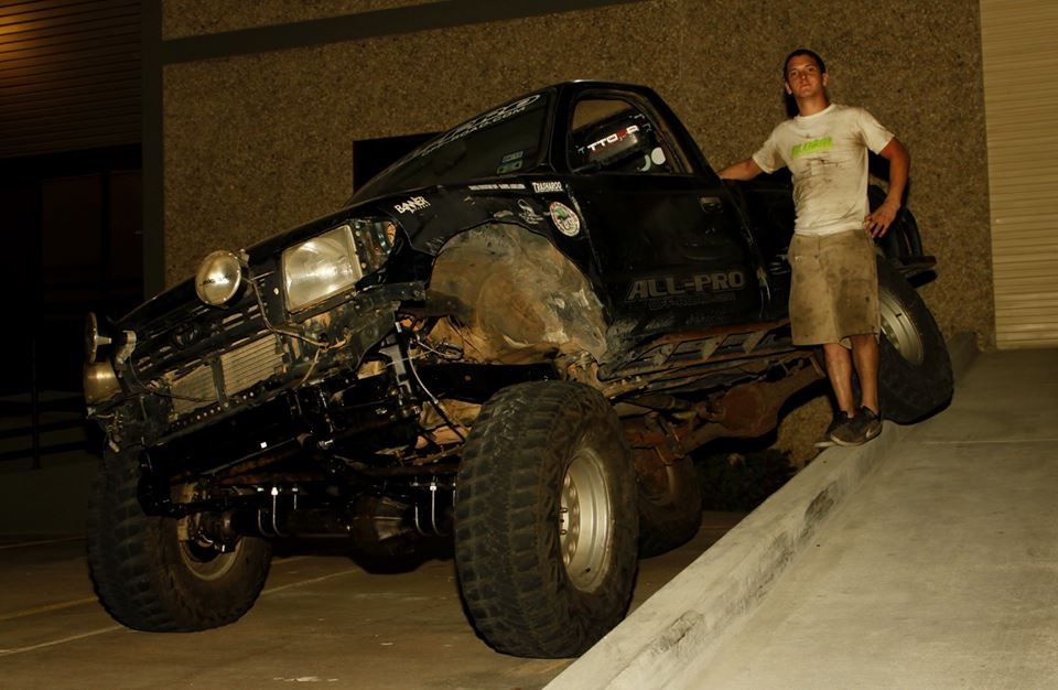

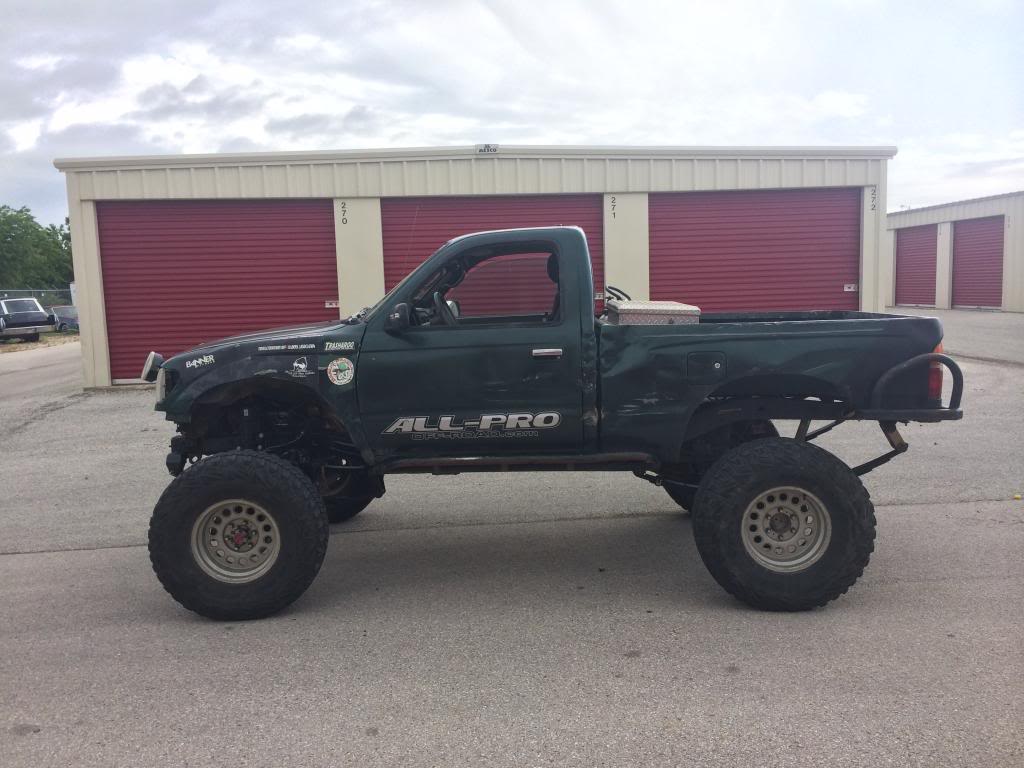

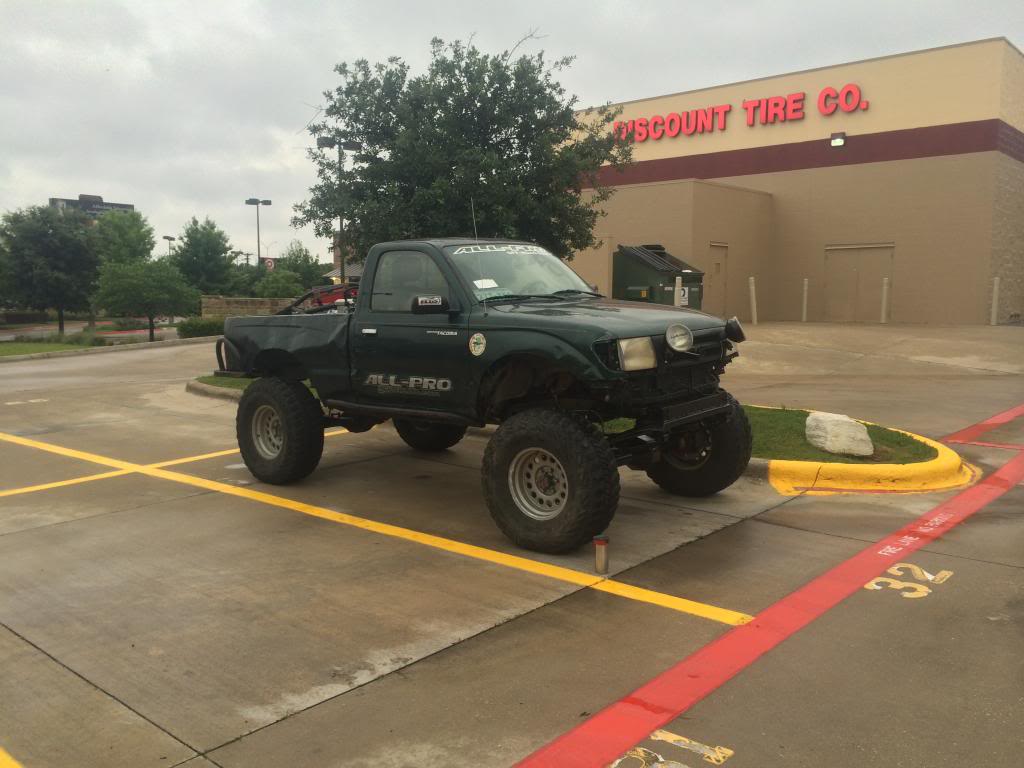

Over the past few days I had a few things left to button up before this coming weekend at K2.
I got the bumpstops, knuckle felts and wipers, steering stops, driveshaft, and birfield snap rings installed.
It's basically 100% now.
No close up pics but here are a few others from yesterday and today.
Full width probs.

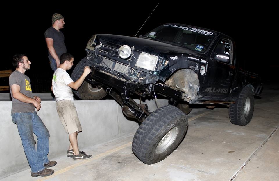

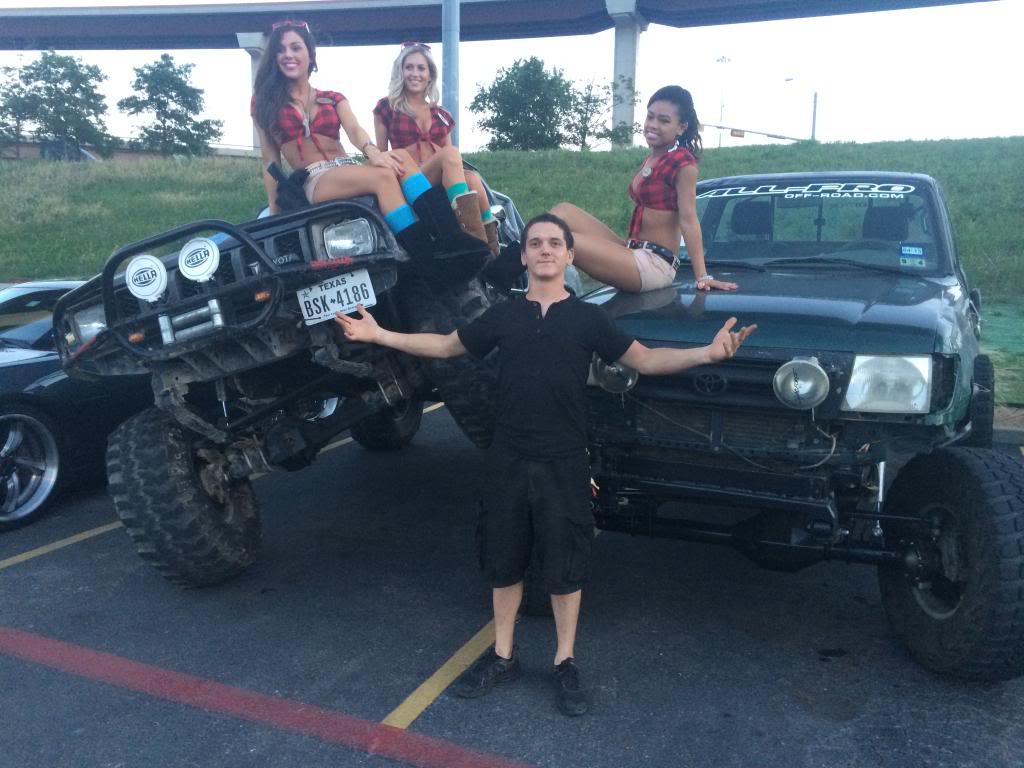

Worked on getting Andy's 4Runner done tonight. His cab chop is almost done (but ready for the trail) and the hydro assist fully installed.
I'll try to get some pics up over the weekend.

Originally Posted by dropzone
did you get your front d/s yet?
Yeah, I typed that in the last post.
How else would I have been able to climb that tire?
