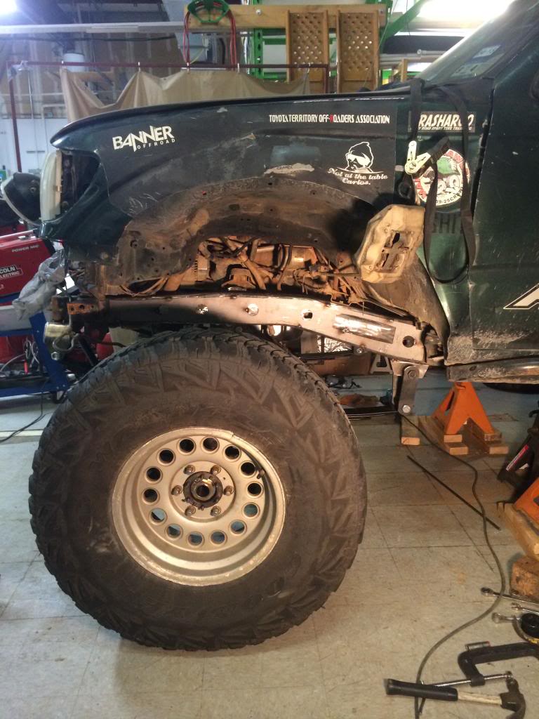

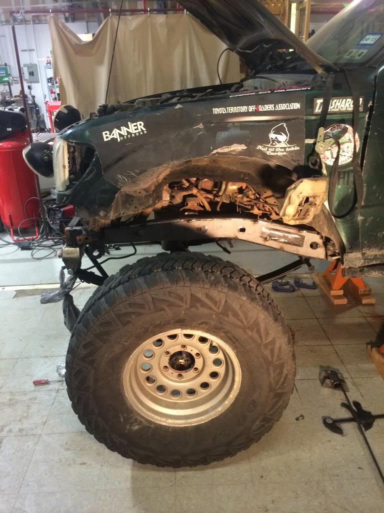

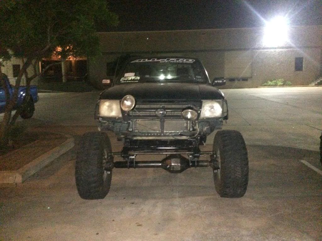

Well today was fun! Got a late start but had a very productive day and got to my goal of getting the axle hung.
$6k in parts.

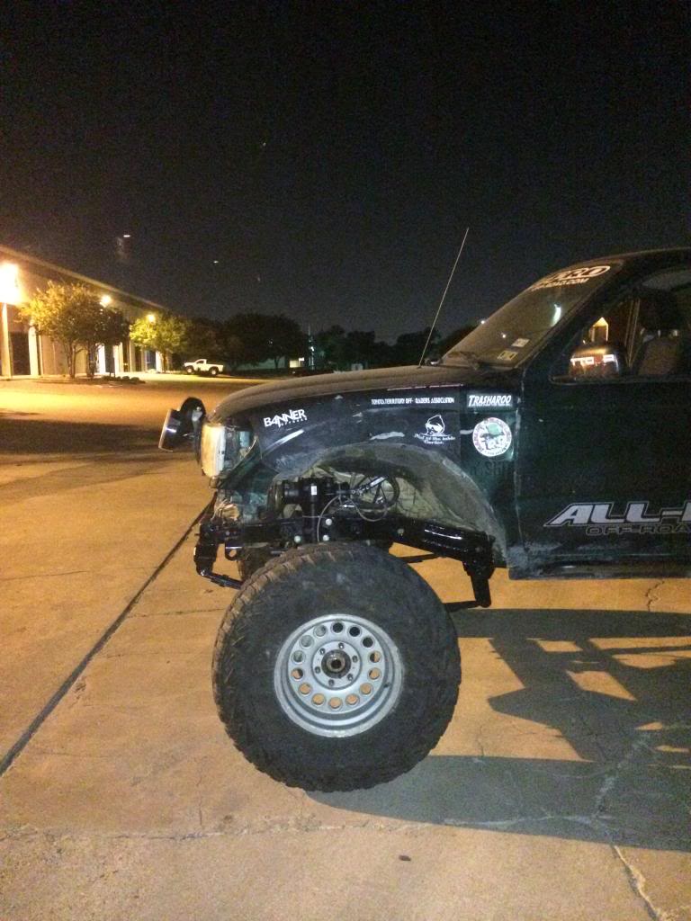

Last shot of the truck on IFS.

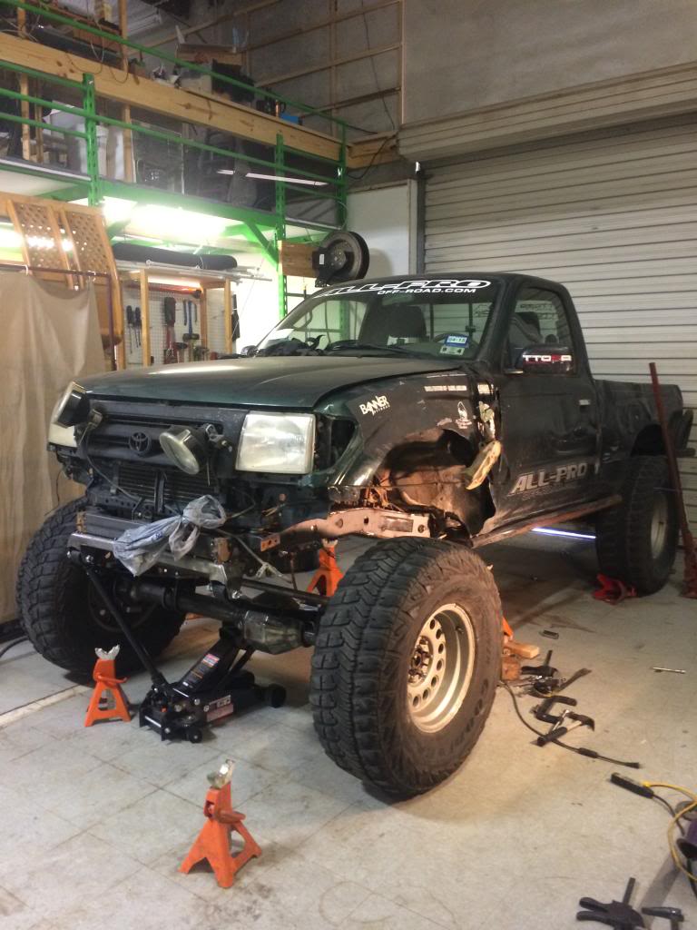

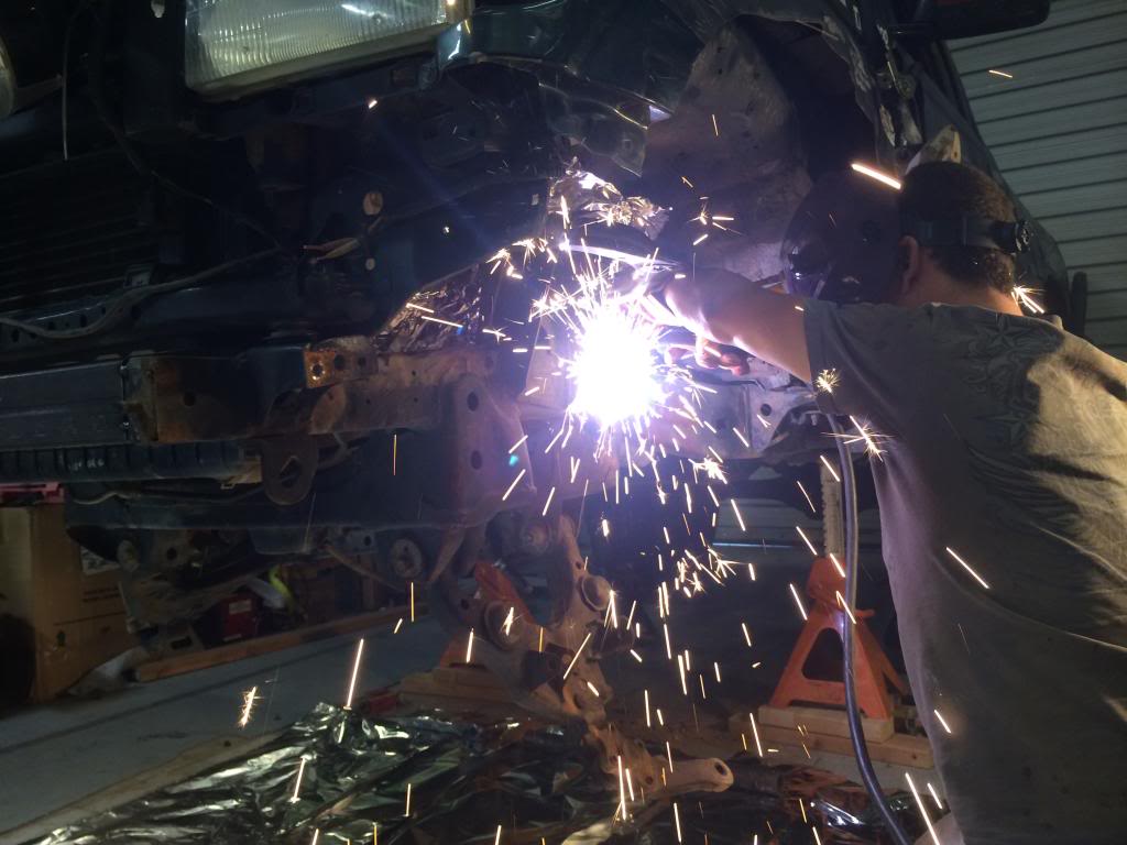

Cutting.
Mockup
The centerline will probably be a little farther back than this.
First thing in the morning I need to swap the oil pan, then get the shackle hangers mounted and test clearances. After that I'll get the steering box swapped in and go from there.

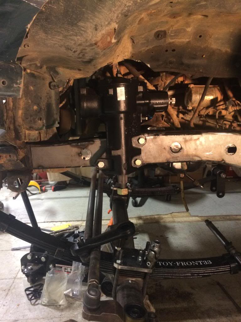

Steering box is mounted, just gotta finish welding the brackets.
Old May 11, 2014 | 08:34 AM
  #72
HighLux's Avatar
Joined: May 2010
Posts: 2,587
From: Ofallon Missouri
Looks stout. So whats left? Steering hook up?

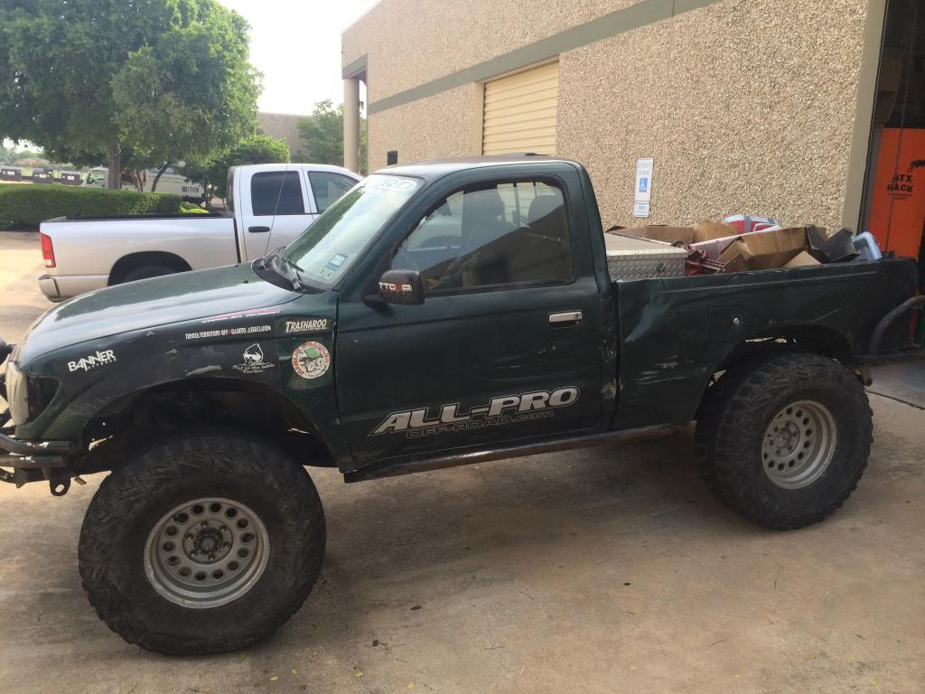

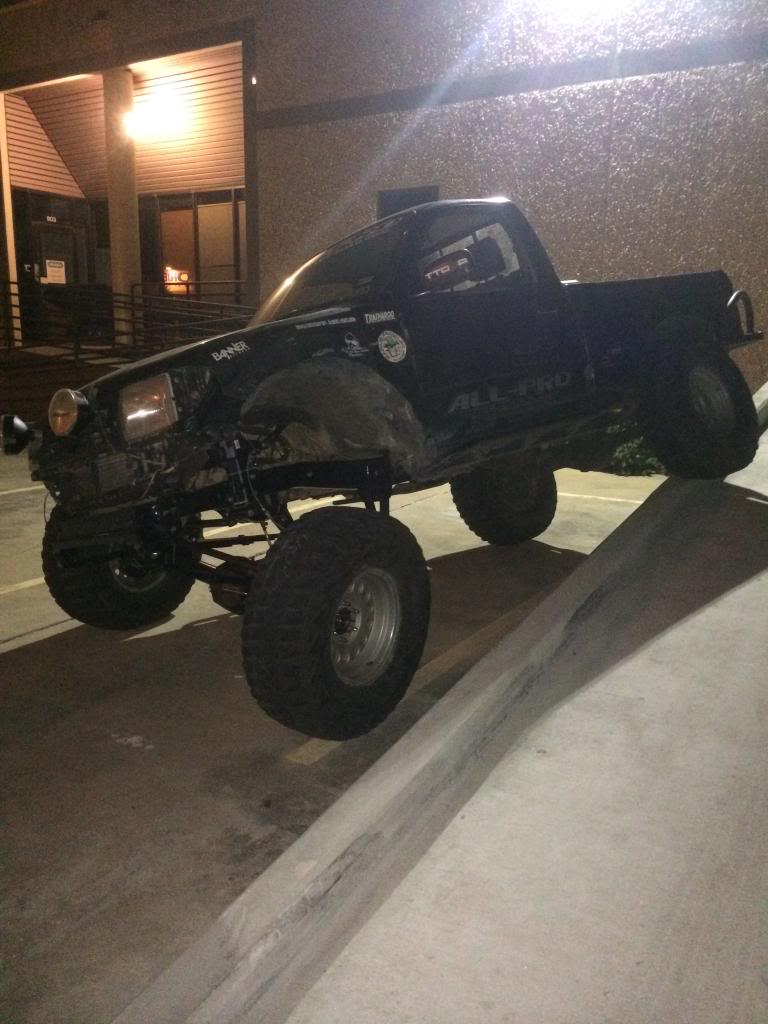

The front is "done." I still need to put the inner shafts/ birfs in, weld the steering stops on, and a couple other small things. I drove it out of the shop and got it up to about 50. I've gotta get the toe set a little better but everything is working pretty well.
I was hoping to get the center of the axle about 3" forward of stock. I measured everything and the axle ended up 7" forward. I've got a 111.5" wheelbase with an 80* approach angle. :O
Working on the rear suspension right now. The truck should be 95% by tomorrow evening.

I got to take the truck home from the shop tonight.
It's slightly bouncy without shocks. Needs a steering stabilizer. Wanders a bit at speeds of 50 and over. Otherwise, everything is great. I need to triple check my toe which I thought I set at 3/16's in. I'll get some pictures tomorrow morning. I did the math and I was at the shop for a grand total of about 50 hours!
