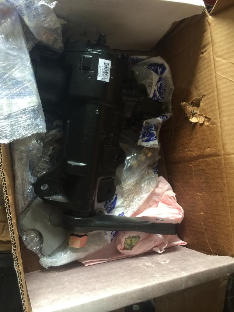

Today I got the steering box, the FROR hanger kit, and the fitting for a high pressure line on the pump. This gear box is HUGE!
Also found out I need to exchange a u-joint for my steering system from summit. (Wish me luck)

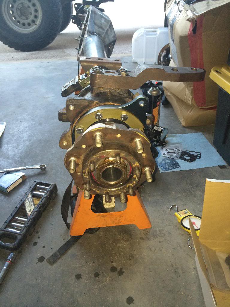

Got the passenger side wheel bearings started.
I think I left it way too loose. Will probably work on it tomorrow or Thursday depending on my work schedule.
