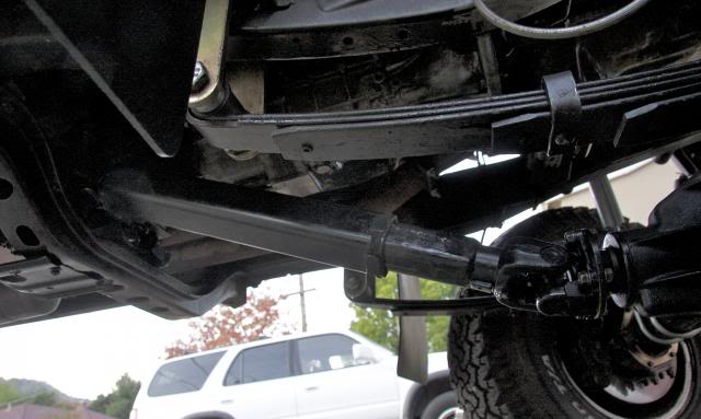

Made one......And due to the pinion angles I omitted the CV. That went on the rear DS.
[IMG][/IMG][IMG][/IMG]
Old Dec 13, 2014 | 05:17 PM
Teuf's Avatar
Posts: 5,592
Likes: 24
From: Dixon, Ca
