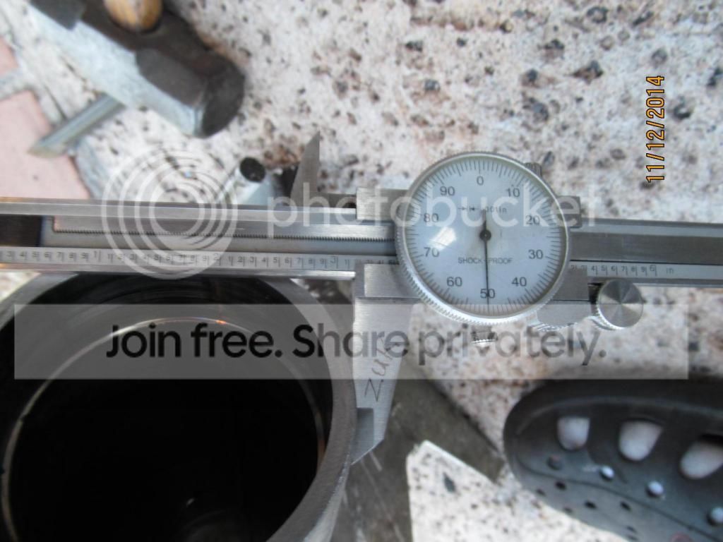

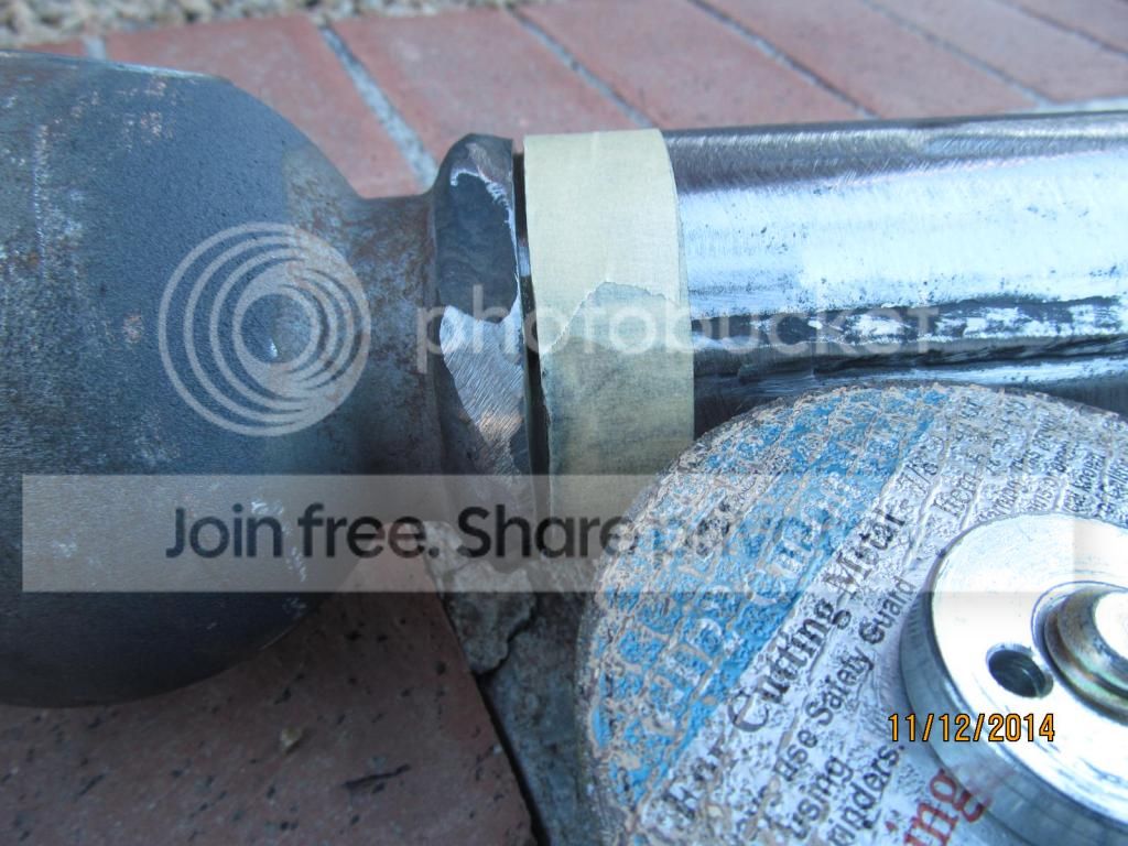

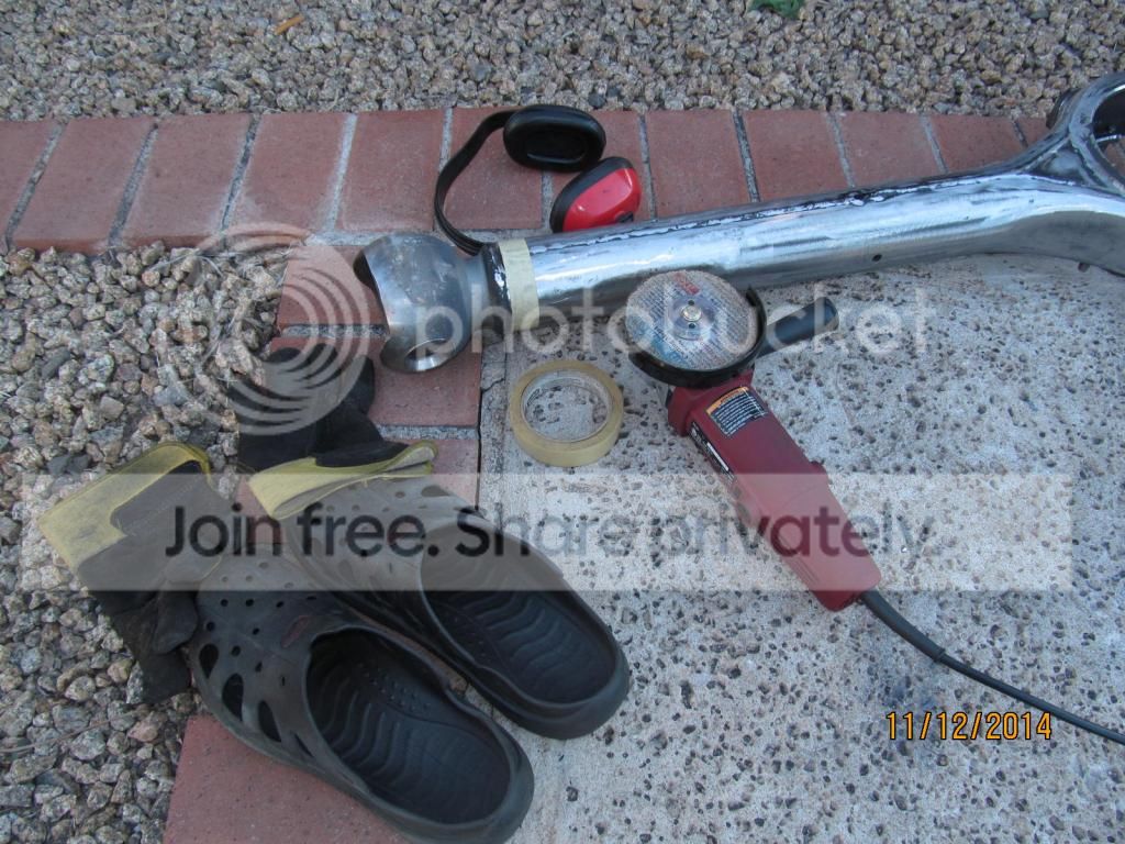

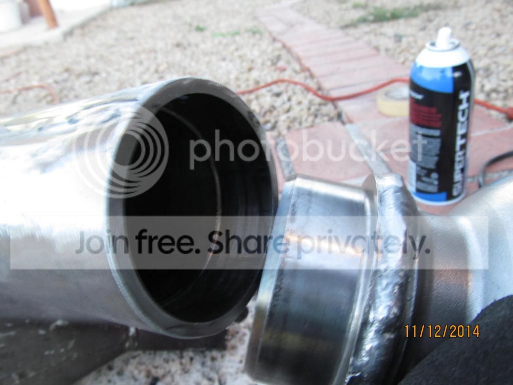

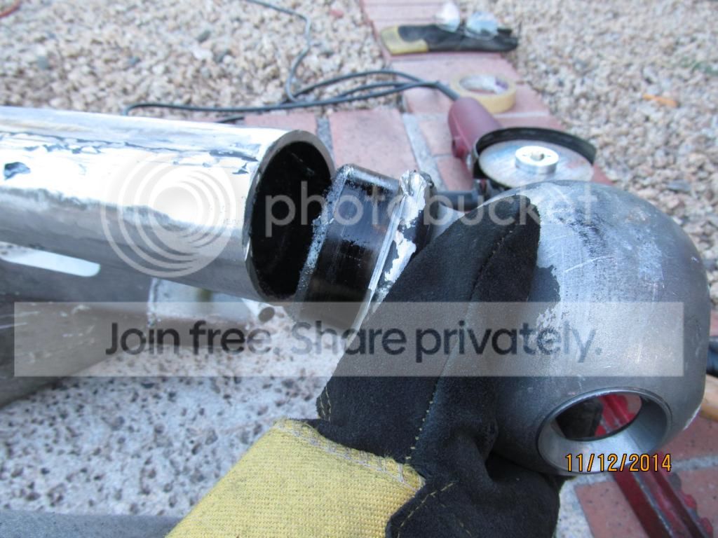

So I picked up on the technique that someone else did......and I cut not on the weld but just
behind it and I think that was a very good idea. I ran masking tape all the way around the
tube keeping it as straight as possible to get a nice straight line. It worked too.

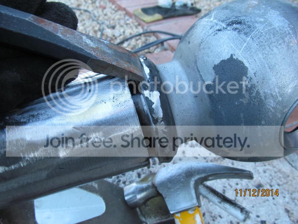

Then I used a 4.5" cutting wheel and cut just about 3/16" into it all the way around. I could
feel the grinder grabbing a bit different when I reached the tube inside.
I used a chisel and hammer and was able to see separation. I'm banging
against the original weld so nothing is being damaged.

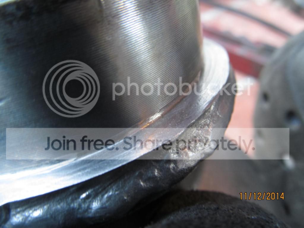

God bless America! Success!
Cleaned it up with the flapper and also a high speed wire wheel.
Hardly a nick.

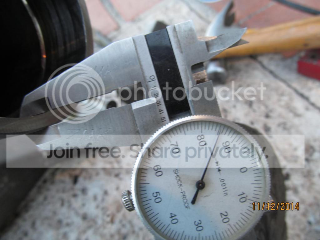

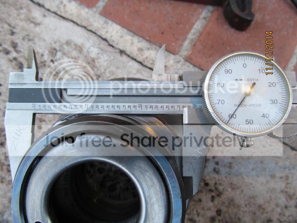

Thickness of the housing is just about 3/16".
Outside diameter is 3.150"
The outer dia of the knuckle insert is close to 2.760" (2 3/4")
