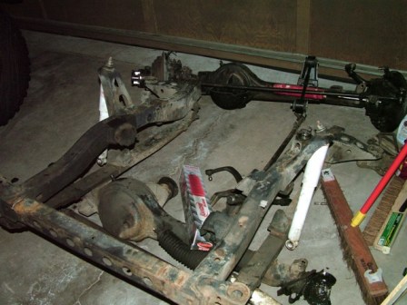

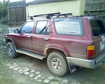

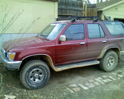

Hey everyone. Been a watcher here for a while and I'm finally ready to start my build. What I want to do is keep it as low as possible while cramming 35"s under it (I think that the lox center of gravity is more beneficial than the center clearance)
i know there will be plenty of fender trimming but I really want to keep this thing low for the stability.
Heres the specs:
'90 4Runner, 3.0 V6, 5 speed
'85 front axle
Got the front axle from vwfastg60 (thanks again) he also gave me a good deal on some crossover steering arms.
What I plan on doing is using the spring hangers and all the mounts off the old '85 frame and welding them on to the frame of the 4runner. Should be the simplest and easiest and I will be able to use stock parts for a 85 front end
Eventually I will be fabbing my own bumpers sliders and skids too.
Stuff I still need to get: (where are the best places to get these? Anyone selling some of these?)
3/4" heim joints for tie rod and drag link(2 RH, 2 LH)(I can get them for $10.50 ea)
5.29 Ring and Pinion gears (I can get them for $125/set)
R & P shims/necessary install stuff (??)
extended Brake lines (~$30 each)
Rear coil spring spacers/lift coil springs (best deal ive found, $80)
35" tires (still looking)
Wheel spacers (best deal I found was $70)
4X2 oil pan from a T100 (I found them online for $100)
Is there anything else that I am forgetting?
Any pointers or advice?
Anyone have any pictures of 4runners or mini trucks with low lift and 35"s? if so i would like to see them.
Thanks alot for your help - I will post up some pics as the build progresses.
-Joe
Attached Thumbnails Newb SAS build and a few Q's-4runner-front.jpg   Newb SAS build and a few Q's-4runner-rear.jpg   Newb SAS build and a few Q's-axle1.jpg

Why are you changing the oil pan?? You should probably get a hanger and jigs/tubes from one of the vendors.

The oil pan will hit the crosover steering links right?
I read that the 4x2 T100 oil pan clears the links better
While I think that the vendors make great products and they are useful to most people, they aren't for me. I looked at a couple different kits but they really weren't worth the money from my perspective. I got the front end of a '85 pickup for free, so why not use the parts (they will only take a couple minutes to cut the mounts off)

If its crossover steering from one of the SAS kit from like trailgear or marlin you need to be lifted 4" min to clear it. Found that out when I called for a price w/o the springs and told them I'd be doing 3".

4" lift is too much - I will modify my oil pan before I'll go that high.

I have had problems with my oil pan hitting the link arms. but i am running old 4" lift springs. i need to get the 5" HD TG springs.
unless you do alot trimming and/or go wiht like 35x10.5 tire you'll need a 4" of lift to clear the tires. and honestly, i wouldnt want to go through ALLL the work of a SAS and not have it stand out. if you only get 2-3" of lift its going to look like your running BJ spacers and a BL unless you know what your looking for. i enjoy the fact that people stare at me when driving down the road a lil kids say to their mom "look at that monster truck" i have had no problems with it being top heavy or unstable, and i drive like a mad man. granted it doesn't do curves like my dads BMW Z4 but then again i can drive over it

My SAS'd '91 has 3.5" to 4" of lift and runs 35" MTR's. Granted these are a small 35" tire and there is some slight rubbing. Has never been a problem on the trail though. I was like you though and wanted 35's with as little lift as possible.
I have All Pro's Hy-Steer crossover with the FJ80 rod ends. The axle is moved forward 1.5". The oil pan has never been a problem but it is very close. The drag link end at the box also comes very close to the tie rod when the wheels are pointed straight and the drivers side tire is stuffed up in the wheel well.
So why am I telling you this? I guess they are just some watch outs. If I was doing it over I would probably move the PS box forward an 1" and the axle another 0.5" to give a little more room for the steering and to get the tires away from the back of the wheel wells.

I will be curious to see how you "re-use" the front spring brackets from the used front end. Most of the SAS kits available sell this as a point to point assembly as the springs sit just outside the frame rails on the newer trucks.
I am sure you are aware of this already, but I'd like to see how you solve the width problem using just the older brackets, so any pics when you get to that point would be sweet.
