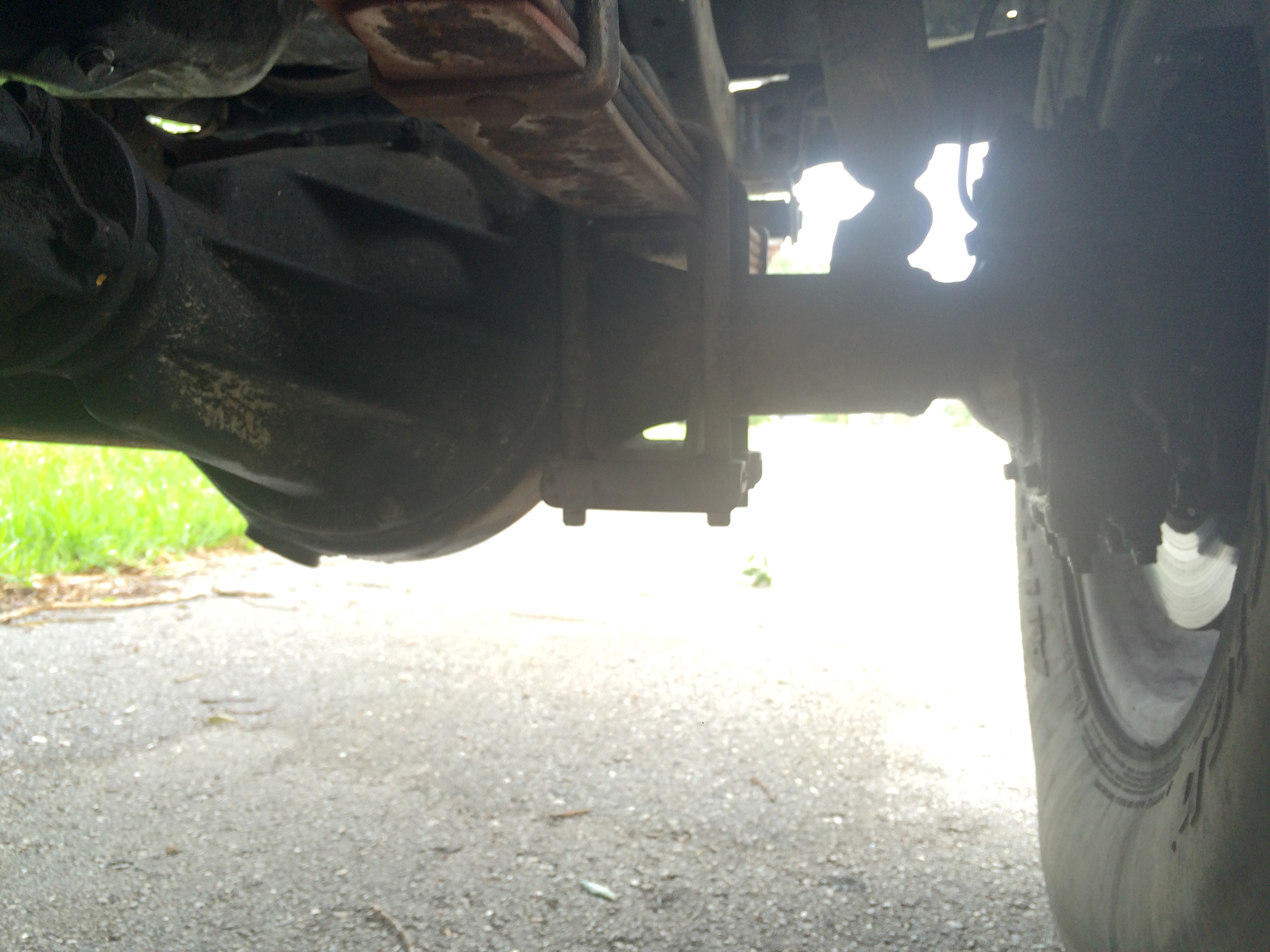

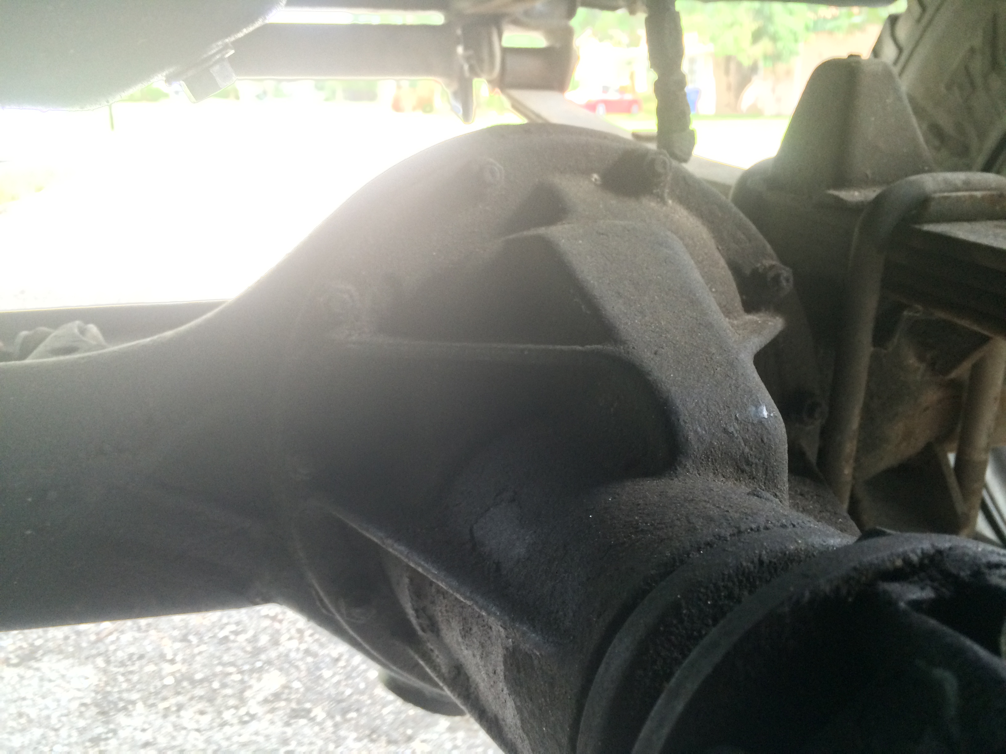

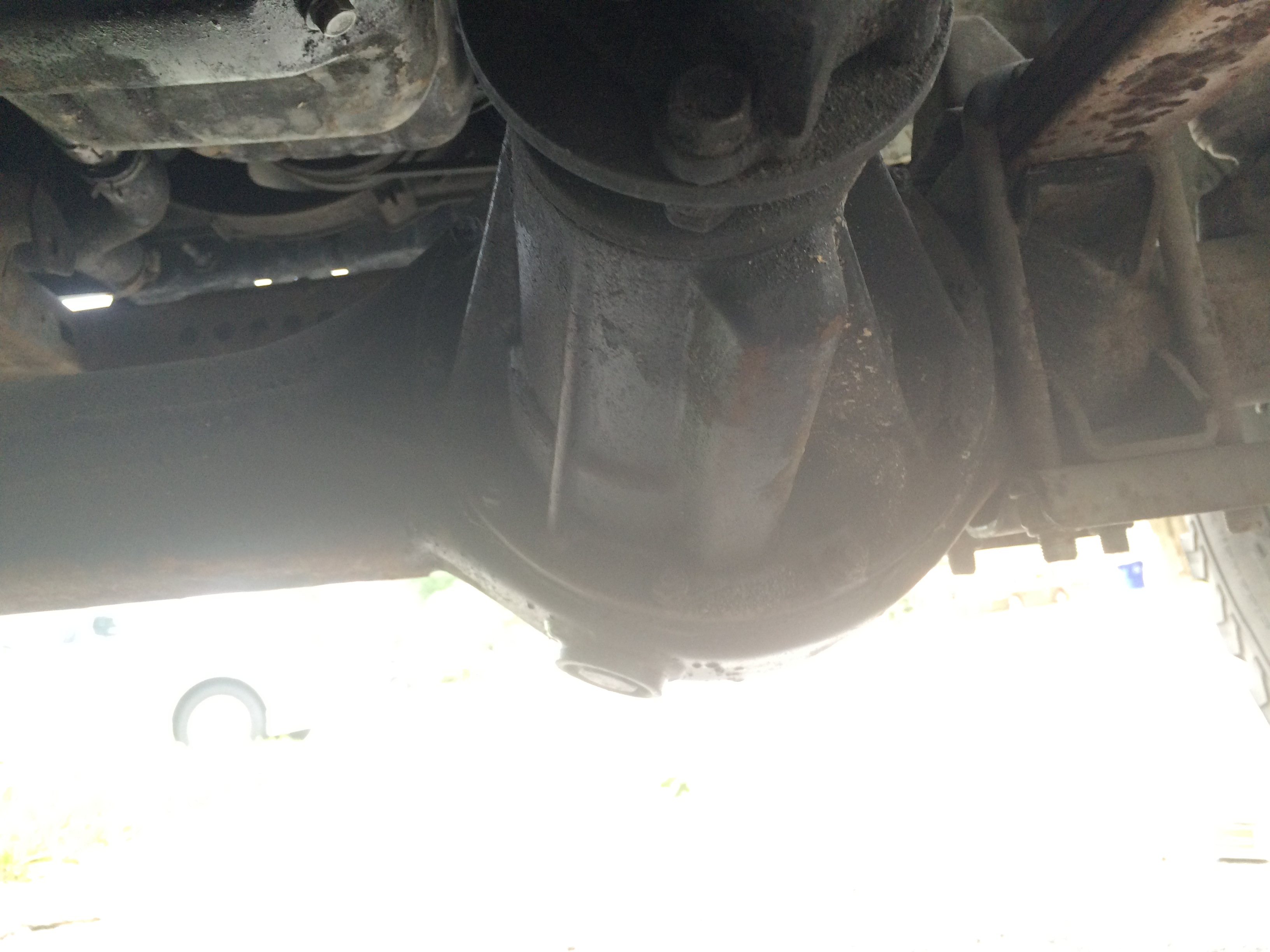

Hello, I have a 92 long bed 4x4 with both the front and rear axles shaped out. I have a seal leaking on the front and need to know what type of axle i have so i can replace the seals. Can anyone tell me what type of axle this is? I can take measurements or other photos if you let me know what to look for. Thanks!

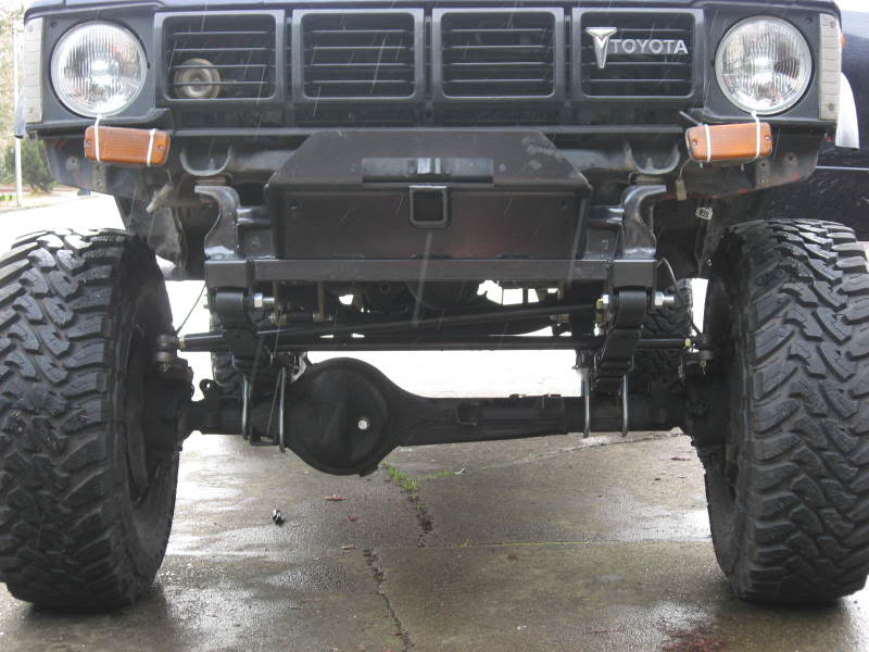

Got a full brace on the bottomside so it's an 84~85 PU axle.

that thing needs TRE's, basically looks like it needs a rebuild in addition to replacing a leaky seal...
Zuk is correct
COLOR="Red"]ID Toyota Mini Truck axles[/COLOR]
79-80 no gusset
Originally Posted by gtr1990
Here is a '79
81-83 short gusset (to u-bolts)
84-85 long gusset (past u-bolts)
Originally Posted by MaXXis85
Here is my 85 bedfore I did anyhting with it.

Shouldn't have to mess with anything that really aligns it.....just start removing the manual hubs and work your way in.
Wheel bearings seem to last forever....just need a cleaning and re-packing of grease usually. Might be a good idea to get a knuckle rebuild kit......and make sure you use the heavy duty Marlin Crawler inner seals....keeps the gear oil inside the inner housing and keeps your knuckle grease from getting to your ring and pinion place.
see this link for parts https://www.marlincrawler.com/axle/front-axle-parts
Looking at your pics looks like you could use new brake rotors at least.
