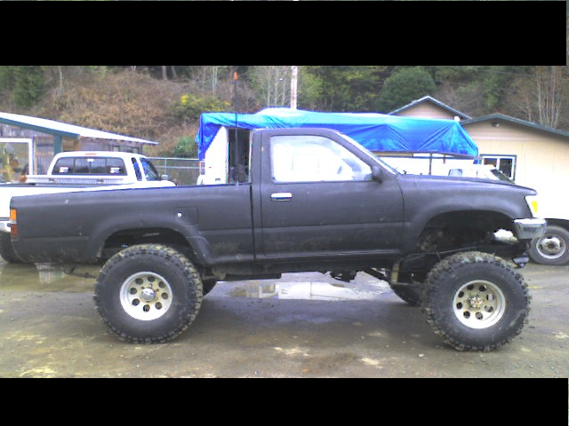

hello, im a lil confused.
everyone else that has sas'ed
there truck used matching springs front and rear.
6" in the front and 6" in the back etc. well i put 79-85 3.5" e-z ride front springs in the front. does it look like 3.5" springs in the back will b enough lift?
any ideas?
Old Feb 25, 2008 | 02:32 PM
sh0kk86's Avatar
Joined: Mar 2007
Posts: 680
From: Phoenix, Arizona
its because you used a drop hanger, and your front axle is moved forward some requiring less lift. possibly use a 4" leaf sprign in rear, with longer shackles if needed.
shouldve done the measurements and research before you started man.
Old Feb 25, 2008 | 03:50 PM
TOYOTA 1's Avatar
Joined: Feb 2008
Posts: 2,799
From: oregon
i have done research, as for the drop hanger everybody who sas's uses one and they use same highth springs front to back! so y am i any different?

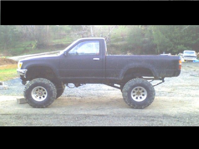

ok so here is my truck sas'ed with 3.5" springs up front. 5" springs in the back
im almost happy with the way it sits. just gonna get new shackels for the back 1" or so longer "than stock" and it will sit about perfect!
i still dont understand why i had to use bigger springs in the back?
but no worrys.
Old Mar 5, 2008 | 01:30 AM
YeloSub7's Avatar
Joined: Mar 2005
Posts: 1,010
From: San Jose, CA
because the front spring hanger for the front axle adds about 1in
Old Mar 5, 2008 | 09:57 AM
TOYOTA 1's Avatar
Joined: Feb 2008
Posts: 2,799
From: oregon
ahh, ok ill remember that next time i sas a yota.
