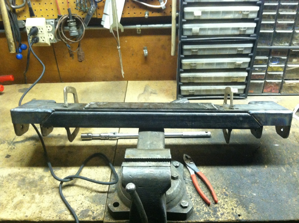

I'm not sure yet, but these guys sometimes will discount their rate a little if you have cash in hand. Small shop, but they do awesome work. Mine also will be a little more work, as I'm replacing the front crossmember with a reinforced Sky hanger. My crossmember is bent, and as I'm sure most realize, it's pretty flimsy. So that may affect the shop costs some.
This is what's going to replace my front crossmember
